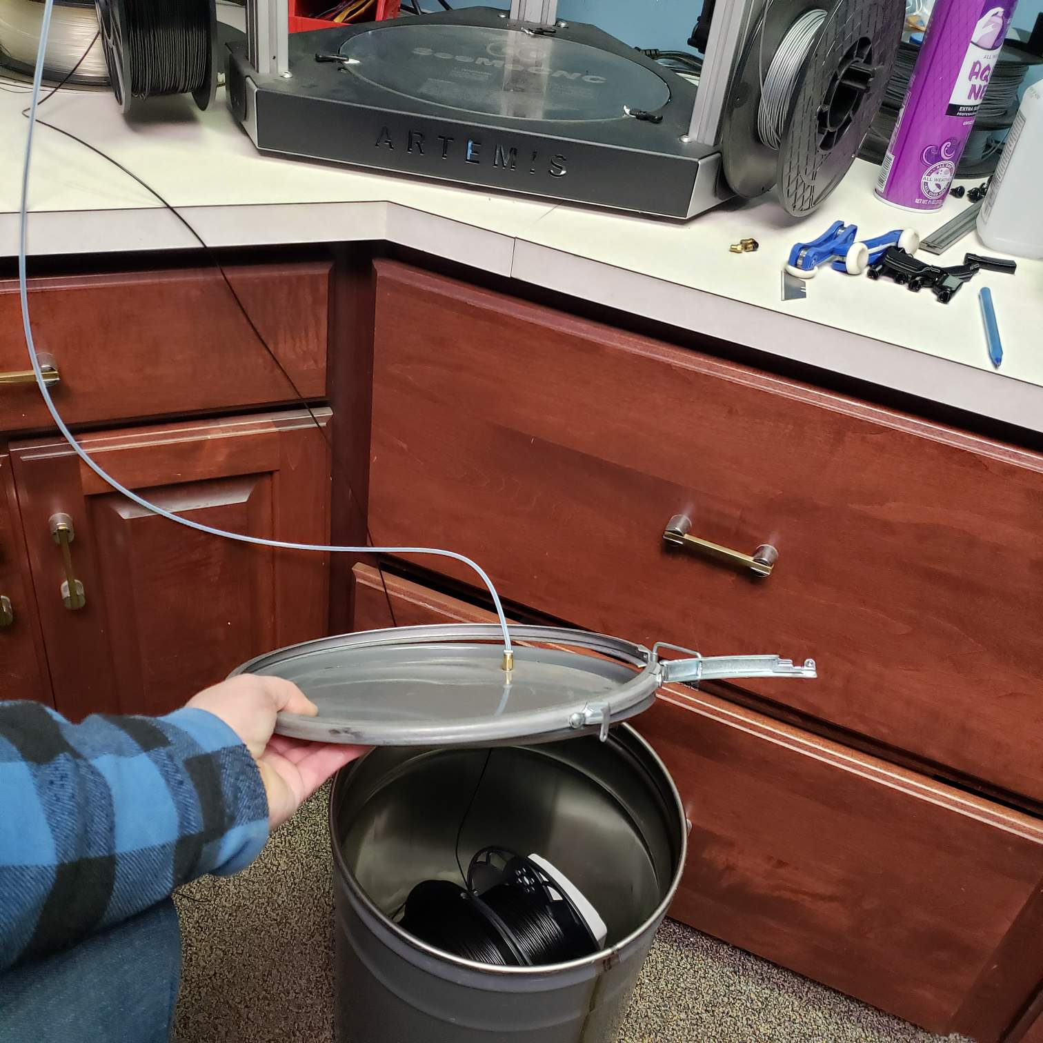

Re: In line filament dryer.
What are you printing with where drying is such an immediate concern?
PartDaddy
Posts: 392
Post by PartDaddy »

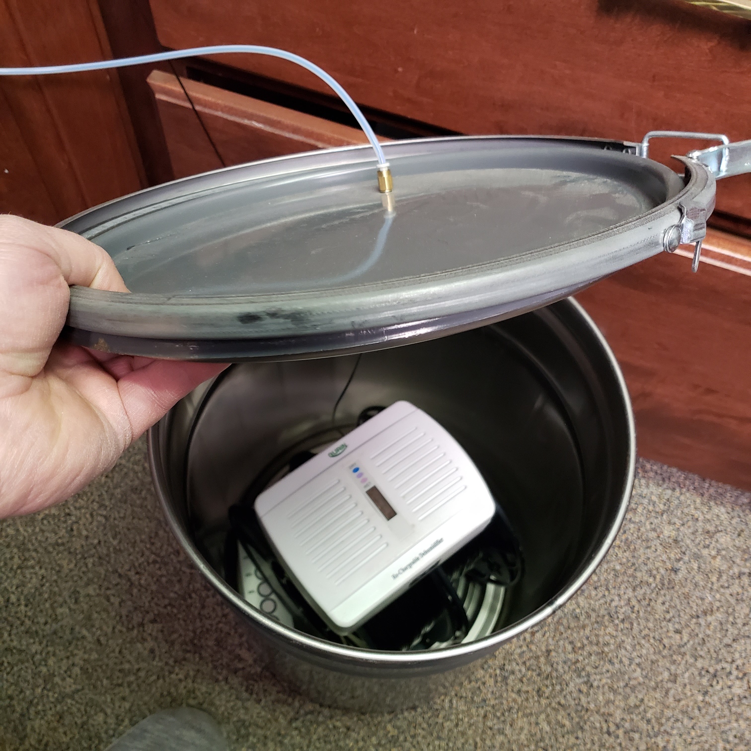

Nylons and even Carbon Fiber PETG benefit. Here's my setup, bucket was curtesy of Atomic Filament.
  • metal bucket with 4mm PTC fitting (SeeMeCNC Part No. 38832)
  • moisture strip from one of my Atomic CF PETG rolls in bottom, these are reusable
  • desiccant dryer, rechargeable type does not need plugged in all the time (like tractorsupply.com SKU No. 104390999)
  • SeeMeRollin Spool Rollers (SeeMeCNC Part No. 27599)
~PartDaddy
SeeMeCNC Owner & Founder
