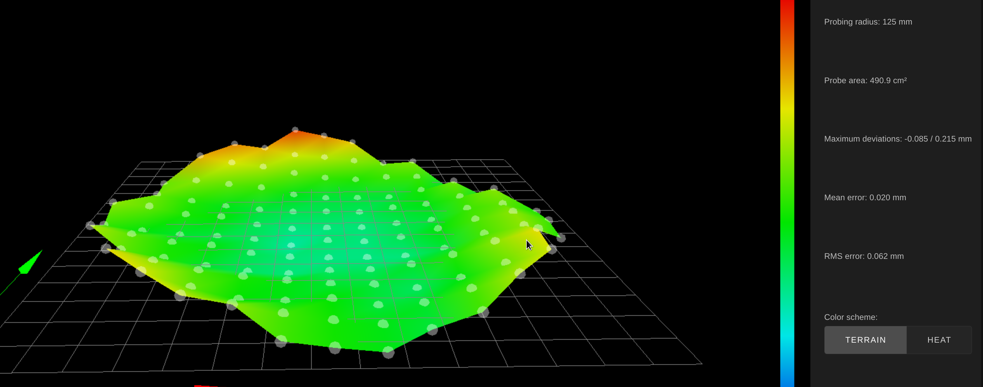

First question is on belt tension again as I've had this problem with my V2 build, now its been upgraded to a V3.frankenstien. I had to have the belts extremely tight to solve it. I had actually cracked a skate at the belt clip. Should I be able to get enough tension by twisting the motor with a thumb and forefinger?
The problem I'm having is peaks and valleys in the bed map. It's actually worse than it's was before. viewtopic.php?f=37&t=12768 sadly all the pictures have timed out. Here is my bed map now. Manual says tight enough they don't slip, I'm passed that to get this good of results.
One other concern is how tight the CF arms are on the metal balls. I might swap the plastic ones back in to see if that is adding to much of a bind.
I kinda hate to call this backlash because it's not that simple, it's related to the last direction moved. Here is a macro I have to test for it a each tower. If someone doesn't mind run this and post the results. This is a duet with a smart effector.

Here is my results now,

Cory
Boring details. This was a v2 with a duet. It's now a V3 frame, ac heated bed, .9deg steppers, metal ball joint, CF arms, smart effector, maker713 effector mount, 24V power supply.

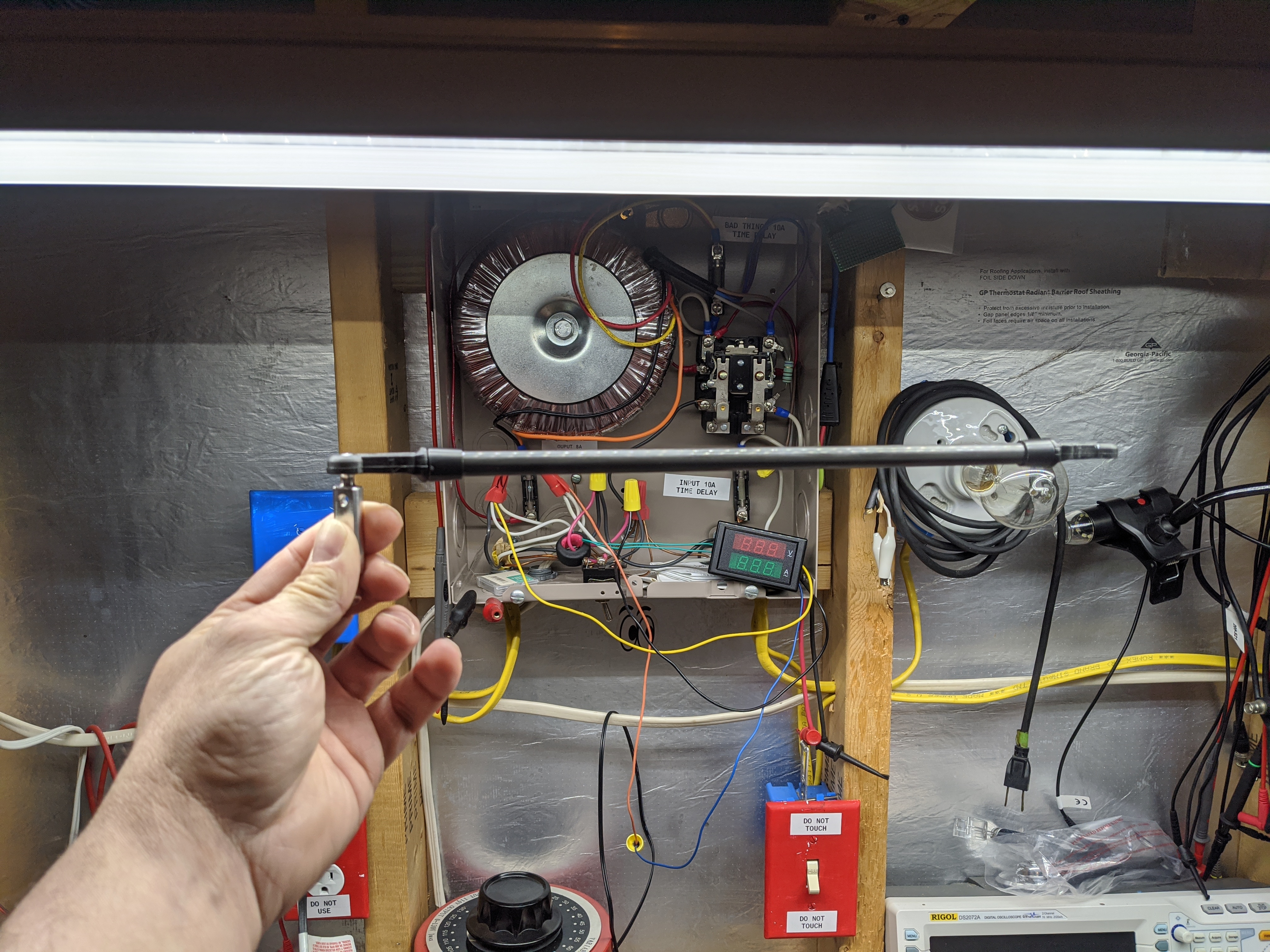

So this morning started looking for the right arm. Not the arm, it's a couple of the aluminum ball ends. Funny thing is that I can't find any bad spots in it, and calipers don't show it being more the .001" bigger than the others. But this one is really tight compared to the others
Re: Backlash issue, again. Was peaks and valleys in bed map
I'd contact support and see if they'll send you a replacement. Link to that photo above.

geneb wrote: ↑Mon May 11, 2020 8:36 am I'd contact support and see if they'll send you a replacement. Link to that photo above.
They are sending replacements. Asked about that grease they send with them. $199 for 1.75lbs.
