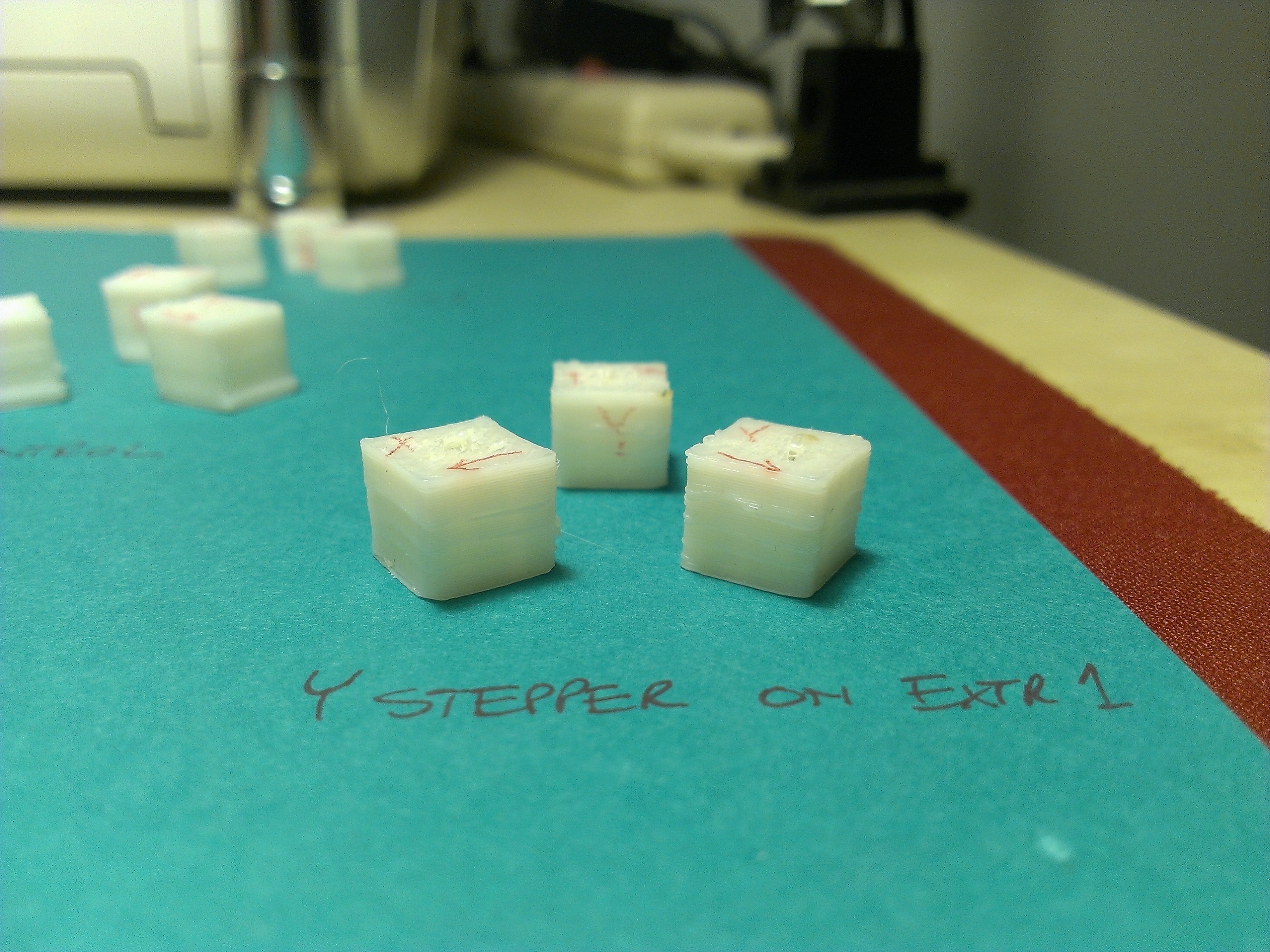

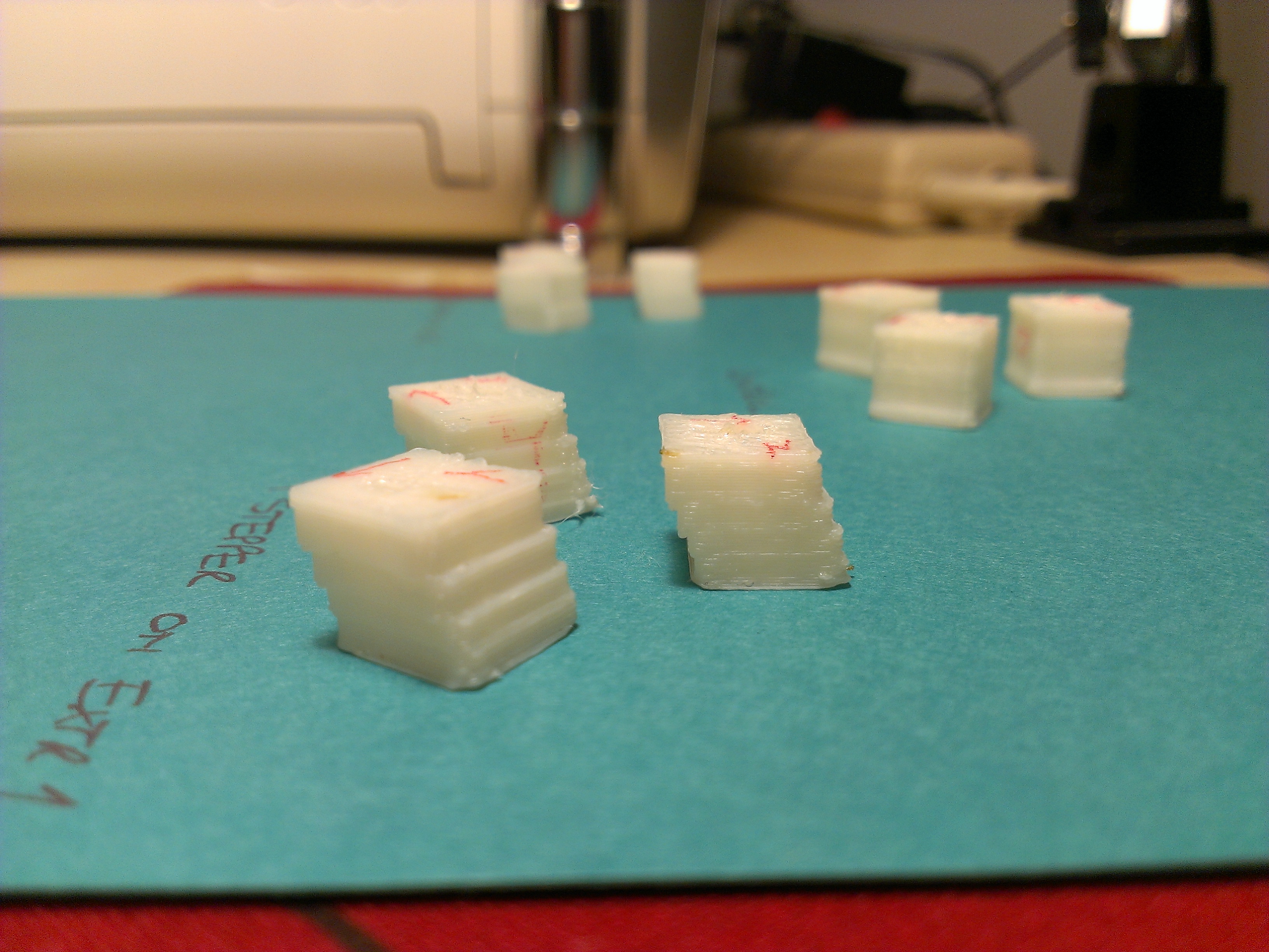

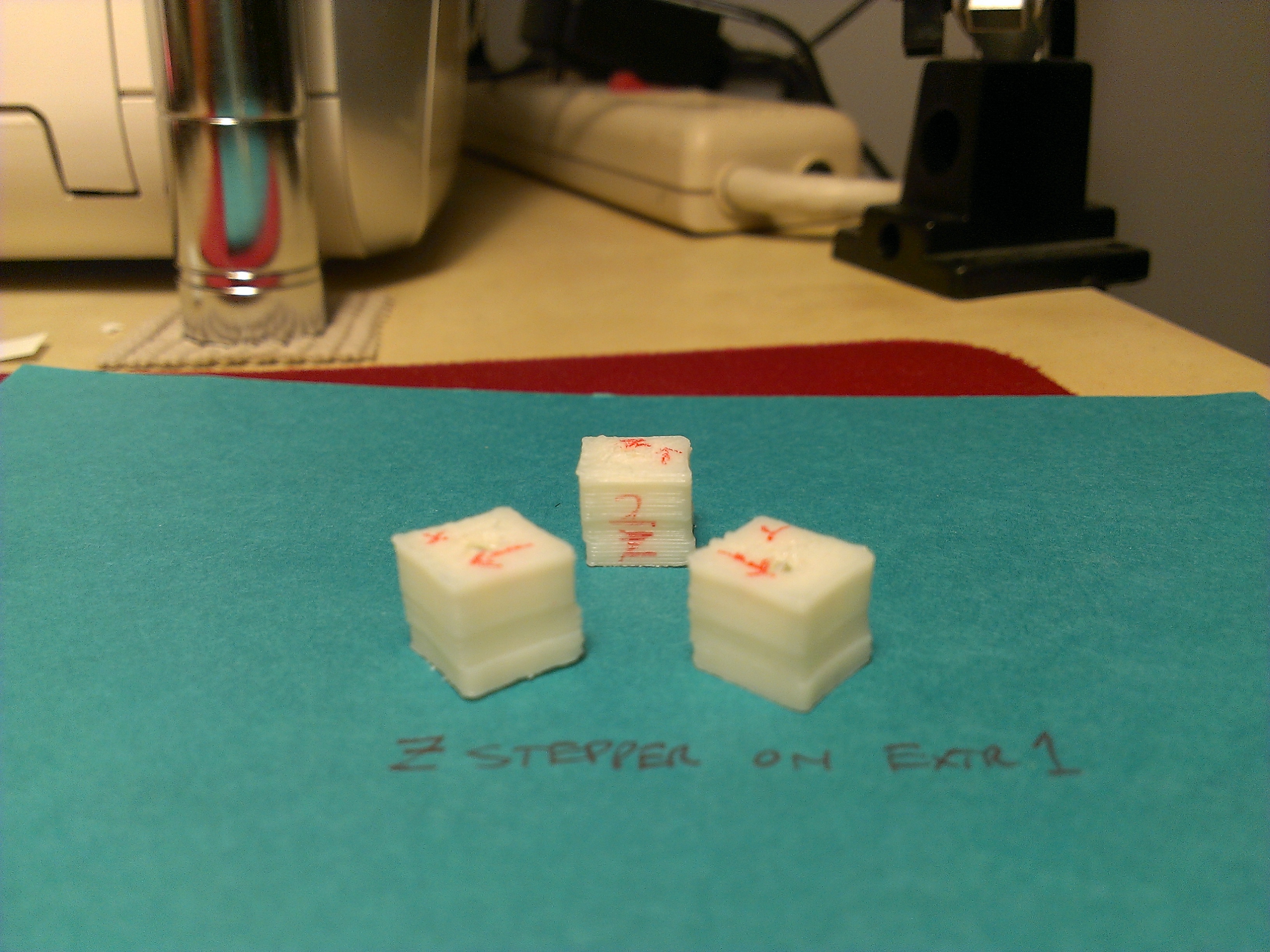

So here's the results of the pin swap extravaganza. In openscad, I created another test pattern so I could better see differences between each change. It's just three 10mm cubes arranged in an equilateral triangle, with faces facing each tower. The center group is the control group. Each stepper motor on it's default driver. Lower left is X motor on extruder1 pins,
lower right, Y motor on extruder 1 pins, and top group is Z motor on extruder 1 pins.
This is the control group.
This is the Z motor swapped onto the Extruder1 port. Looks pretty much the same as Control.
This is the Y motor swapped onto the Extruder1 Port. Obvious lean away from Z tower.
This is the X motor swapped onto the Extruder1 Port. General waviness.
So how does one interpret these results? I'm not too sure. Seems like since the Z motor swap didn't change a whole lot, the Z motor driver isn't the culprit. But since changing both X and Y messed it up even more compared to Control, I'm not sure where that leaves me.
