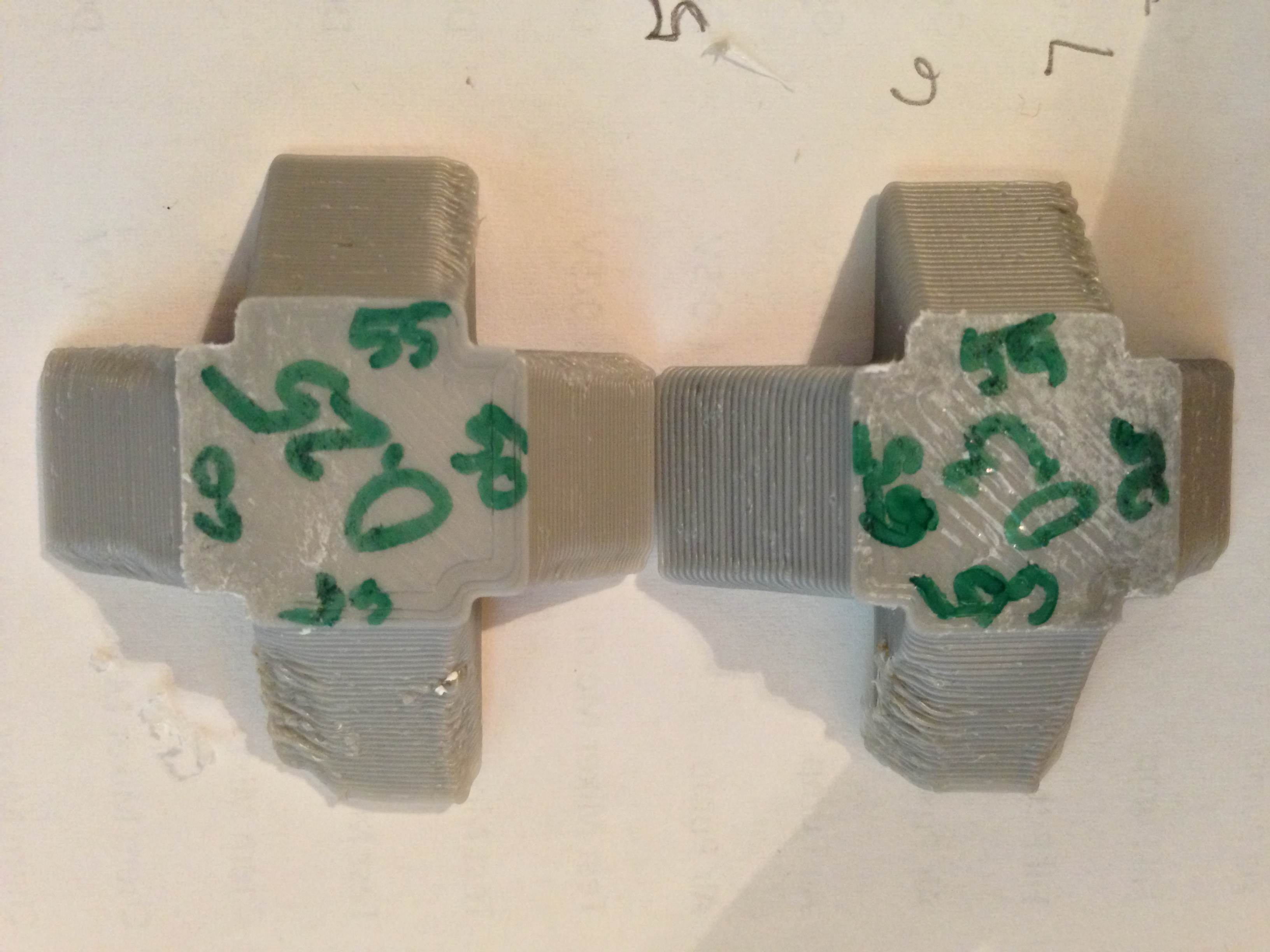

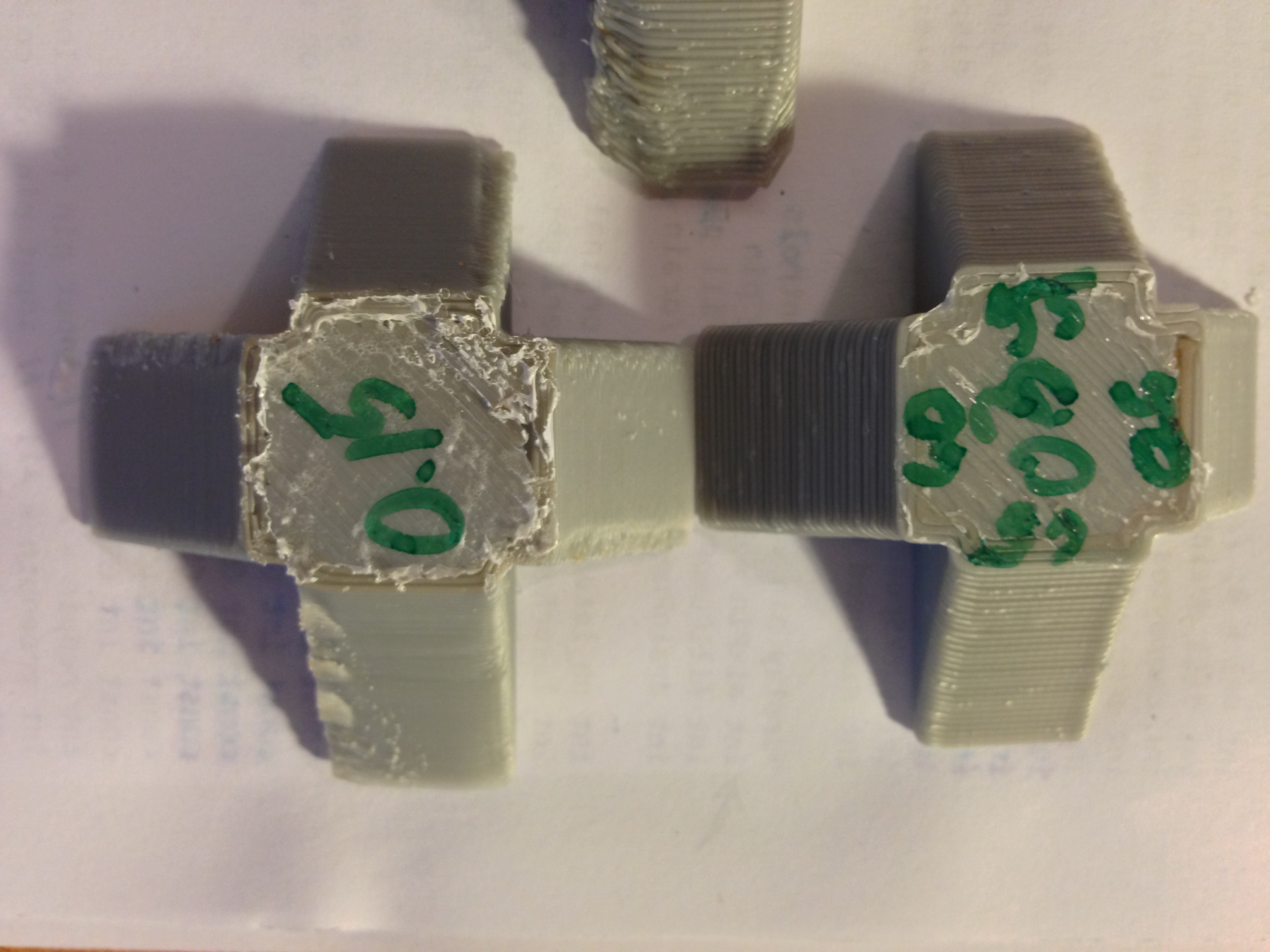

So I have noticed a new issue and it has been kicking my tail for the past few days. I am unable to successfully print over hangs. This issue gets worse as I lower the layer height.
Here is a result from what I have been testing. I quickly drafted this parts with different angles on each side.
the angles are 50/55/60/65. I know these are steep but i feel the max should handle this.
I have search online for a solution but they are all over the map.
Any suggestions for improvement?
By the way, the prints are pictured upside down...
Curling on Overhangs
Re: Curling on Overhangs
There are a couple of reasons why it happens.
The first. Is the filament is stretched as it leaves the nozzles and contracts as it cools, so steeper overhangs will tend to do this.
The second is filament not getting a chance to cool before the Hotend deposits another layer, and the hot end tends to pull it towards the interior.
The short version is you can get some relief with increasing the extrusion width, which decreases the amount of filament stretch. But getting as much cooling as you can directly on the areas that show it most is by far the best solution though.

Well, I'm a big fan of fans...
The two centered in the frame are printed with fans with a 0.5 nozzle. The one cutoff was printed without fans at 0.3 LH.-
