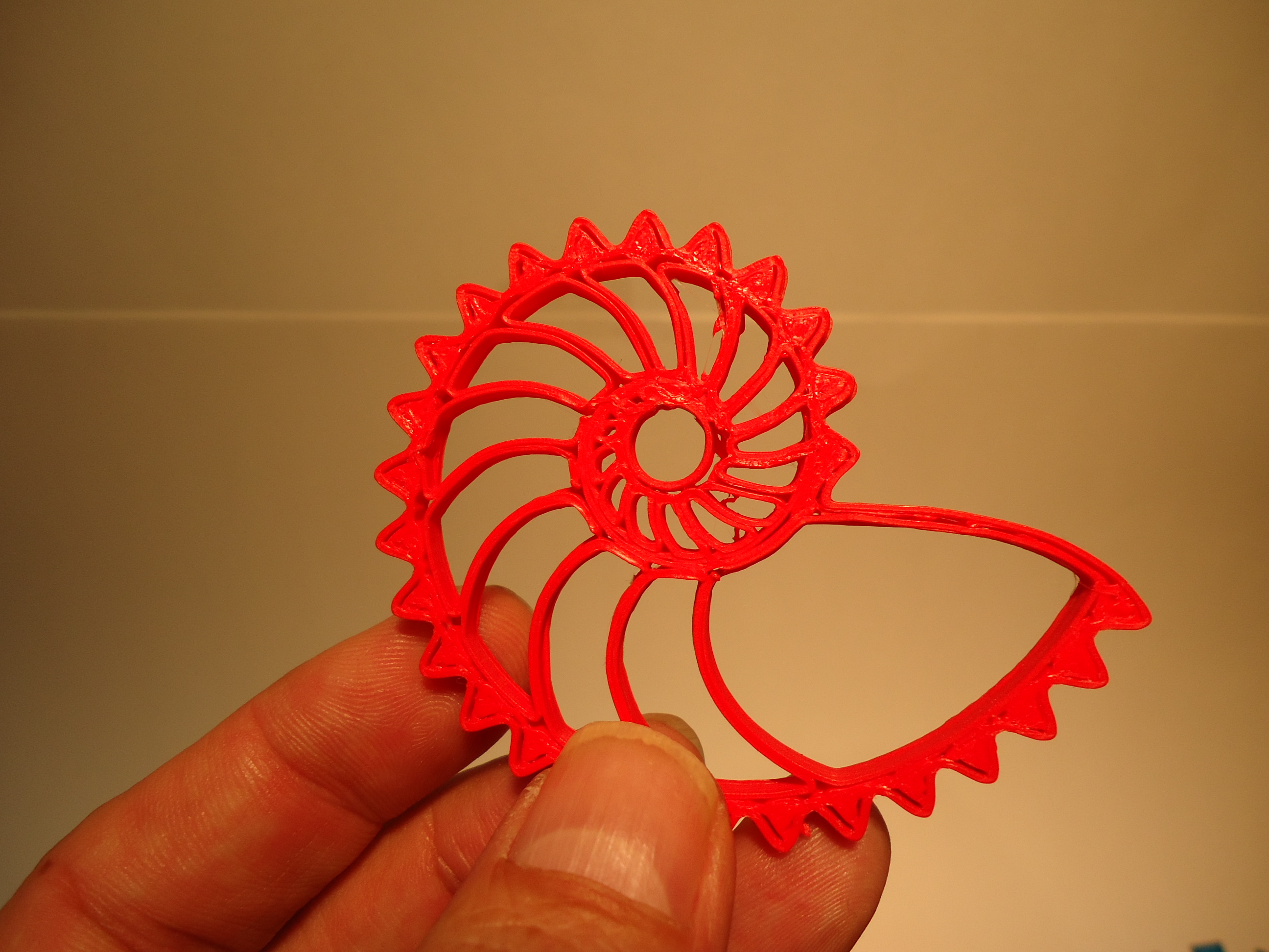

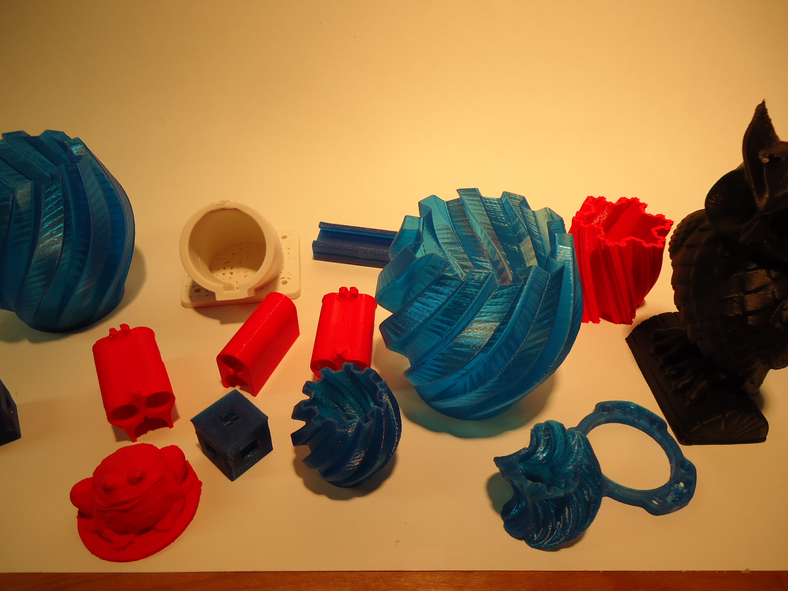

Here is some of my prints scince I have had my machine running, Some of them are with the .7 nozzle before I found out it was supposed to be a .5
Any tips are more than welcome. I want to learn......
