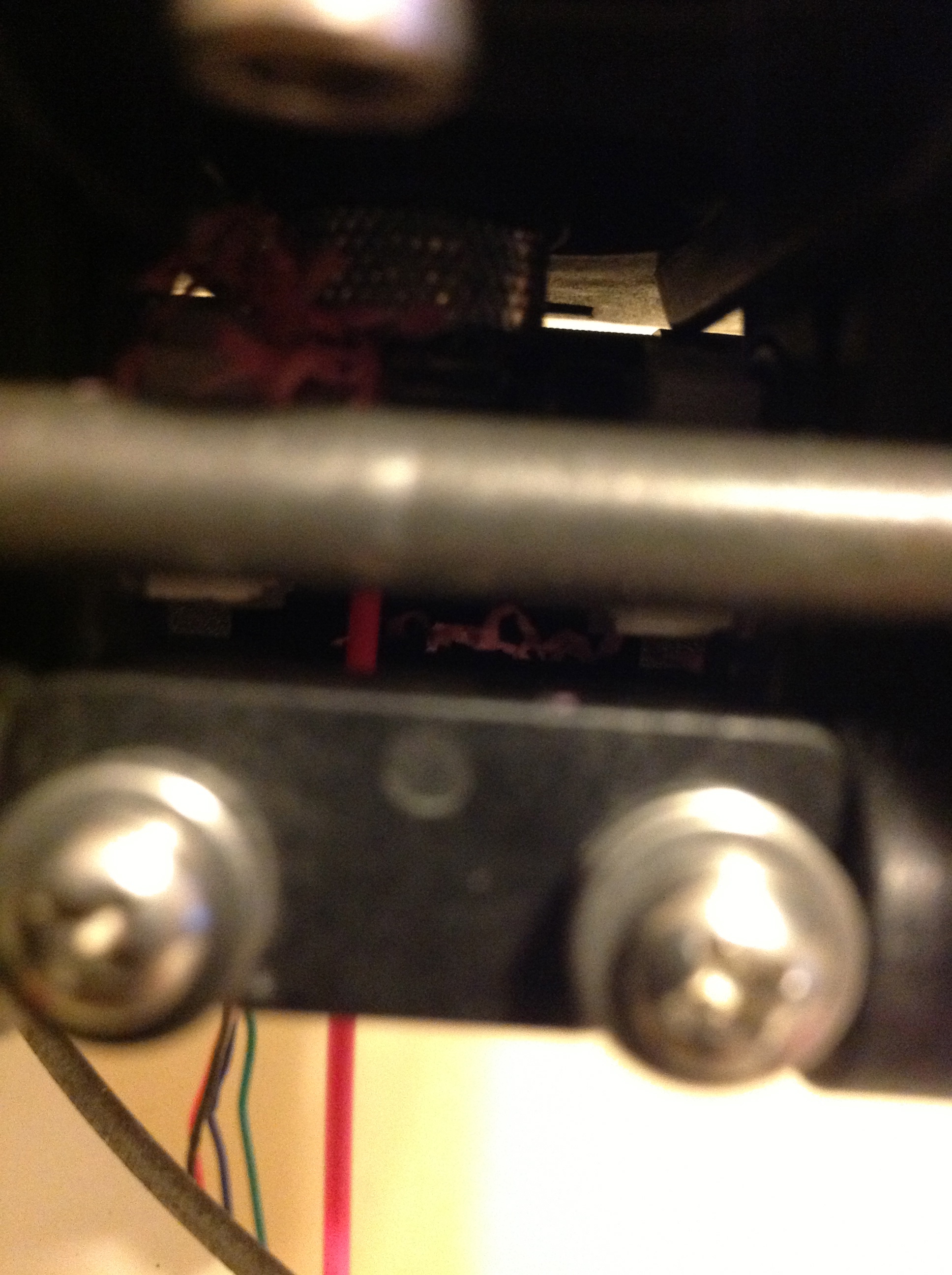

I was starting to print something and started noticing that the filament coming out of the nozzle had deformations, like it was sausage links. I checked the bowden drive and found that there were a lot of "shavings" inside like the filament was getting chewed up by the roller. I figured that the "bites" in the filament were what was causing the sausage links. I decided to change filament just to see if it had anything to do with the plastic. I loaded some different filament and it seemed to be fine while i was loading it and manually extruded quite a bit that seemed to be ok.
Once I started running a job the same thing started happening with the new filament and I found a bunch of shavings. I've tried loosening the tension bolts all the way to where it doesn't feed at, but it still keeps chewing it up as soon as I get enough tension. I've taken the bottom piece out several times and put it back in thinking that perhaps the filament isn't in the groove. I finally noticed that the groove isn't directly below where the tube is and it makes a little bend as it enters the tube to the extruder. I assume it has to be that way as the tube entrance is between the two grooves. Anyone else ever see this? How did you fix it?
The second issue I ran into was when I started printing a job when the filament seemed to be feeding "ok". I was watching it print and wondering why it started looking like crap all of the sudden when I noticed that the nozzle had moved to the side. Looks like I melted the hot end? I was running the hot end at 240 (printing ABS). Any chance I can fix this without needing a new one? It's still to hot to touch, but I'm wondering if I should even waste my time.

I think I know what your problem is with this. I noticed the same thing when I installed mine. There are tiny little guide bumps on the mounting bracket for the extruder. It is designed to be able to mount to one side or the other depending on if you are using 3mm or 1.75mm. I highly suspect that you have your extruder mounted on the wrong side of the little guide bumps. I would take a picture of mine and show you but i'm not near it just now. The tube entrance should not be between the two grooves. when properly installed it should be directly over the correct size groove.

mechneering wrote: I think I know what your problem is with this. I noticed the same thing when I installed mine. There are tiny little guide bumps on the mounting bracket for the extruder. It is designed to be able to mount to one side or the other depending on if you are using 3mm or 1.75mm. I highly suspect that you have your extruder mounted on the wrong side of the little guide bumps. I would take a picture of mine and show you but i'm not near it just now. The tube entrance should not be between the two grooves. when properly installed it should be directly over the correct size groove.
Kyle
Thank you!!
I've attached a couple of images in case anyone else runs into this. It was pretty easy to do ;) I must have done it when I was doing some adjustments and had taken the bowden drive off.
The wrong way..
Fixed.

Got my hot end rebuilt today :) I was concerned that the ptfe insulator was going to be screwed up since I didn't have the measurements that the tubing was cut to. Pretty happy I got that right, got some good use out of the calipers depth gauge. Got everything back together and made one of the better prints I've made yet. My thermocouple won't be here for a couple of days so I'm playing it pretty safe with the temps until I can verify the readings. I did notice during my rebuild that it appeared that one of the leads on the thermistor had broken, probably the root of my problem right there. I was a LOT more careful putting everything together this time, and wrapped everything up a little neater in kapton tape.
Also got my filament drive issues fixed too. So I think with a little tweaking I might actually be read to print something other than calibration prints. Thanks everyone for all the help!
