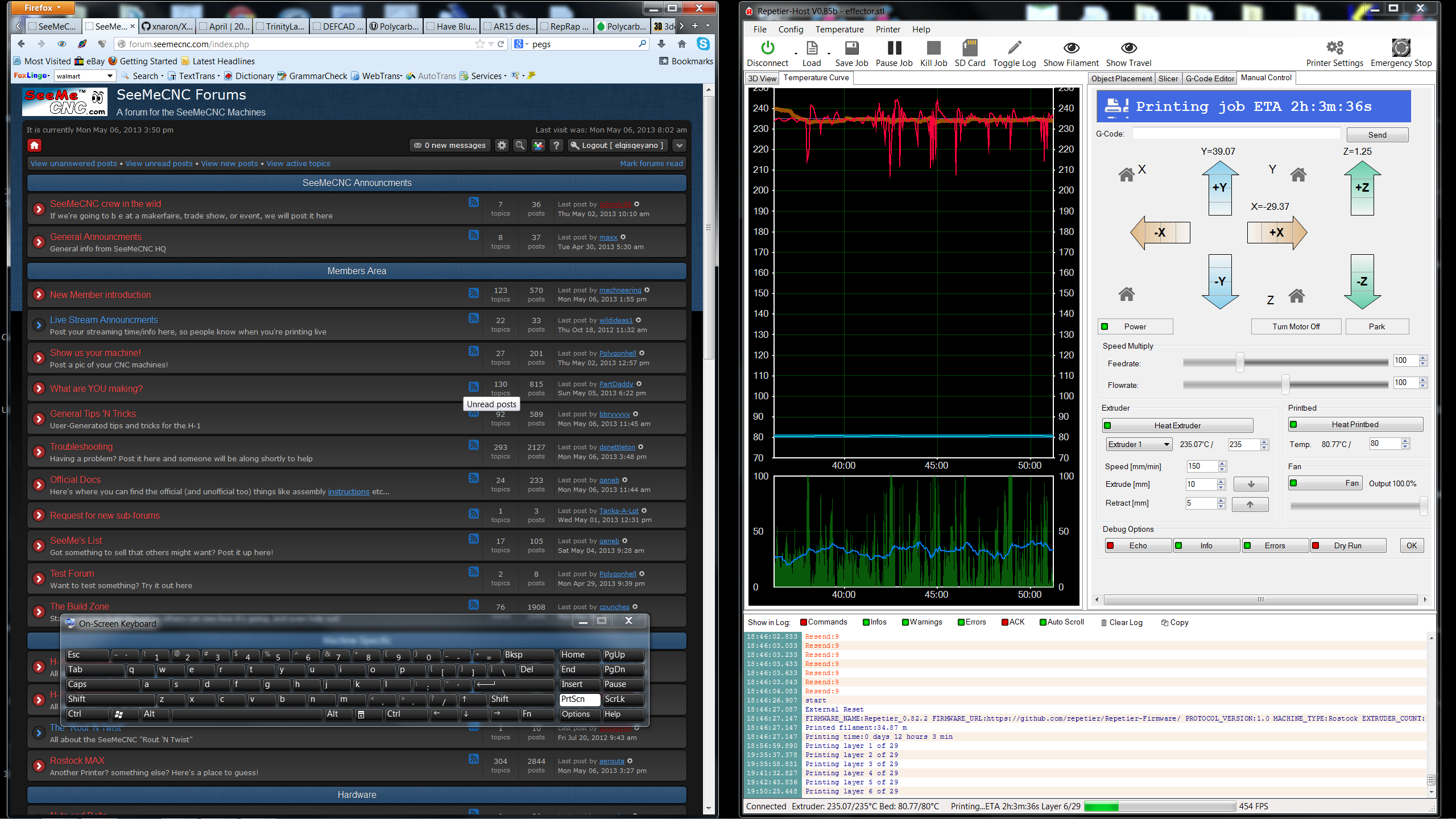

I've several PID tune ups on the hot end, It normally worked really well. Now it's temperature curve is so erratic, maintains a constant 240 C but can change, erratically, as low as 190 the as high at 260 then back to 240. It does this on a constant basis. To the point where it got so cool it caused a clog.
elqisqeyano
Posts: 256
Re: Temperature Curve is so erratic. What would cause that?
Post by elqisqeyano »
Here is a pic of my Temp Curve. Can someone please tell me what might be the cause?

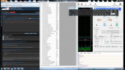

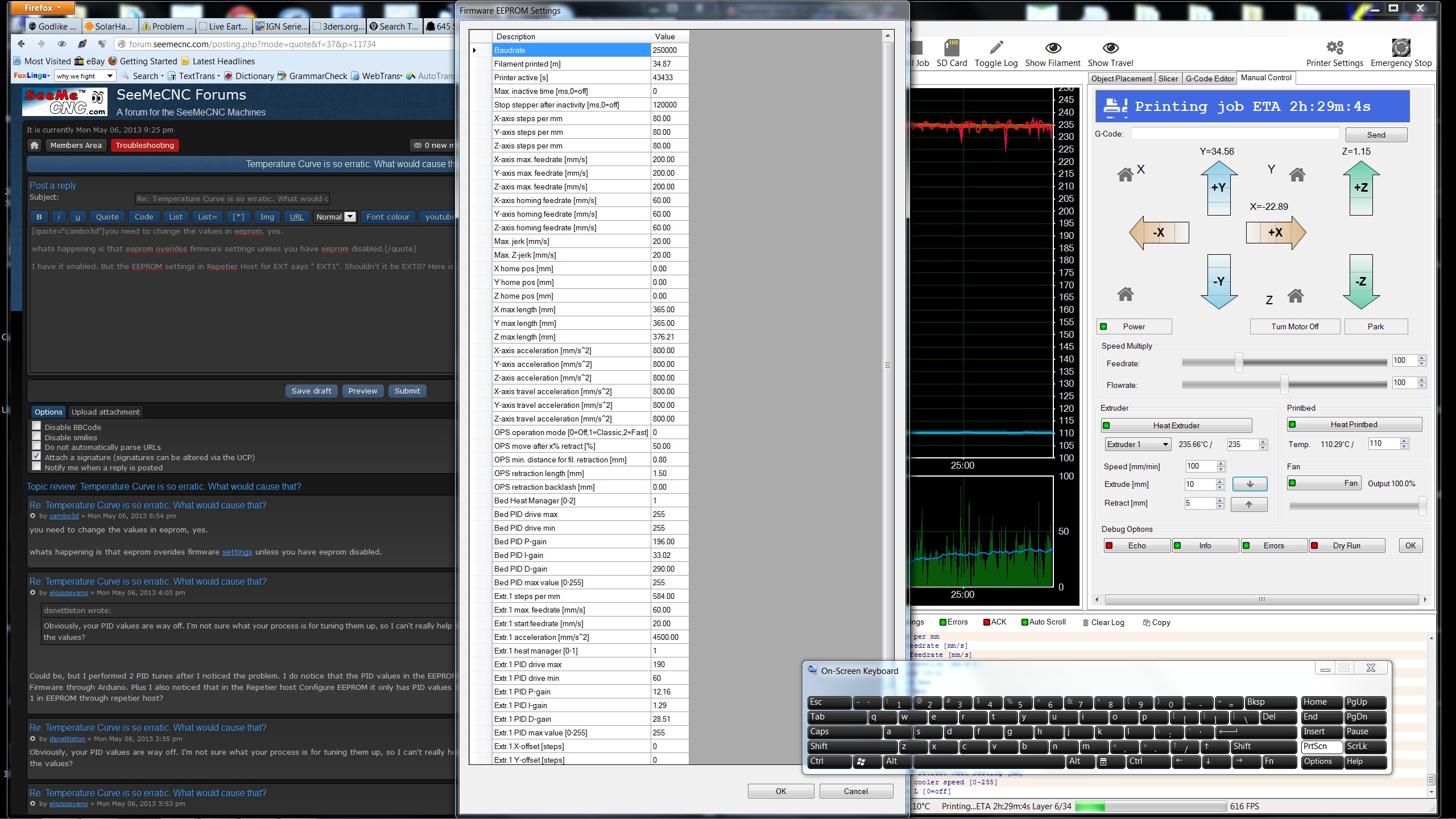

Could be, but I performed 2 PID tunes after I noticed the problem. I do notice that the PID values in the EEPROM are different from the values I add to the Repetier Firmware through Arduino. Plus I also noticed that in the Repetier host Configure EEPROM it only has PID values for extruder 1.. Am I supposed to change the values of Ext 1 in EEPROM through repetier host?
cambo3d
Posts: 1057
Location: Florida
Post by cambo3d »
you need to change the values in eeprom, yes.
whats happening is that eeprom overides firmware settings unless you have eeprom disabled.
elqisqeyano
Posts: 256
cambo3d wrote:you need to change the values in eeprom, yes.

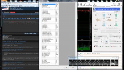

I have it enabled. But the EEPROM settings in Repetier Host for EXT says " EXT1". Shouldn't it be EXT0? Here is a screen shot...
Also, Notice in the "Filament Printed [mm]" field, should that be 1.75, which is what I currently print?
Also, Notice in the "Filament Printed" field, should that be 1.75, which is what I currently print?
Should I change EXT1 to EXT0?
