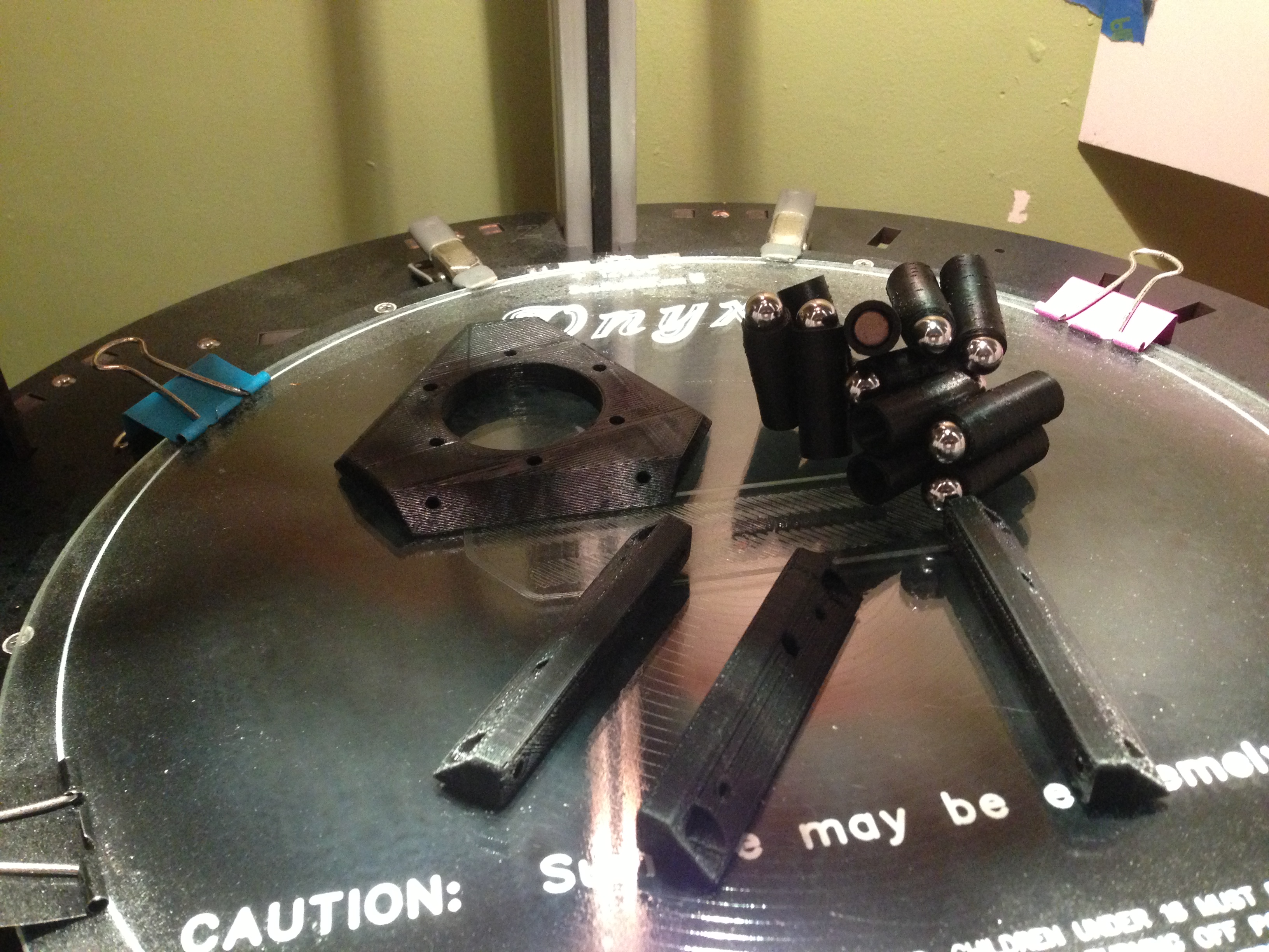

Broose wrote:Not hard at all. If the ball is sitting on the rod end with the magnet inside, the magnetism holds the cap screw to the ball. I kind of twisted the cap screws upside down into the JB weld to pick up just enough JB Weld on the top.elqisqeyano wrote:Broose wrote: First print. Looking good!!!
How difficult was it to JB weld the Balls to the cap screws?
I had to carefully use small needle nose pliers on the side of the top part of the cap screw below the ball when installing the cap screw/ball combination, because it still takes a fair amount of force to screw it in, even though I ran a longer 3mm screw through first a few times to get the thread going. On the other hand, if I had a piece of latex rubber between my fingers and the ball, that might have allowed me to apply more force so that I wouldn't have needed the needle nose pliers.
