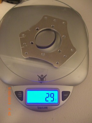

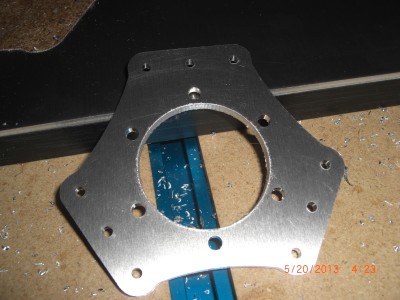

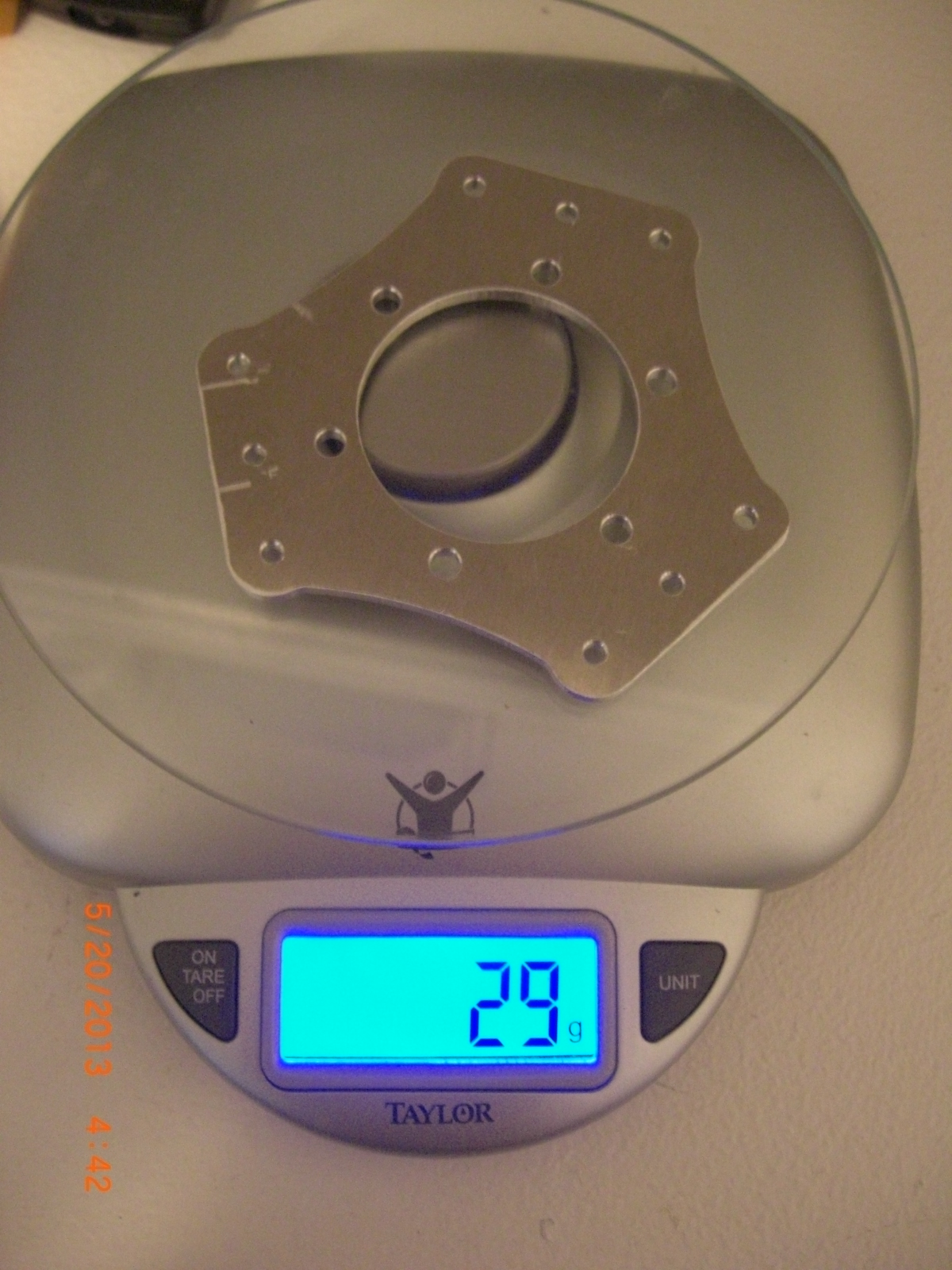

all aluminum platform for xnarons conversion prototype
Post by cambo3d »
prototype made

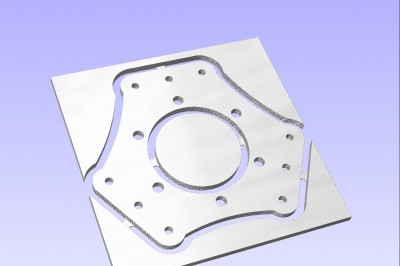

You could free up some space to make the aluminum effector a bit smaller by rotating the inner hole circle 30 degrees.
- dan
Posts: 5358
I detect a VCarve Pro or Aspire user... :D
Flateric
Posts: 811
Location: Calgary, Alberta
Post by Flateric »
Funny because my artcam sensor is going off on that one.

Did you create your own effector model? Or did you modify xnaron's?

Wow MRBLADE that is a thing of beauty!!! Well done! What size tap did you use? Would love a copy of the .stl

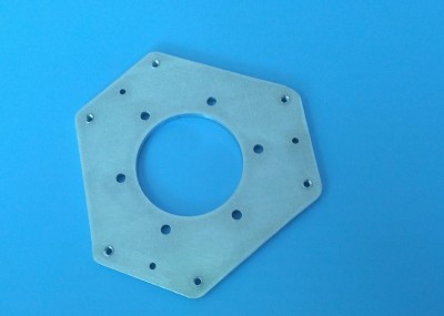

I create my own effector model.
[img]http://cs403126.vk.me/v403126555/7d3c/eLC1L2JOYco.jpg[/img]
I use cylindrical tips for D10mm magnets and D10mm carbon tubes.
Screwed M4.

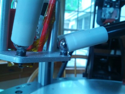

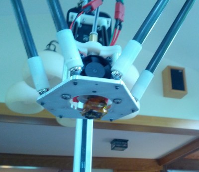

I thought I'd try out a flat aluminum effector plate with the mag arms today.
Though close, it makes it within my work volume (-120 through 120mm) without the rod ends touching the 3mm cap screws the ball bearings are sitting on. Here is a shot at Y-120.
Now I've got some Z travel back.

Broose wrote:I thought I'd try out a flat aluminum effector plate with the mag arms today.
looks good. I prefer this method over the original design for durability of the aluminum plate against heat.

I have found that heat was not an issue. If you are really concerned you can print it out of abs instead of pla.
