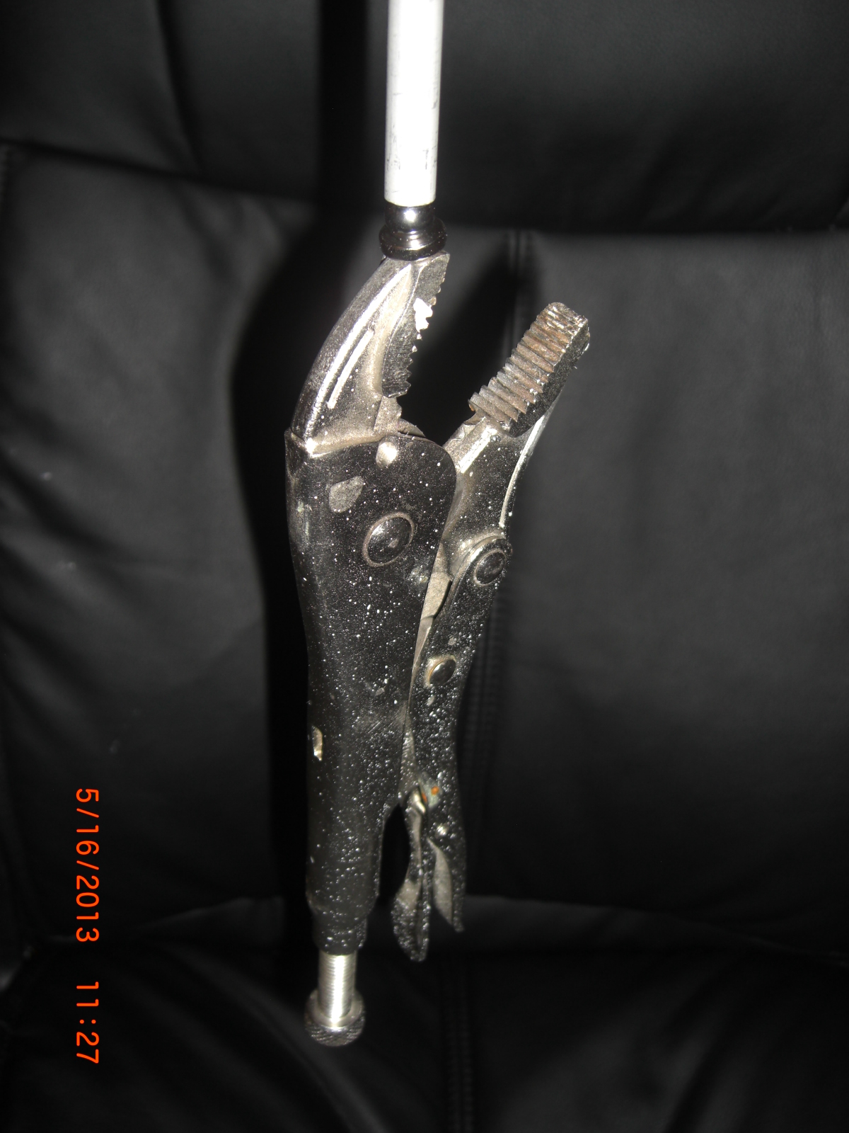

all aluminum magnet joint progress
Post by cambo3d »
some more progress on the all aluminum magnet joints compatible with seemecnc parts.
testing fit up
little more than a pound of weight

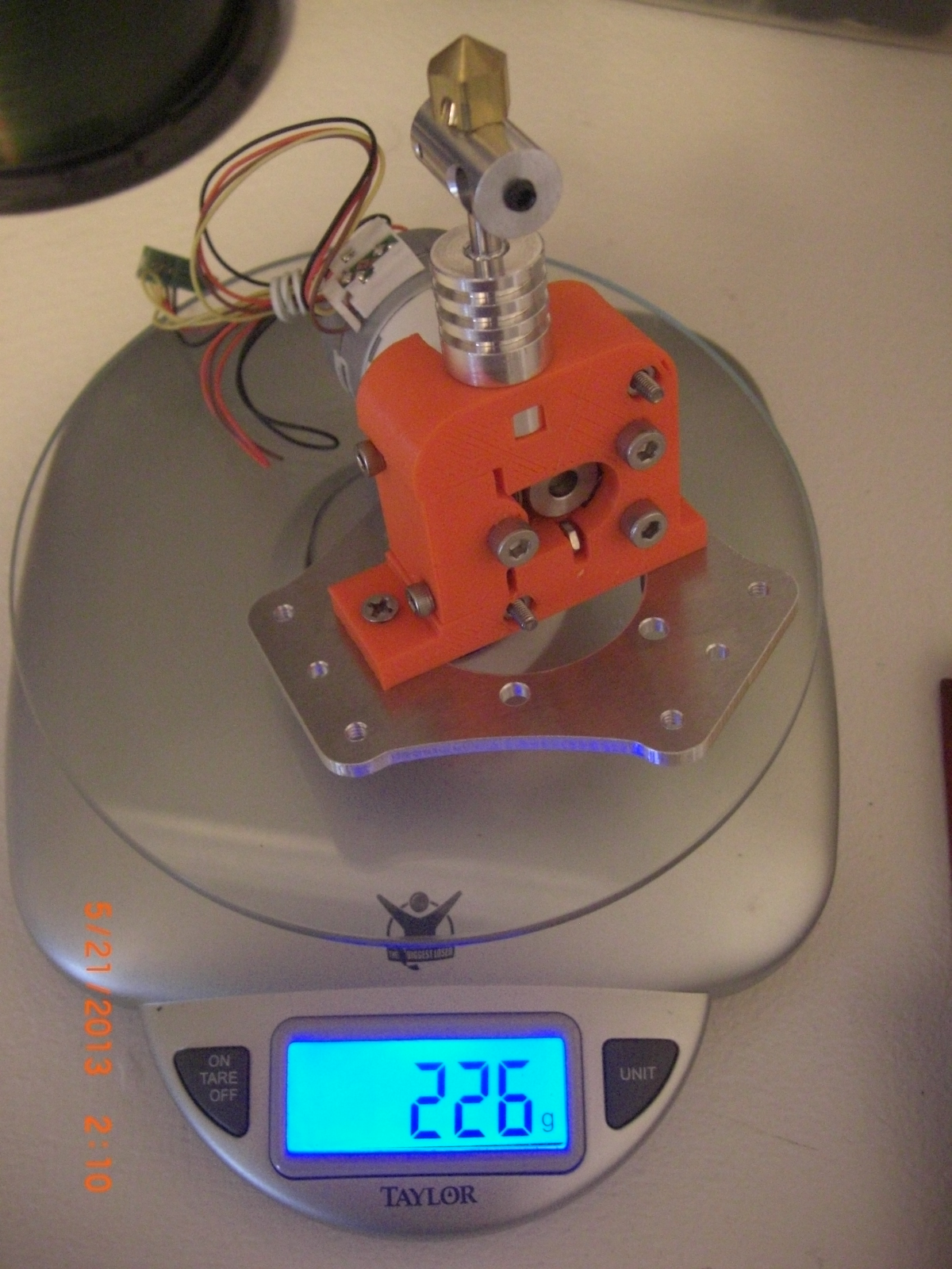

fitting up the direct drive extruder
Post by cambo3d »
Preliminary fit up of the bottom mounted direct drive extruder. the hole for the filament is not in the center but i'll try it anyway till that gets fixed.
compared to the weight of stock stepper of 332grams. this weighs about 226grams, around 240grams with the magnet ball joints installed. not to much lighter but with all the fans/heatsinks installed it should still be under 300 grams.
will need to modify the extruder mount and reprint so the hole is centered. or modify the aluminum affector

You'll almost certainly need a heat sink on the PG35L, and possibly a fan which will add to the weight a little.
Are you intending the bend the mounting points as seen on the BerryBot, or are you going to have it remain flat?
cambo3d
Posts: 1057
Location: Florida
Re: Another rostock max build
Post by cambo3d »
Polygonhell wrote:You'll almost certainly need a heat sink on the PG35L, and possibly a fan which will add to the weight a little.
Planning on keeping it flat for now. Will know better once its all fitted up.
doing some research on these little motors. they seem to be unipolar, instead of bipolar. our controllers are bipolar type, I think.
Is this why this motor runs hot?
