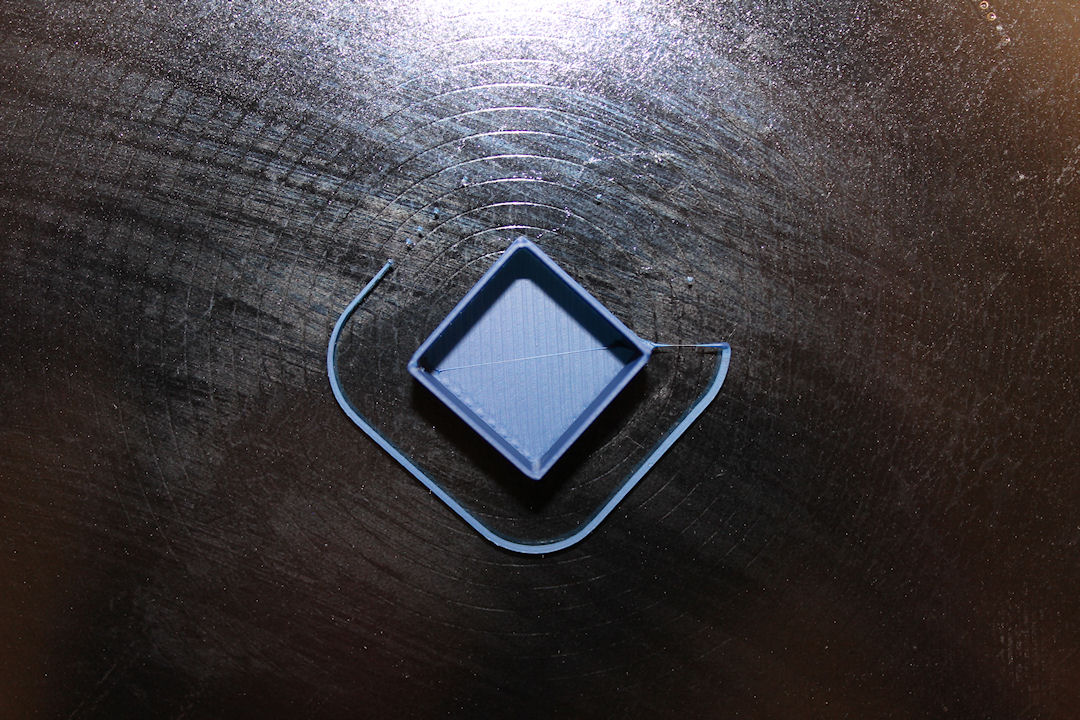

I'm using KISSlicer version 1.1.0.14 for most of the files I print on my Rostock MAX. Eventually I need to upgrade from the "free" to the paid version.
I am printing with ABS exclusively and use a raft under most of my prints (the latter statement is irrelevant). Every time a print starts there is a run of about 60mm or so where filament fails to come from the extruder. It does finally start and then continues to flow reliably until the print is done.
When the print starts the extruder sounds like it does a quick "suck" at about the same time the axes return home (the happy "G28" command).
Are other users seeing this same problem? Has anyone sorted through the g-code to see what's happening? And has anyone developed a simple G-code fix/patch?
I have searched the KISSlicer forum and found a single post that relates to this issue. But the solution(s) are for gantry-style printers ["wiping" the nozzle after extruding 10mm (+/-) of filament] and I question if the same technique(s) will work with a Rostock MAX.

Can you post the start section of your g-code please?
It sounds like the extruder is in absolute units, which is fine. In the printer tab, firmware tab, what is the "Firmware Type" selected?

The extruder is set to "absolute" in the Printer tab -> Firmware tab.
Here is the "meat" of the start of the code for a simple hollow box:
When this print started I did not get the telltale "suck" from the extruder. But, there was the usual 60mm "blank" as the printer started the skirt. Ugh!

Do you manually prime the extruder before running?
I usually manually bring everything up to temperature, then extrude 10mm at a time until I see filament, then click the start print button.
The issue is that plastic dibbles out after the print and as the head heats for the coming print and that has to be replaced.
You can automate this to some extent, add some gcode to the start gcode section, something like this
; extrude 20mm of filament at 200mm/s
G28 ; Home the axis
G92 E0 ; reset the extrude position
G1 E20 F12000 ; extrude 20mm 12000mm/minute is 200mm/s
; Simple wipe
G1 X-70 Y-70 Z0.1
G1 X70
G1 Z1
G92 E0
But be damn sure your bed is level, your moving the head 0.1mm off the bead 140mm, if it isn't level you will hit it.

Thanks, Polygonhell. I've tried "manually" priming, but it offers limited help when wanting to print from the SD card. The code you posted is similar to the strategy noted on the KISSlicer forum. My bed is flat. I'll give it a run (and hold my breath!).
Here's a photo of the happy gap...aargh! Probably 30 to 40 mm, not 60 as earlier posted. Bill

I think I would just put the code Poly posted into the start of every print, maybe move the nozzle further off to the side though. In the past I reduced the amount of stringing at the start by bringing the nozzle to the start point of the print before heating the nozzle. It helps to minimize the difference but does not eliminate it. Now I use my nozzle wipe thingie to do it, it has helped a ton. When I first started using Kiss on my MM it would do this, I switched to relative e-units and never looked back. I now use absolute on the MAX though, seems to be fine.

The loud "POP" you may have heard was me pulling my head out of my a**. I finally waked up to the fact that preheating and extruder priming can all be done from the LCD. This makes it easy to heat the bed and extruder, extrude 20 mm of filament, and, then, immediately start printing a file from the SD card. Perfect!
