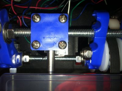

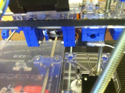

Got some Blue filament in, its darker than the seemecnc blue, but oh well. Took a photo bracket and switch installed, now just have to wire them up. I'll throw it up on thingiverse tommorrow, just incase anyone might be interested.

Looks nice Kilroyo! I will definitely be printing them for my second H-1!
