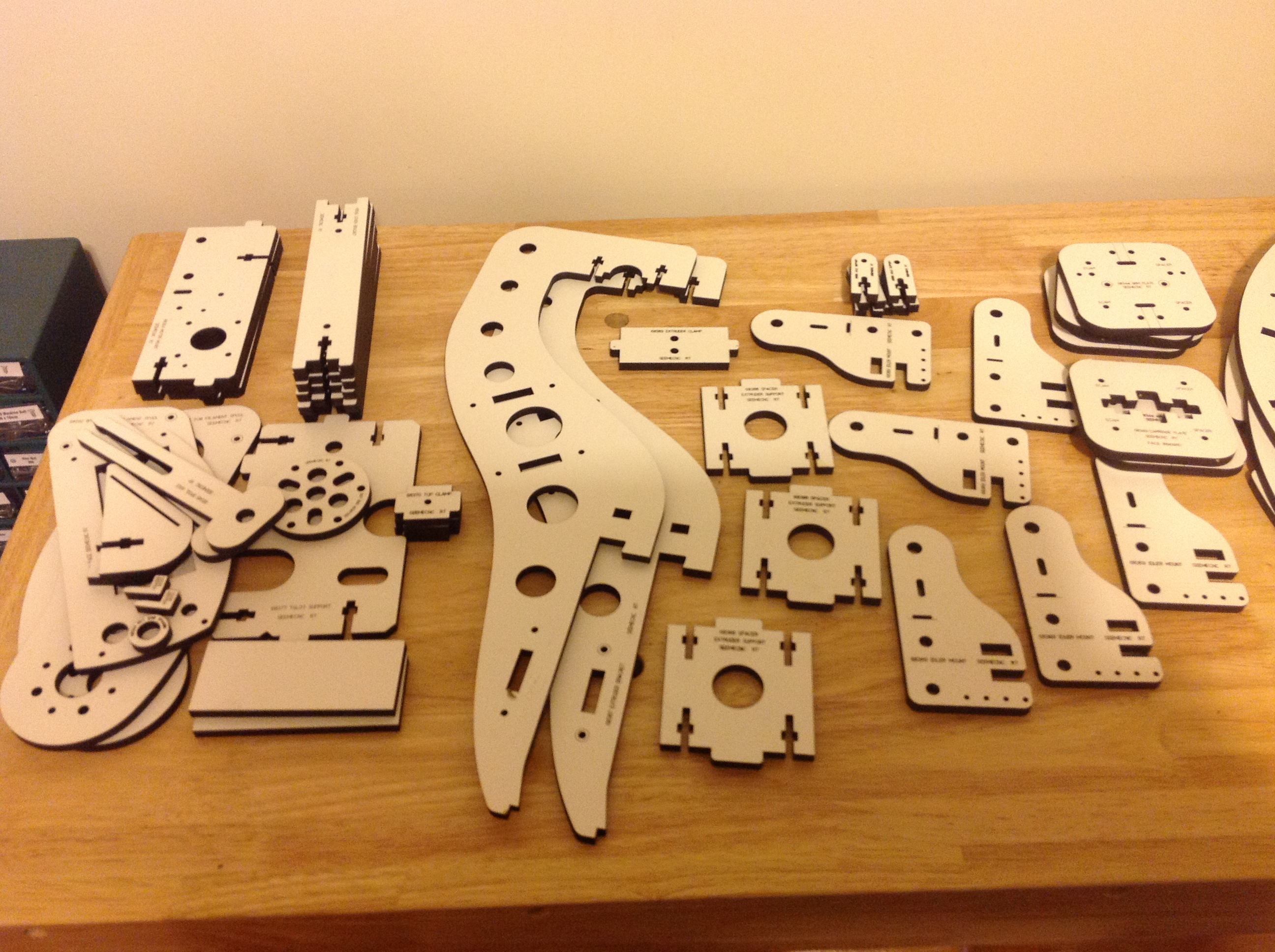

I started my build over the weekend. This is probably the most difficult thing I've ever tried to build - and I call it difficult due to my inexperience, not for any other reason.
On with the build ;)
Arrived
Arrived

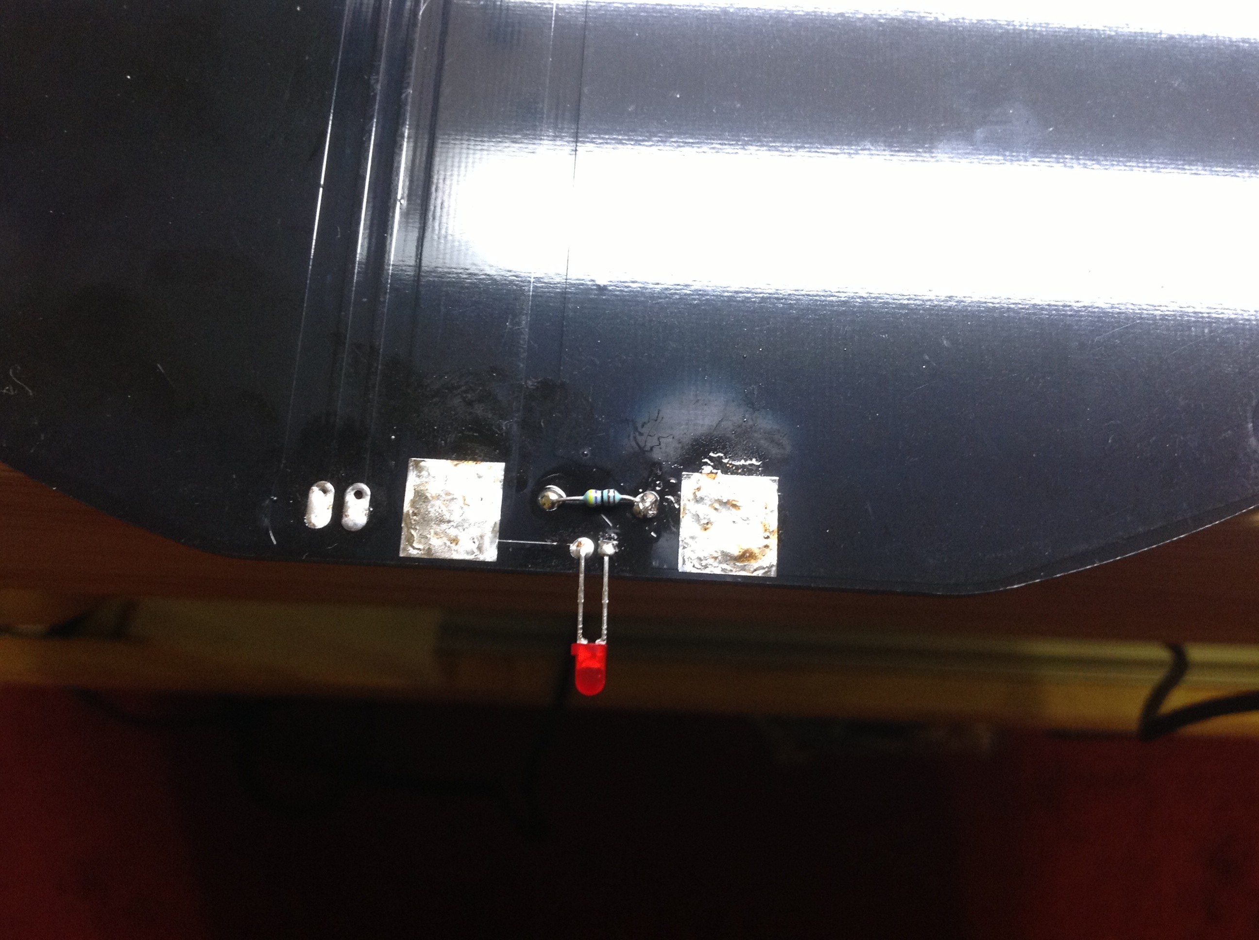

I'm having some trouble getting the power leads to the Onyx bed attached, but I'm going to try again tonight, then i should be able to mount the power supply and Rambo board.

My Rostock was one of the more challenging builds I've ever attempted, but the kind folks on this board really helped. Everytime I hit a bump in the road, I'd have an answer within hours on this forum!
I've seen people do everything from using 4 of the tiny wire bundles for each onyx power pad, to using 3 pairs of speakerwire (my choice), and even people using Silicon 10awg power cables (silicon cables are easier to route through the top base and into the cabinet). You're going to need a high temperature iron to solder the pads, I had my Variable temp weller up to full heat before I started.
