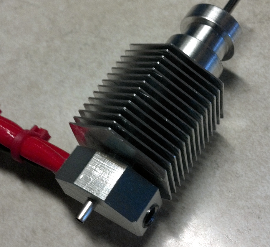

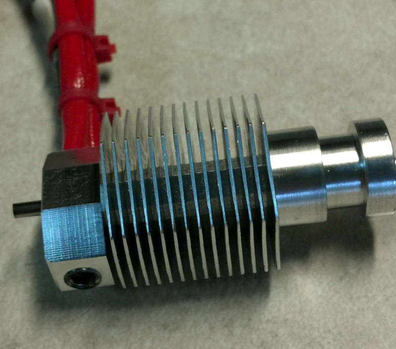

made some progress on the next iteration of my metal hot end.
Added more cooling fins than before.
Changed overall shape. Machined from one solid piece of aluminum hexagon bar.
Filament tube is seamless stainless steel that will be formed on end to make the extrusion orifice.
My goal is to have seamless path for filament all the way from cold end to orifice.
Only two pieces for the complete hot end.
Still need to build tooling to form end of tube.
~*Brian

Wow! looks really nice Brian! Anxiously waiting for an "all metal" choice of hotend. This one looks like it will definitely be in the running.

I understand the huge advantage of not having any seams, but stainless has relatively low thermal conductivity compared with aluminum, brass, or copper. That's why its used for a thermal break. Wouldn't that make it problematic to use for the nozzle orifice?

I don't think there is any issue using it for the nozzle orifice, if anything it should retain heat better. The prusa hotend is the same way.
I still think you'll have issues with PLA though, I can get decent prints in PLA out of the E3D Hotend, but it's considerably more sensitive to various settings and there is an issue with retraction, speculating as to what happens I would suggest that the rubbery PLA partially jams in the stainless tube on the forwards stroke dramatically increasing the time for the pressure to equalize, IME this leads to inconsistent extrusion following any significant retract.
Note with ABS and Nylon the E3D hotend is really very good.
I think Nopheads taper through the thermal break is probably the best solution to the issue, but for 1.75 it would probably require a custom tapered reamer.
Reading through the threads on the reprap forums about all metal hotends, some people seem to have some problems with all of them, and I have to wonder if any all metal hotend is the best choice for PLA.

Thanks for all your helpful comments and suggestions!
Yes, I definitely want the I.D. of tubing to have a smooth taper to the orifice opening.
From 2mm to .35 mm in distance of 4mm is what I am shooting for.
If the filament can be kept well below it's softening point up to a short melt zone, I speculate the retract will work better.
Also hoping the smooth slow tapered I.D. at end will have less back pressure. Maybe even drool less, therefore needing shorter retracts.?
With my J-Head and ABS it seems to have better more predictable retracts with fan on hot-end ALL the time, keeping it really cool.
Could it be that the ABS is soft and stretchy some distance before the melt causing issues because it stretches thin on retract the balls/jams just a bit when restarting extrusion?
I do not *have* to run fan with ABS, but it works better I think.
PLA's lower melting point may just make it more of a problem than ABS/
~*Brian

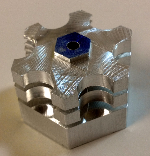

Here is a revised design I machined up today for the cooling fins on my hot-end.
I think I will go with it. calling it the "Starfin" design ;-)
Test piece only has 2 fins, the actual one will be 1" long and have 5 fins of same dimensions.
~*Brian V

Is it just me or is the center hole WAY off? :)

I am curious. How does one go about machining a smooth inner transition like the one you mention above? Grind down a nice sharp drill bit to have a pointy end?
