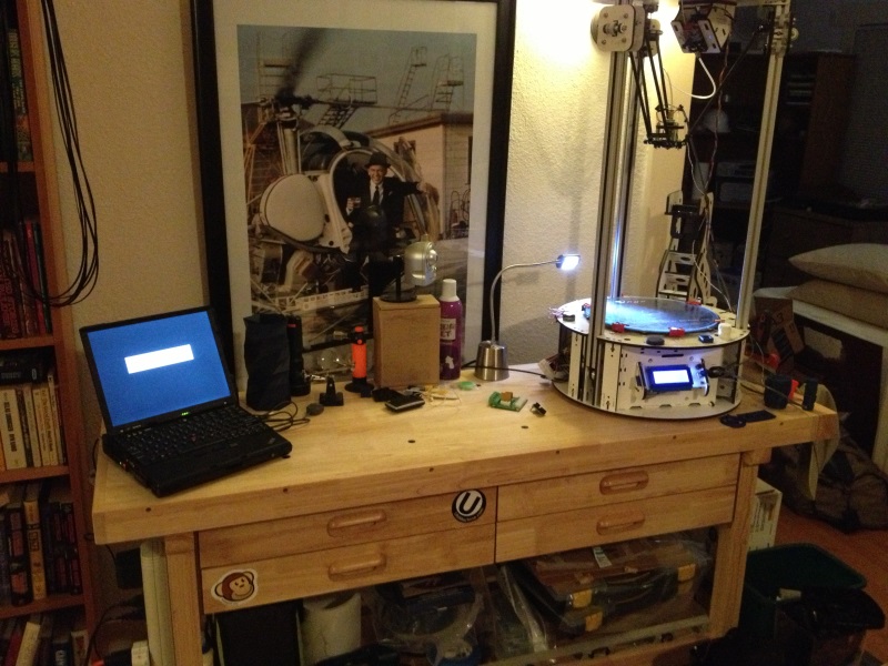

How are you liking the top mount?
Re: A n00b builds a Rostock Max
I'm liking the top mount quite a bit actually. I had a couple of spools of filament that would not fit on the original side mount that I can use just fine now. Also, I gained some usable space on the worktable I have the printer standing on.

Hey, that bench looks mighty familiar. Best $149 I've ever spent!
First things I printed on the Max was plugs for the wood-peg holes. Don't like constantly dropping little bits and screws into the drawers. I just screwed electrical box cover plates to the underside of the tabletop, and then drop in the printed plugs. I can pull them out if I need to use the wood pegs.- Attachments

Yes, I bought two of those benches at Harbor Freight!
Hey, that's a great idea, I can't tell you how much crap I've had drop through into a drawer when I'm working on something.
