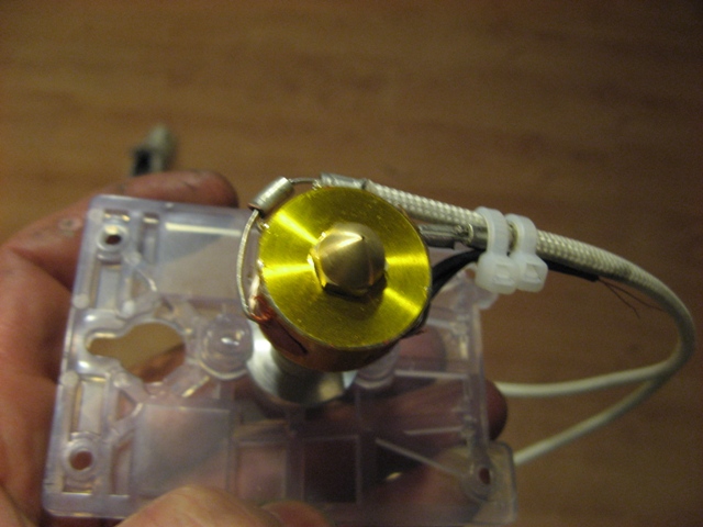

Well, finally got all my wiring completed, and some little things buttoned up, finally got around to testing my hot end,
turned the switch on with the pot all the way down, got called out of the shop by the kids for no more than a min and
when I came back my nozzle was hanging off and all melted :x
Crap! 1 step forward 2 steps back. ordered some stuff from seemecnc (a bunch 'o' stuff) and will attempt again.
Why would the hot end get so hot so fast? even with the thermostat turned all the way down? I check for a short but
didn't see anything wrong :?
JTCUSTOMS
Re: JT's H-1 build log and mods
JTCUSTOMS wrote:Well, finally got all my wiring completed, and some little things buttoned up, finally got around to testing my hot end,
Possible causes: Thermistor was not sensing temperature because of high temp silicone in the hole before thermistor was installed, thermistor was shorted, thermistor is defective.
Other possibilites include a bad thermostat, wiring problems etc. A valuable lesson learned, if you are in the testing phase, stay with the machine and if you can't turn everything off
until you can provide your unimpeded attention. Here is wishing you better results the second time around.

I tested the hot end for any shorts, its good. I am just curious why it took off without even turning it up. Got another one on the way so will try again when it gets here.
JTCUSTOMS
JTCUSTOMS
Posts: 100
Joined: Mon Mar 26, 2012 1:33 pm
Location: The "HAM" Washington
Post by JTCUSTOMS »
update:
Got the new thermostat and it works....just like the first one.
Which I thought was strange that it just started ramping up right when I turned it on even after the thermistor and heating resistors were isolated, but I put it all back together and cranked it up and it maxed out about 185c w/ a 10kohm resistor at R5. Oh well now I have a backup. I ordered it from seemecnc and It came with an extra resistor just floating around in the box not in the sealed velleman package, wonder what thats about?
Also bought the new 3mm hotend as well nice 1 piece design.

I am with you on that one Ressie! I burned mine up before first squirt as well!!
In my case I believe it was a bad thermistor, put a new one in and away she went.
I would sure like to verify what the extra resistor is before I drop it in,which means now I have to find it, but it would be good info to know if indeed seemecnc is providing these resistors at no charge! Outstanding, if you ask me.
Saves money on separate shipping charges.
BTW how long did you wait before turning the velleman off when testing the new hot end? And double check your thermistor is going to stay put and not short out.

Little update, got the new hot end together, wrapped the head in kapton for easier cleaning , still have to put a small piece around the nozzle.
Pushed some 1.75 abs through it last eve, now I can button up all the electronics and get to extruder cal. and bed leveling then i can start getting my settings all nailed down, so much to do so little time...
