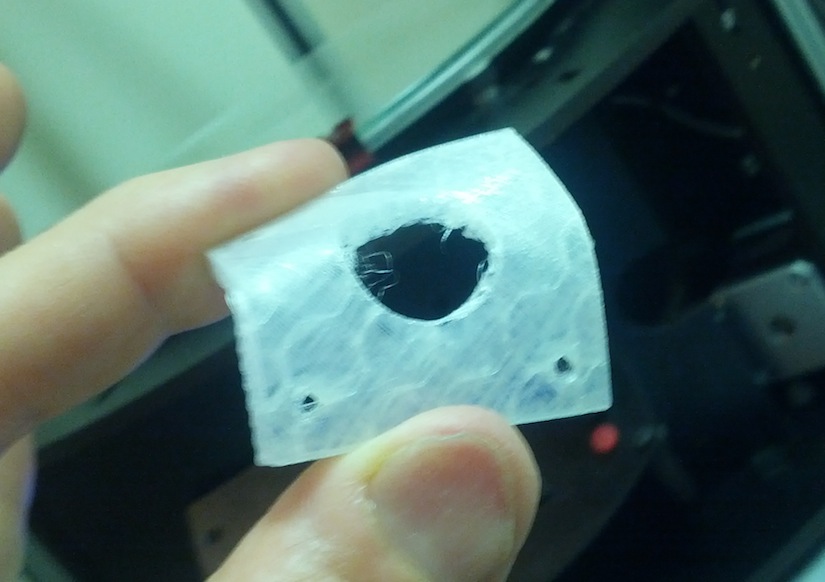

I wonder if you could print it out of nylon? I printed a bracket I had previously made thats close to the same size with Kisslicer and sparce infill (12.5%) using Taulman 645 and its fairly flexible and spongy. It probably needs some experimentation to get it just right, but maybe it would work.
Edit: No- made one. probably not going to be springy enough - stick with the cork.
