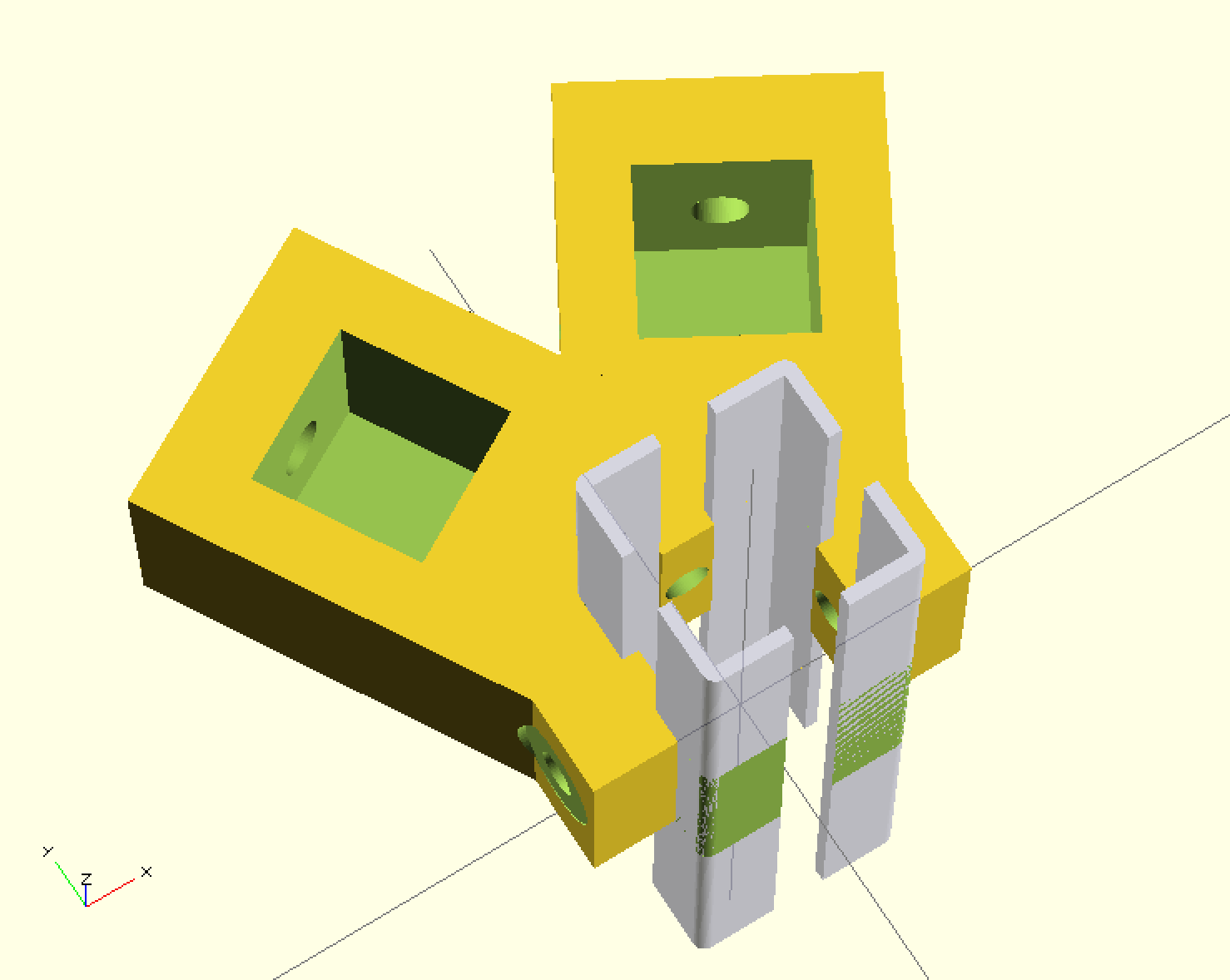

You mentioned bracing the towers over on your build thread. I've modeled this, and I've printed an earlier version. The idea is to put threaded rods through the end holes and nuts inside the boxes. Adjust the nuts to fine-tune the intra-tower distance.
Tower Brace, rev. 0.000002.
This is an early iteration, mostly just to see if I can make something attach to the towers. I have to make the bottom ones much thinner so they will go under the Onyx, and the top ones have to somehow cooperate with the limit switches and upper idler wheels. And the T-slot nut where the belt is will have to go.

I like where your going with that design on the brackets, I think we would get more support if the bracket fully enclosed the tower.
kbob
Posts: 286
Location: Eugene, OR, US
Post by kbob »
CJGerard wrote:I like where your going with that design on the brackets, I think we would get more support if the bracket fully enclosed the tower.
Thank you.
I was not originally thinking, "Make it rigid." I was thinking, "Position it accurately before tightening the T-slot nuts."
OTOH, that piece is absurdly strong for an alignment jig. Maybe I just don't know what I'm thinking. (-:
doctorgonzo
Posts: 107
Joined: Thu May 16, 2013 7:46 am
Location: Atlanta GA
Post by doctorgonzo »
What's the point of the alignment jig, other than alignment of the arms? Super-stiffness?
