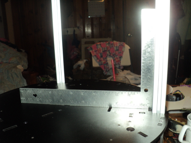

So today I got the point where i installed the limit switches. Man they were a pain, I ended up running a wire coat hanger through the hole and then just pushing the wires through. every other way i tried (including fishing line) didn't work. I left the center of the limit switched attached so i can install a led on them at some point in the future and covered the exposed wires with heat shrink tubing.
Squaring and leveling this thing was a royal pain in the but, i got through it but it took quite awhile. I'm probably going to make some brackets for it at some point in the future. I just don't trust the platform always staying reliably square and level.

Can you share your vision on the brackets, I am interested in what you plan to do and where you would place these.CJGerard wrote:So today I got the point where i installed the limit switches. Man they were a pain, I ended up running a wire coat hanger through the hole and then just pushing the wires through. every other way i tried (including fishing line) didn't work. I left the center of the limit switched attached so i can install a led on them at some point in the future and covered the exposed wires with heat shrink tubing.
Re: The Blacked out Rostock
Agree, wanna understand more about brackets!
http://dropc.am/p/KhiI1a
Im still in the brain storming stage, but there are several area's i can focus on to do this.
First of all at the base, i can take some off the shelf angles (used to re-enforce corners on shelves and such). Dust one side on an angle plate to ensure that they are perfectly square and place them on the base. (three would be used per extrusion)
Also the area on the outside of the rostock can be utilized to place a bracket or plate from the melamine to the rostock. I'm assuming that the servo drive mounts in the base are going to be pretty square considering how they were made. plus this will cover up the exposed belts in the base.
In all areas the slot in the alum extrusion would be used to bolt the extrusion to the base.
