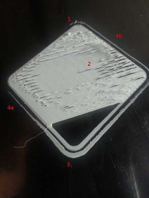

ok, maybe this picture will help pinpoint the problem. This is the worst first layer I have ever seen and it is with my new J-head:

Re: Very Poor Layers
The plastic is feeding inconsistently.
Could be a lot of things.
First thing to try is increase the temperature by say 10C.

- foshon
- Posts: 600
Judging solely on the first layer pic, you could use a good bed levelling. The skirt and perimeter both change widths far too rapidly. Also, do not depend on the same settings working for all prints. Calibration will change, print quality will change with every filament you run, even temperature changes in the room you print in can and will have a noticeable affect on your print.

- foshon
- Posts: 600
Ok here's a breakdown as I see it.
1. Together with 4a this area shows either a start of the extrude or a complete closure of the nozzle opening. with the lines of increasing width away from this area I would assume that as the nozzle got closer it finally closed it off completely.
2. This area of rippled layering, IMHO, is caused by extrusions being too wide. What happens is the nozzle drags across previously laid plastic, stretching and curling the leading edge. Basically the nozzle is ploughing a path through the plastic. You can see as the print goes further toward the thicker perimeter area the effect goes away. This is because the nozzle is further away from the bed and the extrusion width is slightly lower. The skirt and perimeter lines are thicker because there is pent up pressure from the extrusion being blocked for the previous bit of travel, gradually releasing more plastic until area 3. In the infill, you don't have this issue as badly because pressure is not relieved by retraction and the nozzle already has overcome the barrier produced by the blockage.
See how the infill starts on the high bed side?
See how thin the layer of plastic is under the number 1 corner, gradually getting thicker towards 2? You can see the little blobs, not ripples, just above the 2 in the picture. Those are caused by the hot nozzle shaving the plastic off. It stops shaving and starts rippling as soon as the nozzle is far enough away to extrude the appropriate amount of plastic. Further down yet you have the correct nozzle to bed height to extrusion rate and the print looks much better.
If you had let this continue it would have looked much better on the next layer and even better yet on the third, because the plastic is making up for your bed levelling issue. If it was my printer, I would level the bed and then do the full extruder calibration posted by Poly. I think you will see amazing results.

Foshon, I didn't know you had it in you! An absolutely fine job in diagnosing and then explaining the problem.
You, my friend, are getting scary good! (I was going to say all that but you beat me to it! Yeah, right.)
All kidding aside, that was one good writeup.

The bed is leveled with the same accuracy as when I was getting beautiful prints with my Rostock Max when it was new.

If that picture is off your printer you have levelling issues. Your bed level will change, you heat and cool it how many times a week? Just look what one season does to flat level ground. It's obvious that your not extruding properly as well, which is why I suggested Poly's guide found here:
