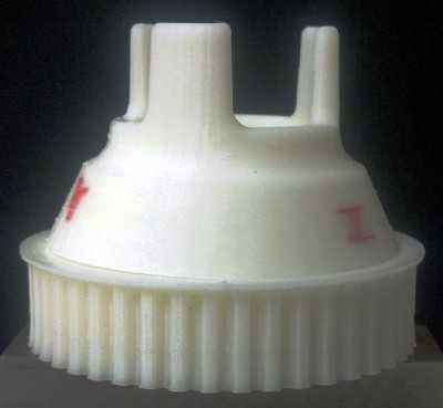

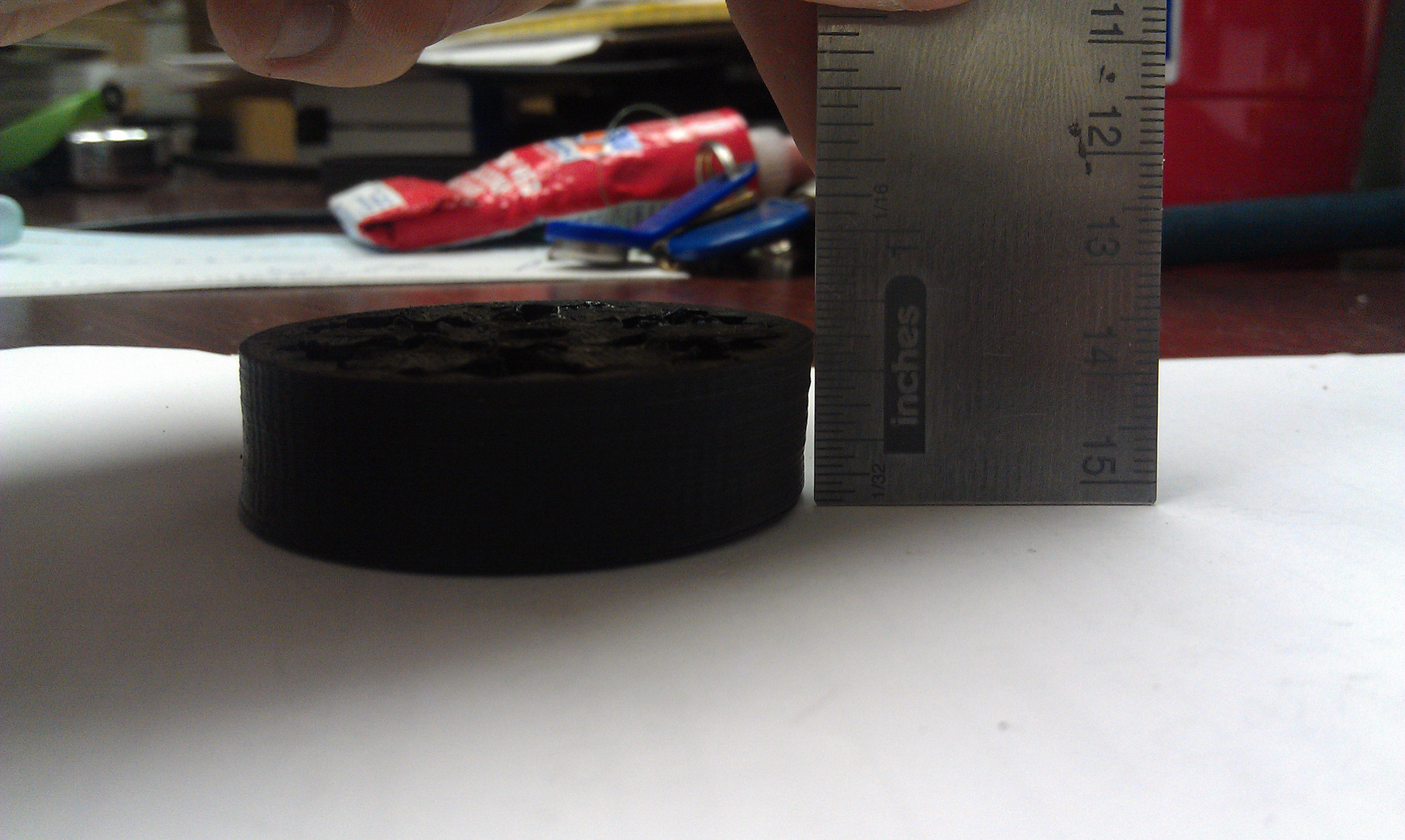

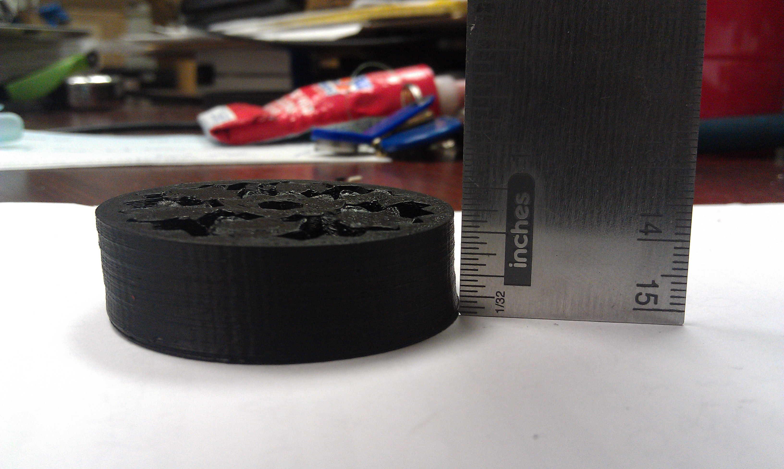

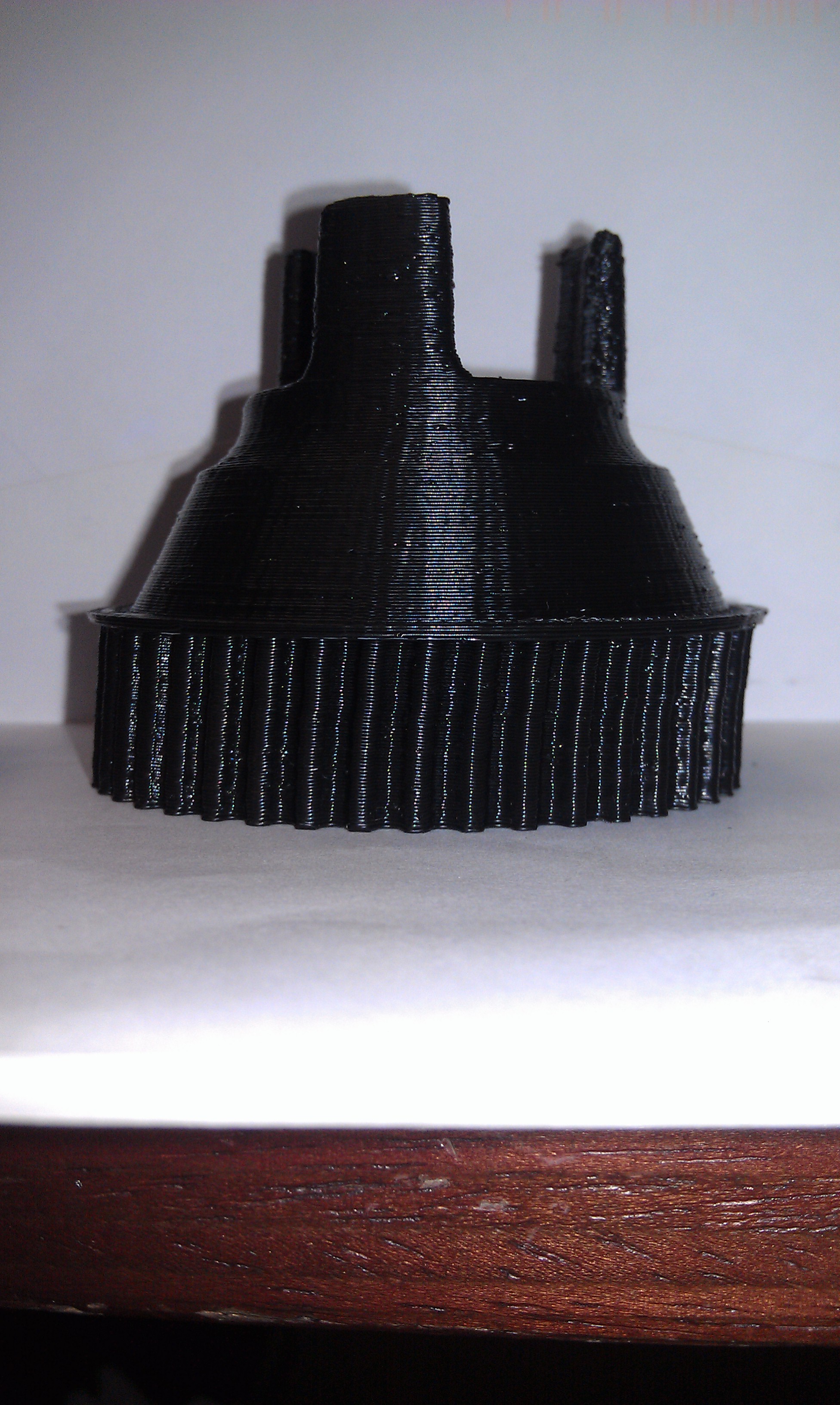

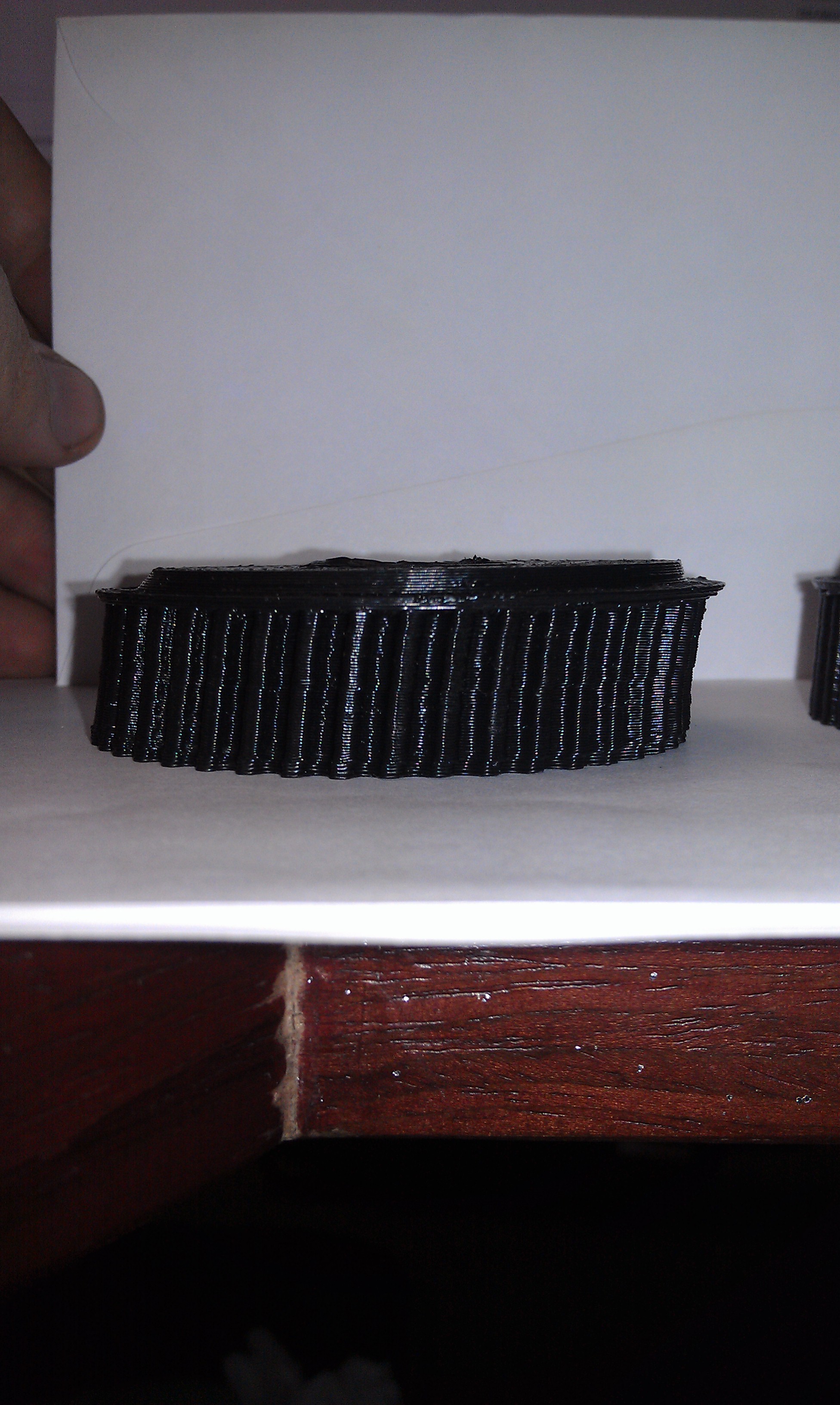

Hello Everyone...
I put my MAX kit together about 3 weeks ago. I successfully got a thin wall calibration cube to print nearly perfectly, but nothing else.
Every other print has a "lean" to it towards the X-Y towers. Aside from the lean, the layers line up cleanly and the prints look really good.
I've gone through everything I can think of. I've gone back and forth with Brian from Tricklaser and John. I've gone through almost every forum thread, though I may have missed something.
John told me today that he was confident that the pulley on the Z tower stepper was slipping. I pulled it apart, and the pulley was tight and hadn't moved. I did remove the set screws and re-set the pulley with fresh loctite.
I was very meticulous about my sanding, and I don't feel any play, but I did order the trick laser carbon arms to confirm it isn't the arms causing the issue. They haven't arrived yet, but here's what I've done/tried thus far:
Checked and used PTFE lube on all u-joints.
Calibrated extruder (My value was found to be 100.86 steps/mm)
Leveled bed
Shielded all stepper wiring with foil and heatshrink. Routed all wiring cleanly so there is no noise (after reading Apache's thread with a similar issue)
Calibrated delta radius - hot end moves consistently across the bed in all directions (slightly raises up right at the 140mm mark in all directions).
I've played with Jerk and Accel settings... Jerk from 2mm - 50, Accel from 100m/s^2 to 5000
Sliced the same STL with Slic3r (.9.9, .9.10), Cura, and KISS
Printed at 20mm/s speeds all the way up to 150. Slow print speeds generate less lean, but it's still noticeable. (picture of Emmett's gear was at 15mm/s)
Belts/Cheapskates all move freely. I may have had the belts a little too tight at first, but I've tried loose and tight with the same results.
Hot end is tightened firmly to the platform.
Tried printing off the center of the bed - all prints lean from Z tower towards X-Y towers - regardless of position on bed.
I have cardboard surrounding the printer, so there are no drafts or temp issues.
My IR thermometer shows correct temp on the bed (120C)
The carbon arms are scheduled to arrive on Wednesday, but it doesn't seem like they'll solve the problem.
I'm totally out of ideas, and pretty bummed/frustrated at this point, so any help is much appreciated.

kbob, the lean is the same no matter where I start the print in the X-Y plane.
It is less noticeable at slower speeds. The emmett gear I took photos of was printed at 20mm/s. The other part was at 50mm/s. You can see the difference in the severity of lean.
Cheapskates are all correctly oriented.
Nozzle is centered with that gcode command. I'm fairly confident in my calibration of the nozzle,bed leveling, and delta radius calibration.
In the process of taking the printer apart to check the alignment of the laser cut parts, all motor pulleys, tower heights, and to confirm wiring is routed to avoid any possible noise. I will also be installing the TL carbon arms that are arriving tomorrow.
Thanks for your help/suggestions. I will update as soon as I get it back together and test.
