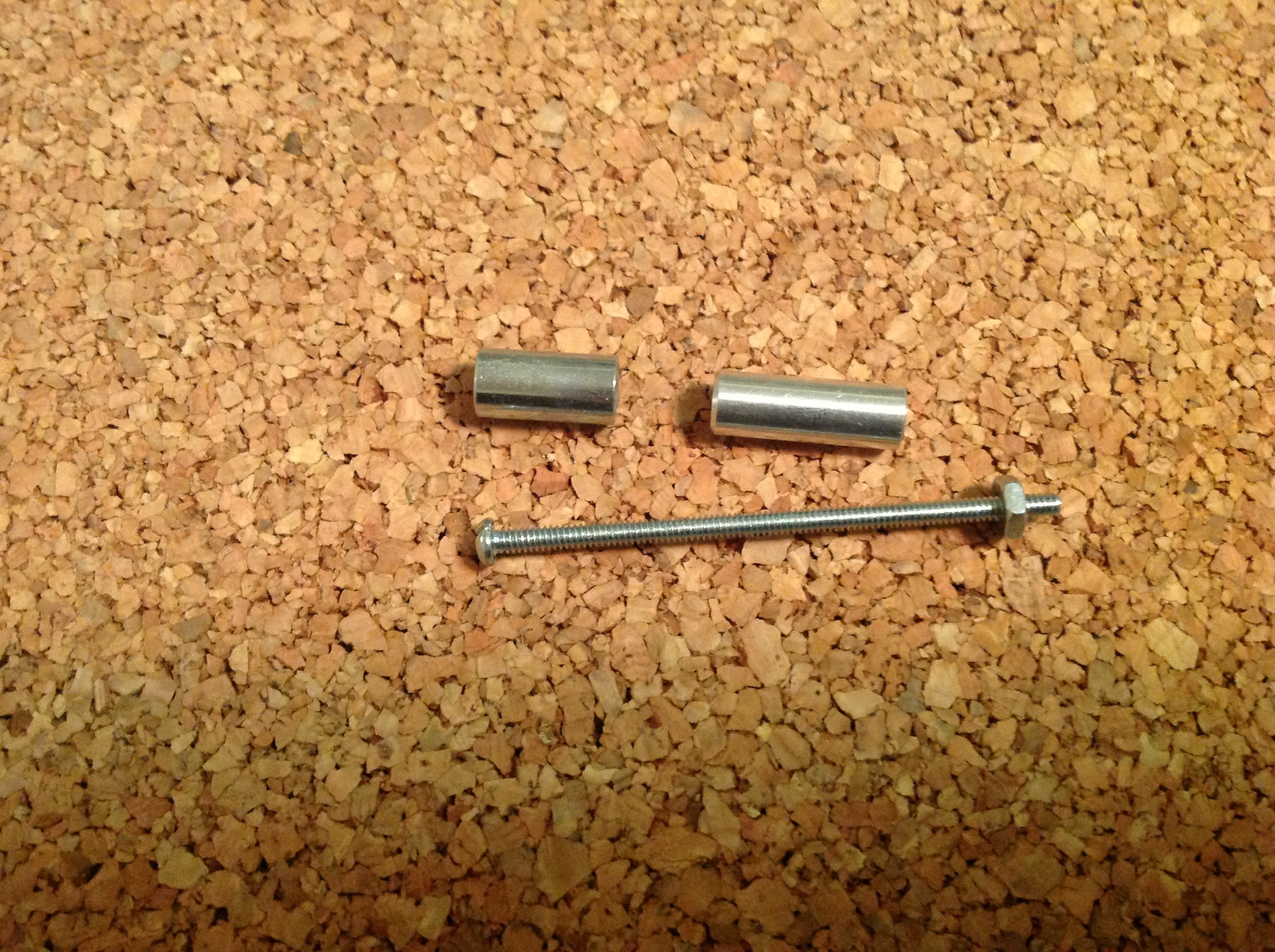

Here is my bowden version mounted using the ezgroove mount from seemecnc. Although I lose some printing height the way it is mounted the printed effector is safe until I decide to put more work into it.
When I had it mounted on the stock effector, I had to get additional spacers and longer screws to make room for the fan.
