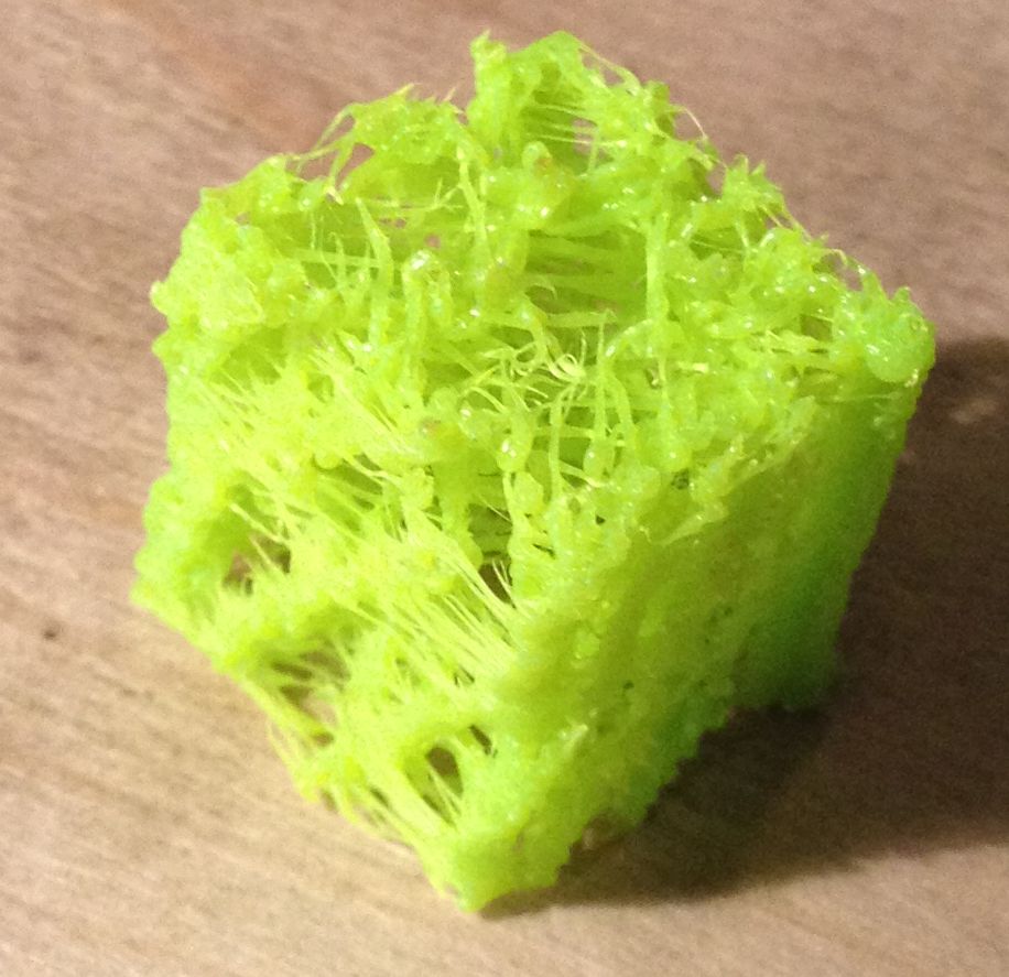

Wow,my first print and no comment, is it that ugly?

That is hardly the ugliest first print.
This is a front runner in the Ugly 1st print contest.

Wow! I didnt know these things can make astro turf!

It certainly isn't the solid cube I was looking for.
The dimensions were just about right though.
