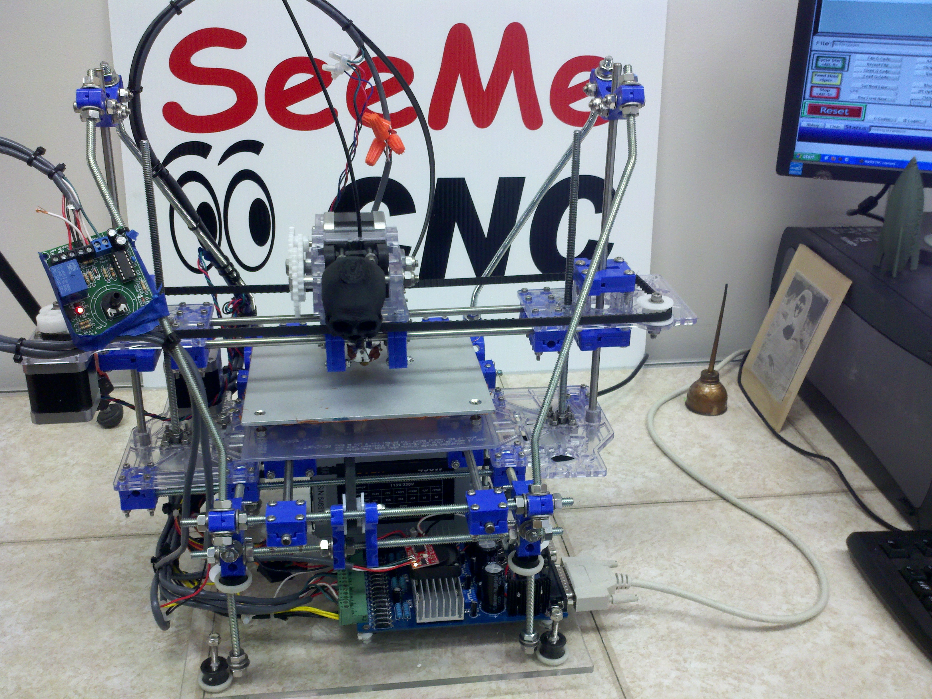

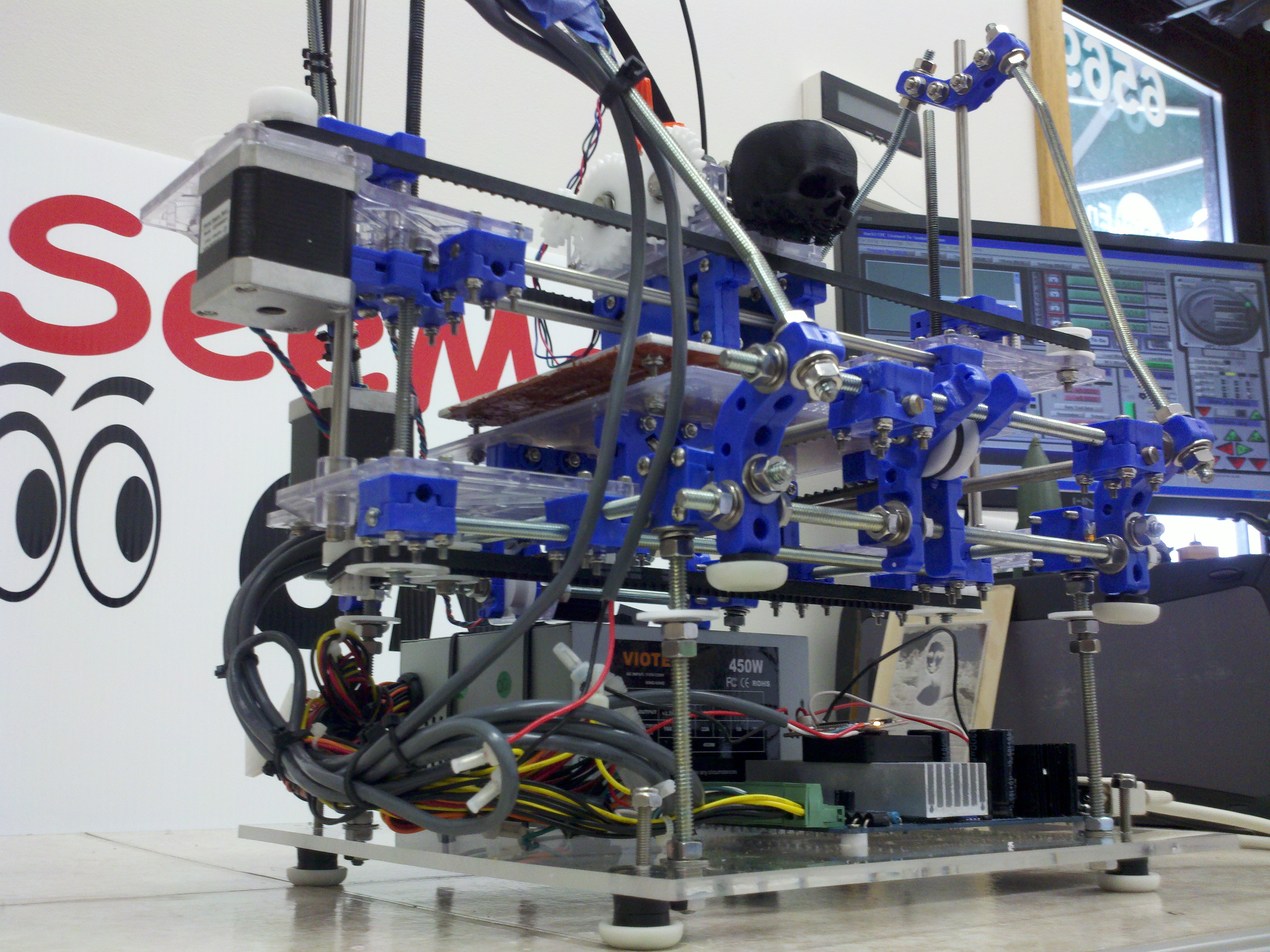

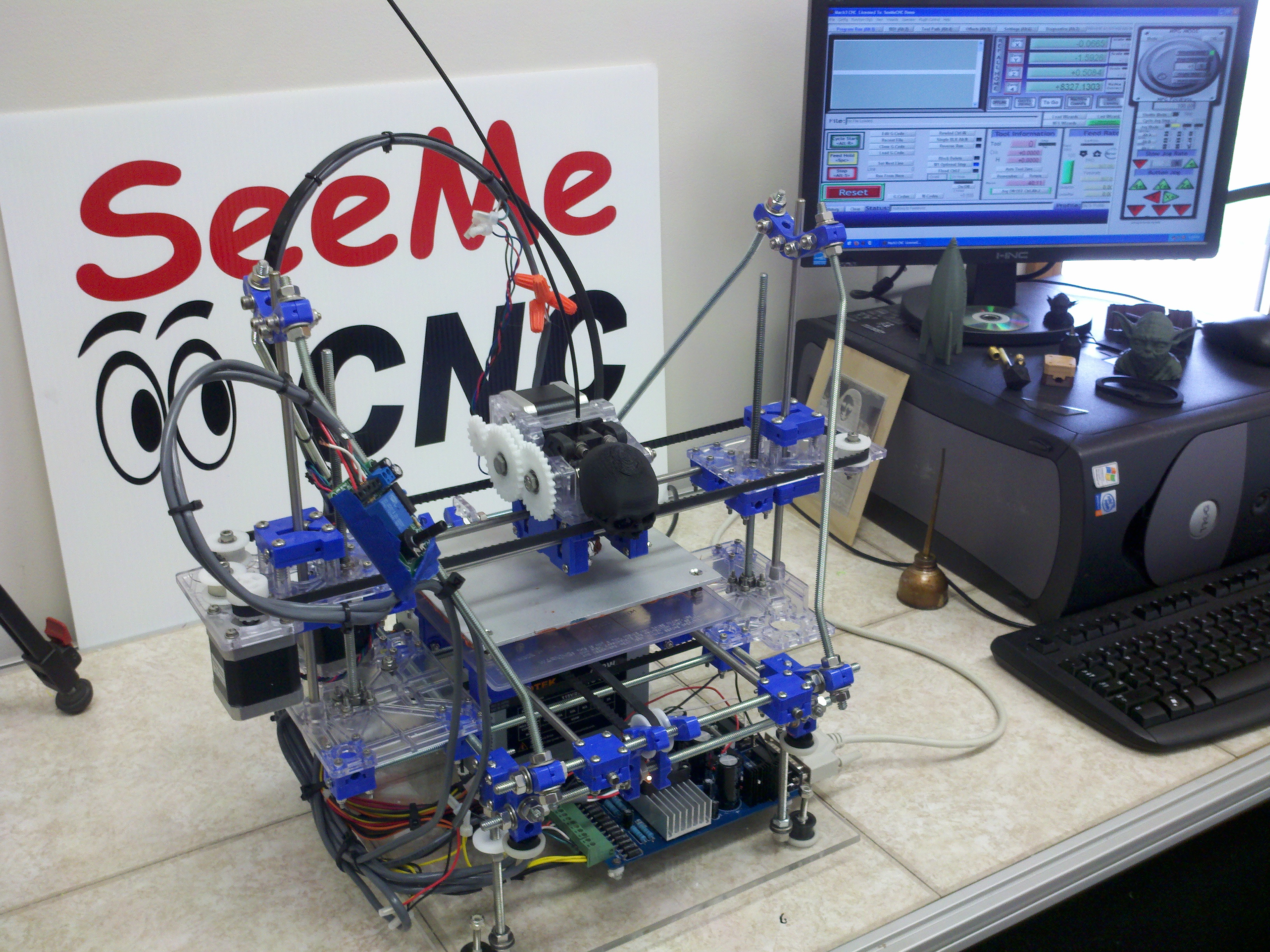

The H-1 with electronics below. Originally how I envisioned it. We'll soon offer this as an upgrade. I still need to make the mounting panel for the Velleman temp boards and switches. Switches to control power to heaters, main power, lights and future accessories.
H-1 with electronics mounted under. A new kit will soon be available.
SeeMeCNC Electronic mounting
SeeMeCNC H-1 with Electronic mounting and prototype heated bed.
There is a heated bed prototype I made weeks ago shown in the picture. Oly & I hope to make test prints this week.

Looking good. What type of HPB is that? Nichrome wire? Also, any tips on how to level the bed easily?

Hi Michael, I used one 6-32 x 1" flat head phillips in each corner. Instead of messing with springs, I just used only nylon lock nuts. The table is aluminum with RTV hi temp, nichrome wire, and more RTV.
I drilled holes in the stock table.
I jogged the table around slowly with the nozzle nearly touching. Then I used a business card to feel some interference between the nozzle and table. I jogged to sac corner several times and adjusted the table up or down as needed by loosenng or tightening the nylon lock nuts.
If this works, Oly & I will offer a kit.
We also are supporting the printed circuit board concept. I think both are good solutions.
