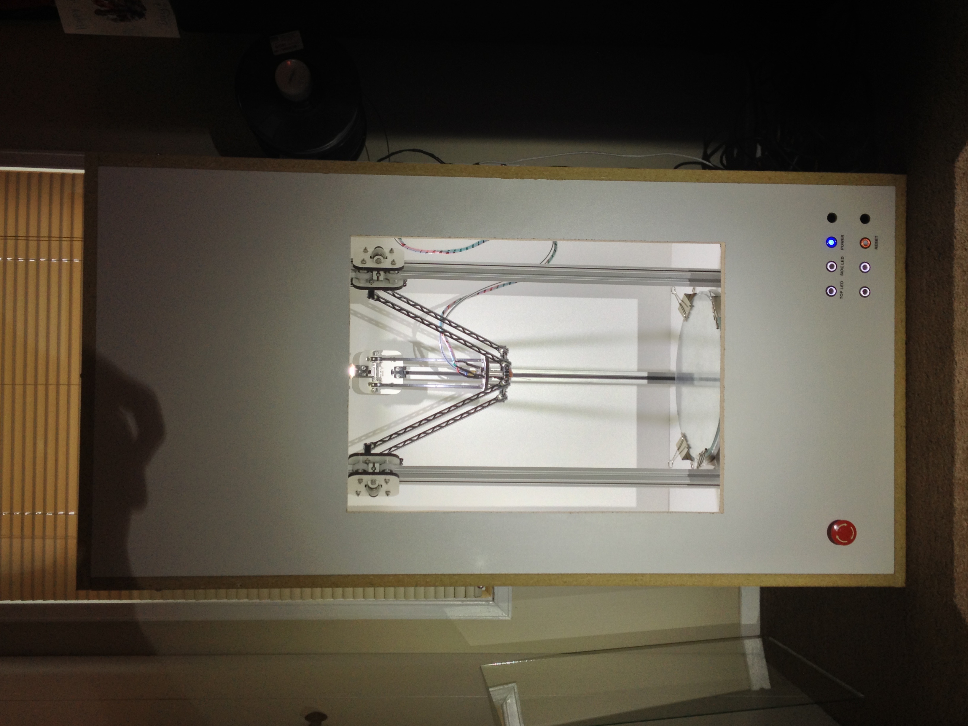

Update 2-26-14 My printer is almost complete
thenewguy
Posts: 47
Joined: Thu Feb 21, 2013 1:04 pm
Location: Chicago
Post by thenewguy »
Going to hook up a arduino separate to the printer. This will allow my glass window to open and close with a push button, stepper motor, limit switches. Ect. May also use it to control temps inside the case or other needs.
May put some amp and volt display at the bottom of the case for fun next to the buttons.
Have two rolls of film ready for dual extruders at the top right.
Have most of the parts to switch to magnetic ball joints.
Since I upgraded my power supply which is still 12v but almost 60amps now I beefed up my heating bed with mic-6 and around 300watts to heat it up. Takes about 15 mins to get to 100c which is still longer than I thought but not bad! Before with the onyx under it took over an hour for that big mic-6.
This is also on a relay to the Rambo.
Can level the bed with screw adjustment so far no problems with heat.
Had to fill in the slot that I cut out for the onyx. So just put some blue leds on one of the heating elements so I know when it turns on and off. : )
Hopefully more mods to come and better pictures...

Wow.
Gonna need loads of details on this one...
Where did you source the Mic-6 bed?
What are the lights on the front for?
Will you post your drawings?
http://dropc.am/p/KhiI1a

John I got my mic plate here http://www.sandsmachine.com/alumweb.htm
Took my router with a circle jig on it and cut it to size.
What do you mean by drawings? Prints?
The buttons are for power, reset on Rambo so I don't have to take the front cover off all the time and two are for my 10 watt leds. One at the top and a adjustable one on the side. Two buttons are spares and the blank two holes will be for up and down buttons for the glass window which I'm impressed with. It seals pretty well from the room. Just need to rig something up to move it. I'm thinking a timing belt stepper motor and some limit switches on an arduino will work ok.
Will upgrade to better extruder soon.

Can I ask why after all that work, amazing btw, you don't have an lcd controller mounted outside that box?
Purple = sarcasm
thenewguy
Posts: 47
Location: Chicago
Re: My printer is almost complete
Post by thenewguy »
Because I bought this in December. Tried many ways to get the thing working right with Rambo. Don't know if it was a lose wire. Something was backwards or the firmware.
So I said I don't need you anyways... Haha
Been anti ever since.
I like using host on my 32inch pc screen. I have a dual video output on my graphics card and had a old thick but decent size pc screen laying around maybe 17 inch. Ended up being to heavy, thick, and just really had no place to mount it. I thought about putting it on a hinge and mount on the side of the box or something. Just felt like overkill. I got it from work. So it's old school but was very expensive at the time. Maybe $1500

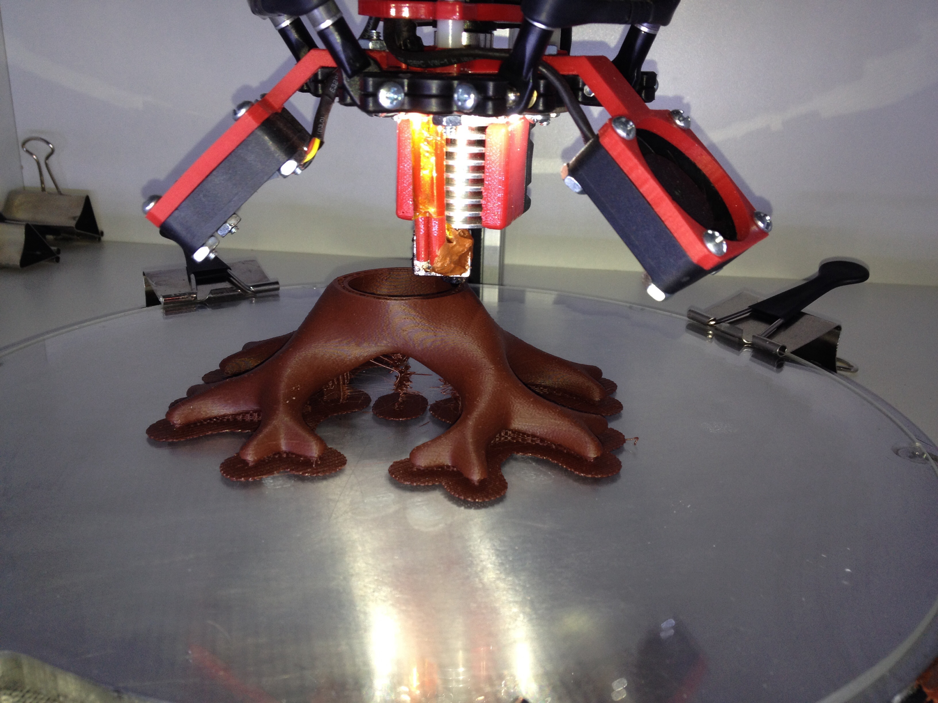

So I thought I would give you a good update. I have taken this thing apart so many times with constant upgrades I don't get to many chances to print. But I do finally have it working close to how I want it. I do still have to install the Arduino controlled glass window. Other than that
Enjoy.
Switched to the tick laser arms and added height.
To give you a good idea of the bare bones
Upgraded to the 20 tooth pulleys. Installed heat sinks with a fan on the back of each motor.  Also have the dampeners installed.
A lot of mods in this picture. The best one is my added support to the frame of the rostock. I noticed it was not too sturdy and questioned it. So I built these which are pretty adjustable to where it really helps me align my towers. With this and the adjustable aluminum bed things are pretty accurate all the way up. I Printed and installed the belt tension set shared on this forum. Installed a centrifugal fan with a carbon filter to eliminate odors. It also can be wired later to do more like control the temps inside.
When looking through the window I could see the top of the rostock pretty easy. I didn't like that. So I bought longer towers.  My z height is now 487. Not sure if I will ever need it .
For the go pro. I thought this bridge was pretty Ba.
100 micron abs from seemecnc

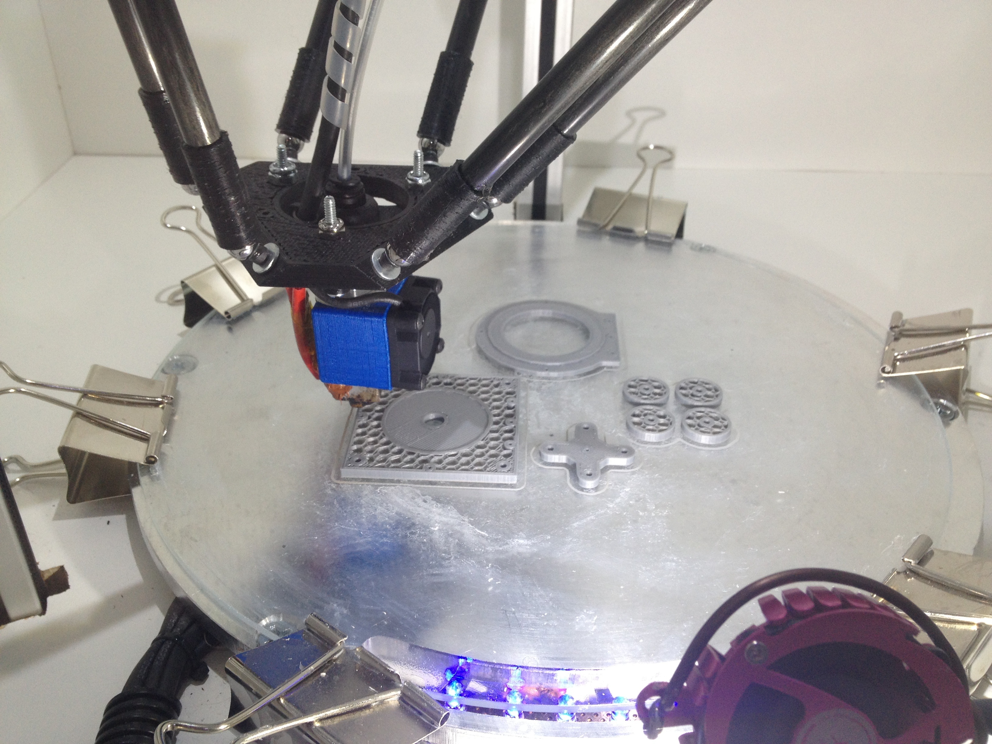

This is a good picture to notice the added heating elements. I have 5 40w heating elements normally used for hotends installed into the aluminum bed for faster heating times. They are on a cheap relay kit sold on seemecnc. I did install the onyx back under the aluminum to get very even temps along the plate. The onyx takes over after a few temps from the outer heating elements.

Why choose peltier elements for heating?
How are you even getting 100C from them?
Seems like a 110V coil wire would be much more efficient then the peltier elements, no?

The peltier elements worked. I had it to 105c with less effort than the onyx. However they lasted a few months and started to lose preformance. It also created hot spots on my bed. Even with that big piece of aluminum.
So now I have the onyx underneath set to 100c on the pid. I then installed 5 40w heater like in the e3d on another relay/controller set to around 95c. I can get my bed to 100c in around 25 mins now. Not as fast as I want but it's not easy either.
