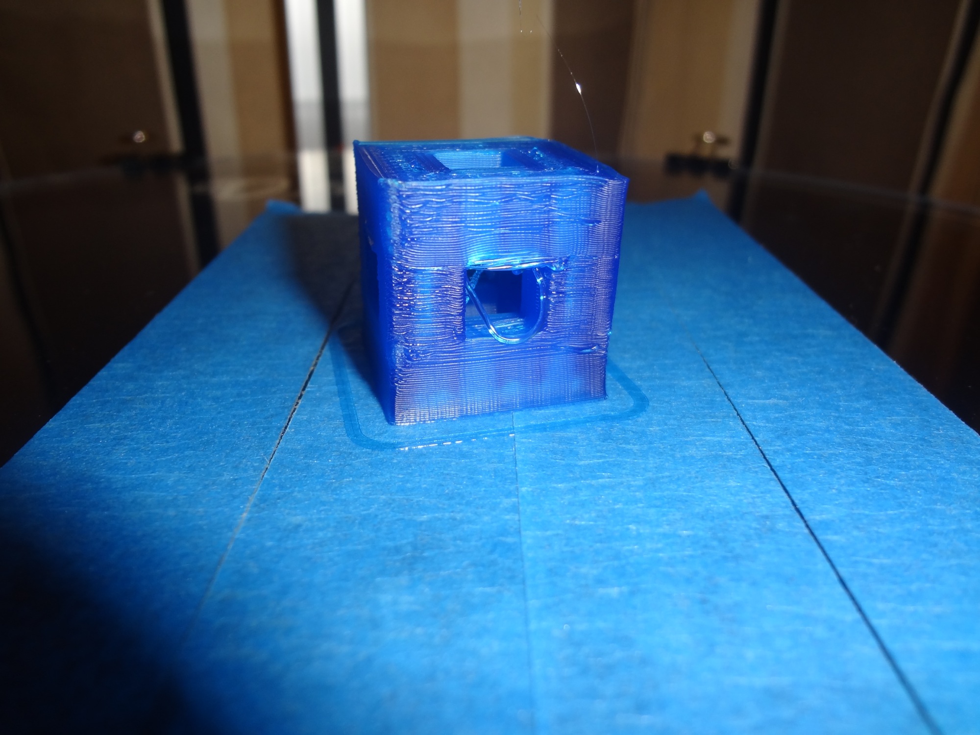

Whoot! I'm officially a "Maker" :D I got everything calibrated from the manual and then printed the calibration cube. This is with SeeMeCNC Blue PLA. Here are the prints with the piece still on the bed.

Anyway, I'm super excited that my first print came out fairly decent. Any suggestions on what needs to be tweaked to get nicer layers after the first few would be appreciated. The bridges certainly had some problems with drooping filament (temperature too high?).
Re: dpmacri's Rostock Build
Your temperature may be a little high but you may also add a fan that cools the part as it is being printed.
Many users just use a 40 or 80mm or so fan and place it on the base so that the air blows on the part. I would
connect it to a connector so that it can be removed. The connector would be controlled from a manual switch
that goes to the power supply. You will read about such fans many times as you scan through the forum topics.
