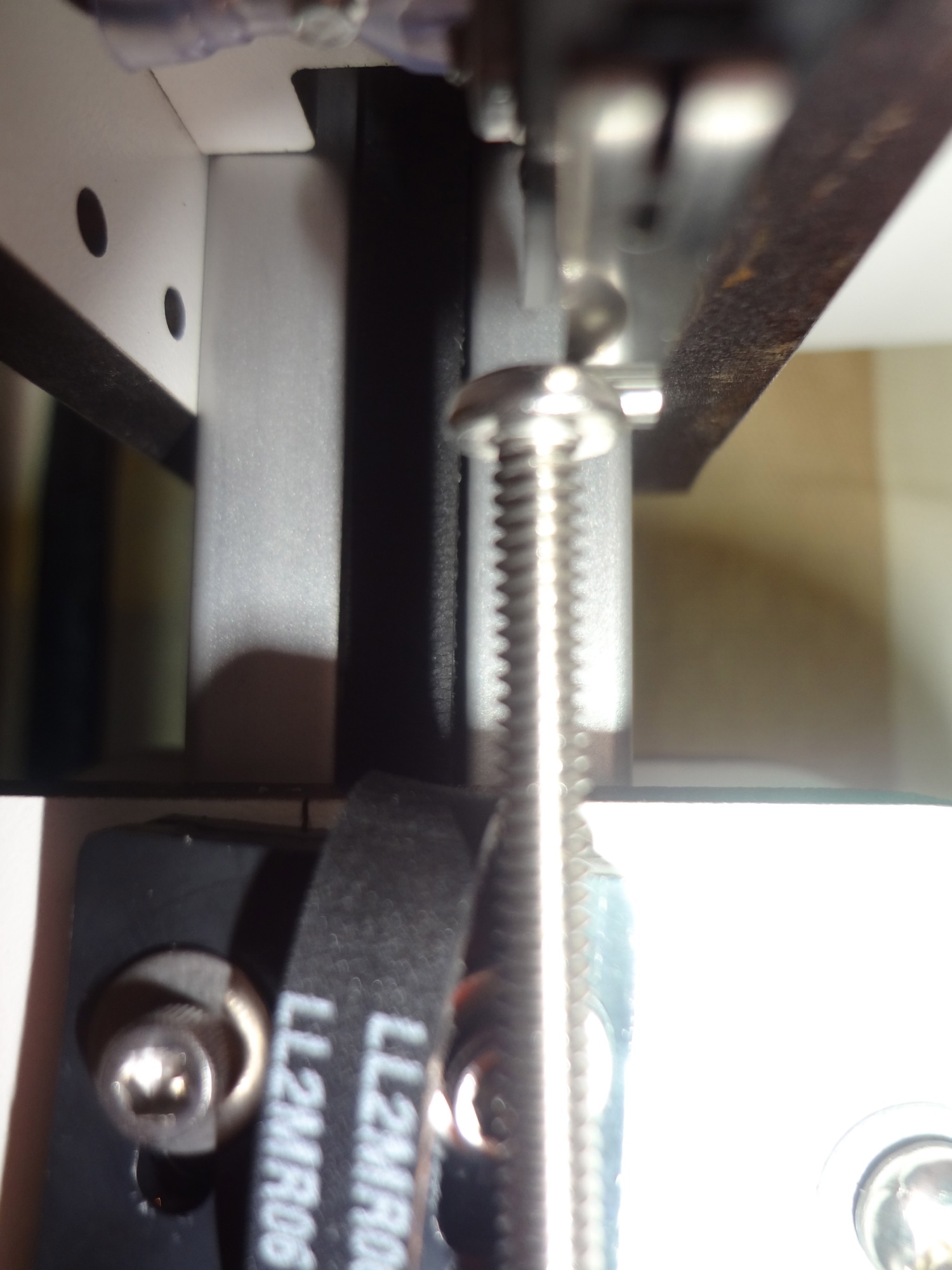

If you made no other changes, then depending where your endstop screw makes contact with your microswitch at the top, you can get inconsistant zero positioning.

What should they look like? Here are pictures (sorry the Z is blurry -- hard to take these closeupslordbinky wrote:If you made no other changes, then depending where your endstop screw makes contact with your microswitch at the top, you can get inconsistant zero positioning.

I went ahead and moved my end stop switches to the middle 2 screws where they mount. Now the end stop screws hit the switches right where the actual button is rather than out on the end of the lever. Now my height calibration seems to have stayed correct even after a cooling/reheating cycle.
I think I may have also made a mistake the first time around. Last time, I had issued G28 *before* I changed the EEPROM/Printer Settings values. I think that may have caused the printer to think it was at a different height.
Anyway, I'll report back if I still have height problems, but thanks for the help!

That bump threw mine off too so I moved it back one hole so it makes contact with the flat part of the microswitch arm, it isn't quite the button itself but it was enough to fix consistency problems for me. Enough so that I stalled my plans to move to magnetic endstops.

Actually, it just occurred to me that a more "ideal" switch for this usage would have the arm reversed such that the screw hits near the hinge and the button is out on the end of the lever. That way a smaller motion in the movement of the carriage would trigger a larger motion on the buttondpmacri wrote:Good to know! Thanks, LordBinky!lordbinky wrote:That bump threw mine off too so I moved it back one hole so it makes contact with the flat part of the microswitch arm, it isn't quite the button itself but it was enough to fix consistency problems for me. Enough so that I stalled my plans to move to magnetic endstops.
