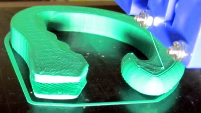

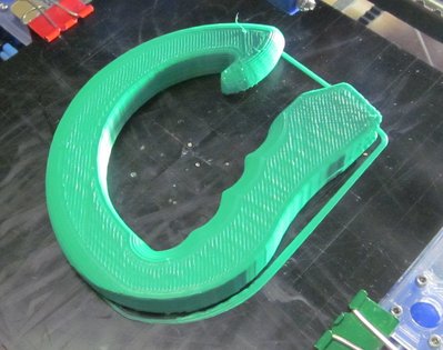

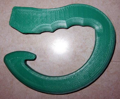

Printed this for the wife for Mothers Day.
To bad the ends curled up and split open....sure need a HEATED bed guys!
Also stuck so hard to acrylic build platform in some places that part de-laminated on bottom side when I pried it off with a sharp putty knife.

Yeah for ABS a heated bed is a must, specially for large item like that. The print looks good otherwise.
How strong is the print? Have you tested to see how much weight you can put on it?
