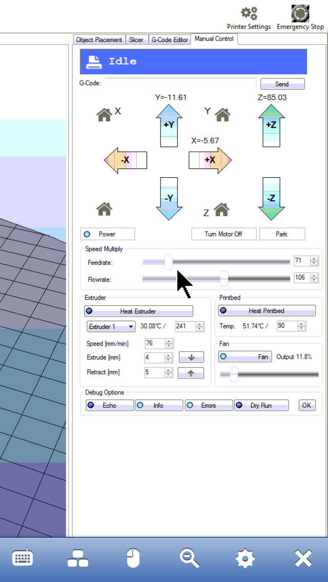

I'm still fighting this bump noise coming from the EZextruder stepper motor slipping. I thought my hot end temp was too low not allowing the ABS to melt and squeeze through the hot end fast enough thus cause a pressure buildup on the EZextruder stepper, but I've since set my hotend at 241 Celcius constant and the bump noise hasn't stopped.
I find that if I slide my Feedrate slider in Repetier Host down to 65 or 70 it seems to do it less, but prints take much longer. And any time the printer needs to lay down more plastic it begins to slip again almost every 7 seconds. What could this be? Can I achieve higher speeds and not "bump"?
http://www.youtube.com/watch?v=N2Zi7toq ... e=youtu.be
note: another symptom I have is that my outer perimeters don't seem to meet unless the speed(Feedrate slider) is down around 70 or 80.

The skip happens throughout the whole print. It occured so often in my latest print that it cut the ABS plastic where the teeth of the stepper motor comes in contact with the filament. I took my hot end apart and pulled out the transparent tubing inside. It looks like this:
Is that buldge normal?

Well I couldn't wait, I went ahead and replaced the smaller transparent high heat resistant tube with some other of the exact same type I had and it looks to have solved the problem.
1. Feedrate slider is at 140
2. Flowrate is at 89, which I've had to keep at 115 or higher
No bumping and the plastic is flowing fat! I'll have to recalibrate my flow. Finally.
