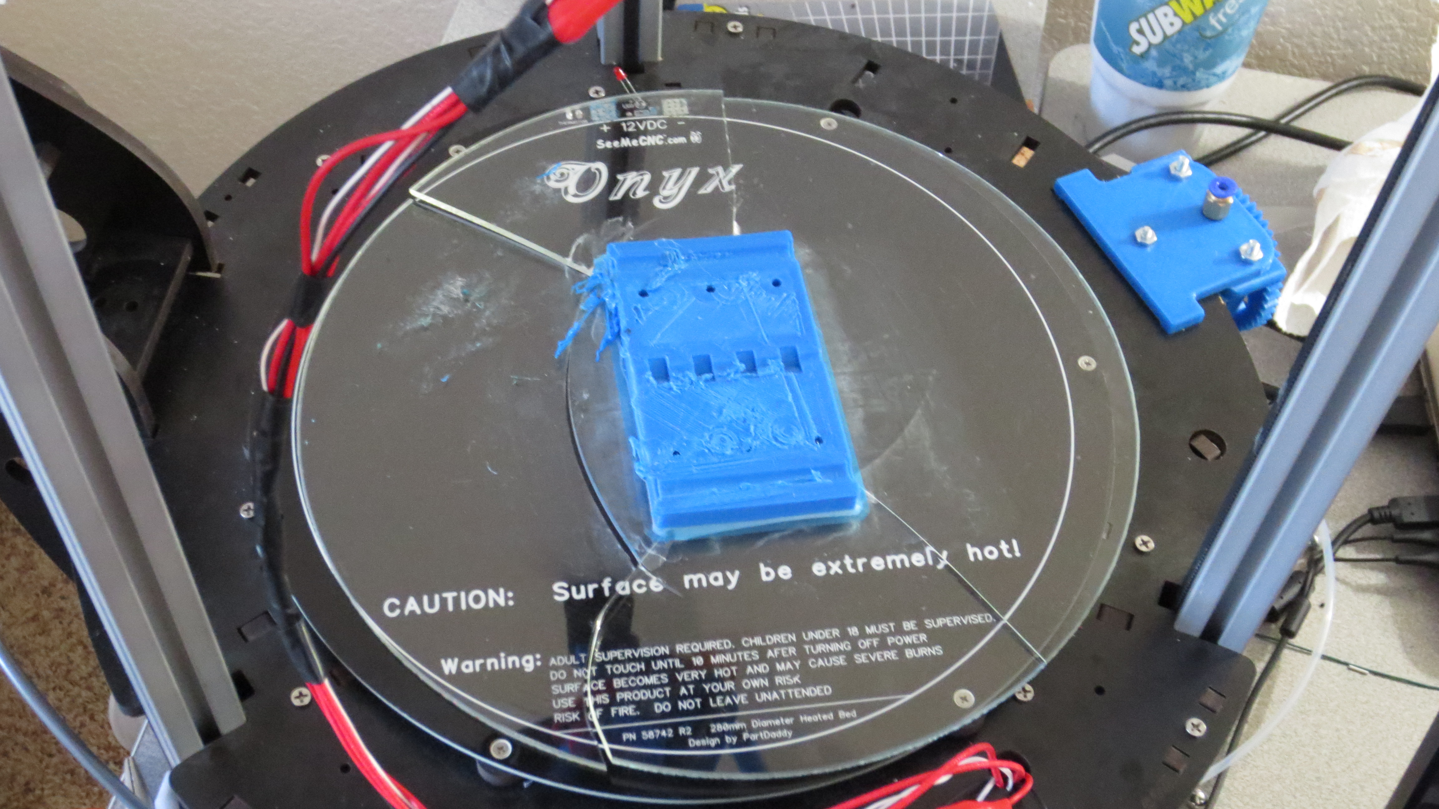

I'll just say that trimmer line works great for just about anything mechanical. I've printed gears down to ~10mm in diameter and 0.2mm thick that worked, and so far none of my nylon prints have broken from mechanical use. They don't wear like other stuff, either.
There is a drawback that I just figured out yesterday;
Nylon does generate some force on the build surface as it contracts from cooling, but this was unexpected. I have printed larger objects than this before with no problems. All of them have been held to the glass surface with regular glue stick, which means that the glass that seemecnc sells is both overpriced and low quality. It was weaker than the glue stick that stuck the part to it. When it cracked, it jerked up and smacked the hot end so hard that it knocked the magnetic ball joints out and luckily didn't break the E3d hotend. This print was at 260 degrees with a 40 degree heated bed.
In the mean time I bought a $6 12" mirror from hobby lobby that's just as thick as the borosilicate one. I'll try to get a replacement from seemecnc this week, but this incident makes me wary of printing larger objects on 1/8 glass plates. I might try 1/4 or 3/8 next time....
Don't be discouraged from using trimmer line by this. I've gone through ~5 lbs of nylon without any problems. ABS would probably do the same thing since it has a similar coefficient of thermal expansion.
Moral of the story:
Get a thicker plate. At least until we can get glass-filled filament that contracts much less.
