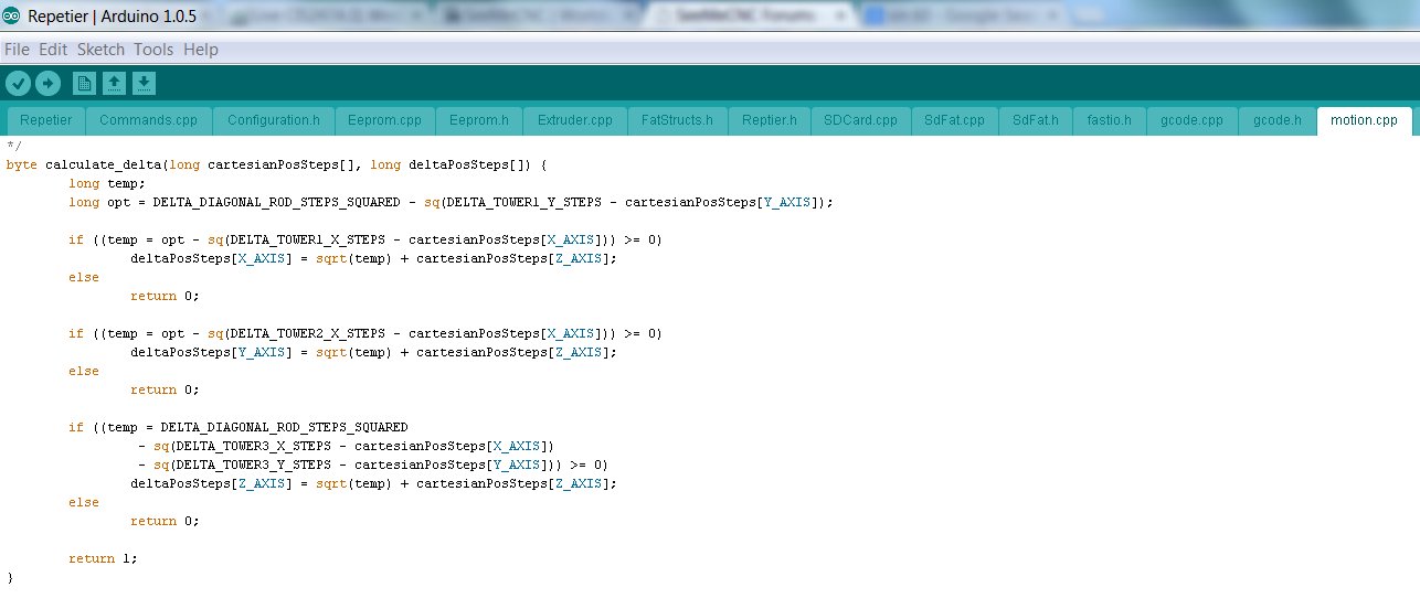

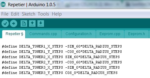

Unfortunately this did not work for me. I went through the process of stepping through different SIN and COS values in the DELTA_TOWER_STEPS equations, but nothing had an effect on the thin spots on the left and right side of my print. Maybe I'm doing something wrong?
I have the DELTA_TOWER code in Repetier Version 0.90C and I substituted decimal equivalents for the SIN and COS values in the equations shown below as I was incrementing by +/-0.1 degrees up to +/- 1 degree:
and the DELTA_TOWER values appear to be used in motion.cpp:
Please let me know if you have any suggestions. Thanks.
Mitch

I'll spend some more time looking at your case probably tomorrow, more specifically the Repetier code. But to be sure, you were re-calibrating the end-stops with each adjustment of the tower positions, right? Along with that, possibly adjusting the DELTA_RADIUS as needed? Every parameter adjustment requires a full re-calibration from the beginning to ensure the full effect of the adjustment.inventabuild wrote:Please let me know if you have any suggestions. Thanks. Mitch
I had a sneaking feeling that this would turn out to be a "works for me" situation
Edit: Also, be careful with your version numbers. Your mention of 0.90C is likely the version of your Repetier Host (on your PC). You are most likely using v0.83 of Repetier-Firmware on your RAMBo or whatever.

It seems that the v0.83 Repetier-Firmware code should apply the tower position changes just fine.
I'm not really sure of what else to say without knowing the answers to the couple of questions in my previous post: were you re-calibrating the end-stops after each parameter adjustment?
Also, can you post exactly the modified #define statements that you used (at least one for example)?

For anyone who was following this thread - it's not just Edward this works for! I fixed my printer by rotating the Y tower one degree CCW. I think this is the solution I've been looking for for months.edward wrote: I had a sneaking feeling that this would turn out to be a "works for me" situation
Edit: I'm trying to get this implemented on Repetier, but the newest version has been changed so that there's an assumption that the towers are all 60 degrees apart. I've filed an issue. If you're using Repetier and your printer acts weird near the edge of the build platform, that would be the place to chime in.
