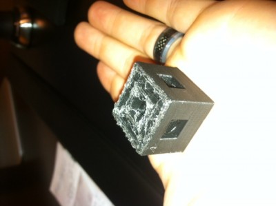

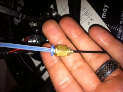

My hot end seems to be clogging up and jamming causing the extruder to skip. When this happens the quick disconnect at the top of the hot end gets jammed as well making it impossible to pull the filament out of causing me to have to buy another quick disconnect. This has happened twice now and there is a reason for it. I have followed the directions to a T and so this shouldn't be happening. If you have had this problem or can help me I would greatly appreciate it. Thanks

I found out through trial and error that the photo shown in the instruction document was incorrect. The peak fan should have been plugged into Fan 0 on the RAMBO not Fan 1.
Re: Hot End Jamming!
Well considering I wrote the documentation, I know exactly what I specified and why. You're perfectly welcome to assemble it however you like, but don't come crying to me when it doesn't work.
FAN 0 is for the layer fan, FAN 1 is for the PEEK fan.
