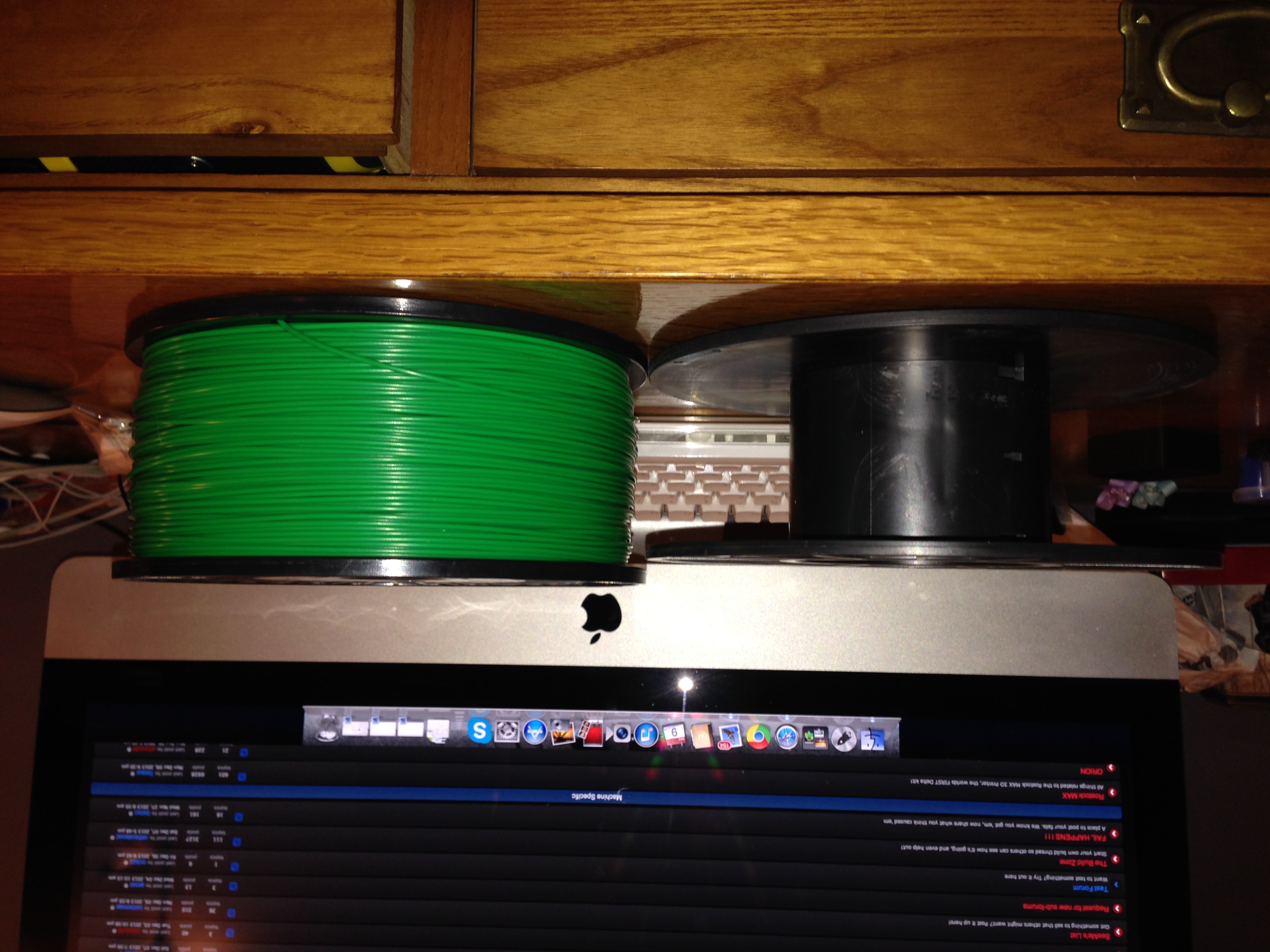

1) The spool is different from what we are used to so some modifications to the max are required.
2) The spool is slightly wider than the SeeMeCNC spool, so the extension pack from thingiverse is required. (Here is an extension made by one of our very own members!!! http://www.thingiverse.com/thing:60322)
3) The hub also has a different diameter so if you want the spool to fit snugly on the rod, you will need to create a modified hub. (If I create one, I will post it.)
Thoughts…..
1) It is a shame that the spools are not Plug-n-Play for the max, but since there is no current industry spool standard…… It is what it is and other filament brands could have the same issues.
2) Botfeeder posts the dimensions on their website, so I knew about this issue when I ordered.
3) This should not be a deal breaker in my opinion, after all the whole reason you have a 3D printer is to make stuff.
Thoughts…..
