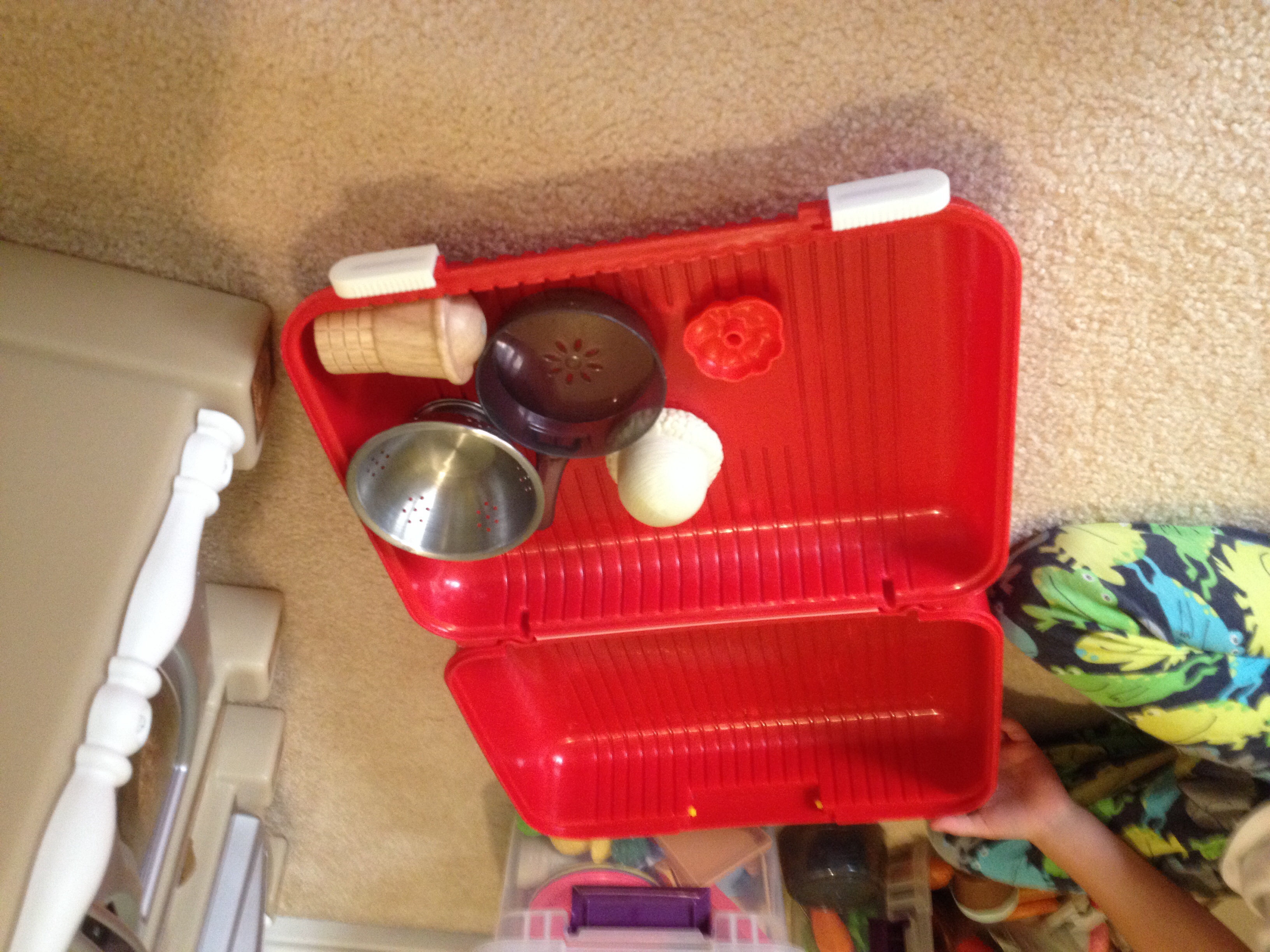

My kids have a small "suitcase" made of plastic that holds a toy picnic set. The catches for the case had broken a while ago, so I thought I'd try modeling and printing replacements. I took some measurements of the existing broken part using digital calipers and then modeled it up in FreeCAD. A word to the wise, save often if you're using the 0.13 version on Mac. The "chamfer" option sometimes causes a crash :-( Anyway, I was able to print two replacements in white ABS. The picture shown here has the original part (in yellow) and the two replacements still on the bed. Of course, I forgot one thing when I modeled these: ABS shrinks :-P! They fit the case so tightly that my kids can't move them!! Anyway, I'll be tweaking the model slightly to get something actually usable ;-)
Sorry for the poor picture quality. I took it with my iPhone and lighting was pretty poor.

I increased the size slightly and reprinted. Here's the final parts in use:
Closed case with 3D printed latches
Open case
Open case
No idea why they're upside down in the post :-P

Was your phone upside down when you took the pictures? I've noticed that even though the screen auto rotates, the exif data won't be updated, so the images will be wrong. Had to reencode a video because of this once.
