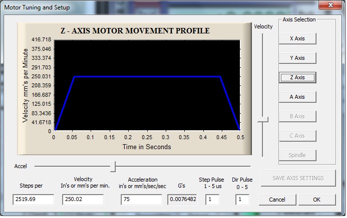

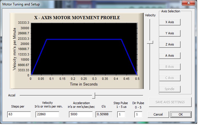

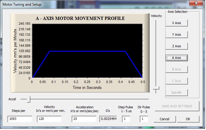

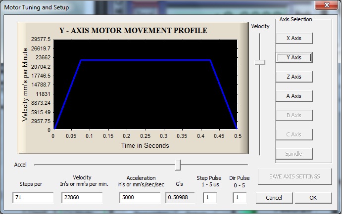

Below are my Motor Tuning Profiles. They turned out to be double of that of mhackney's configs. I also had to reverse the motor direction for the correct + and - direction.
Mtizle

You probably have your 34 Axis board configured for a different micro step than I do, that's why your steps per are doubled. I think I have mine configured for 1/8 stepping. How is yours configured?

No idea what the stepping is... is that configured on the board by the jumpers? My jumper settings came from Steve's with Seemecnc. So you think it could be set to 1/16 micro step right now?

Tizle, yeah, the board you looked at up in the lobby was 1/16 stepping.
