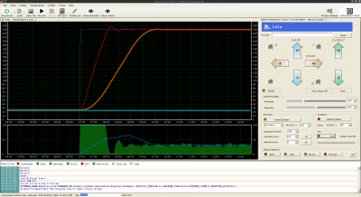

The asterisk for the PID loop is because I don't use the SeeMe hot end anymore. Someone who does can tell you where the duty cycle (% of time turned on) should be in Repetier. That's the lower of the two curves in the Temperature Curve tab. I have an E3D hot end, and when I've had some issue the duty cycle has often been 50-80%. The usual duty cycle is 25-35%. When it shoots up too far above normal, it means something's wrong and you're likely to have critical melt creep sooner or later. The automated PID tuning you get with Repetier is okay but not that great. It produces a duty cycle that looks like an earthquake on a seizmograph. For even heating, it should look more like the profile of a gentle mountain range (see attachment).
I got a lot better at PID tuning after I read this: http://www.pcbheaven.com/wikipages/PID_Theory/ (way more useful than the Wikipedia article)
Repetier also has a "dead time" heat manager that you can elect by changing the heat manager in EEPROM from 1 to 3. You have to be using a newer version to get that feature. Information is here. I don't like it as much as PID tuning beacuse the duty cycle curve can be made a lot flatter with PID.

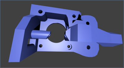

I went ahead and modified the airtripper design to bolt to the EZ-studer mount. Actually, I started with the BI version since I only have 608 bearings on hand. Here's the link to that mod.
http://bootsindustries.com/portfolio-it ... i-edition/
Here's mine.
And here's the stl, in case anyone wants to try it out.
I didn't change the bearing holder at all. I am printing it now, and I'm hoping it will let me go faster than 30mm/s.

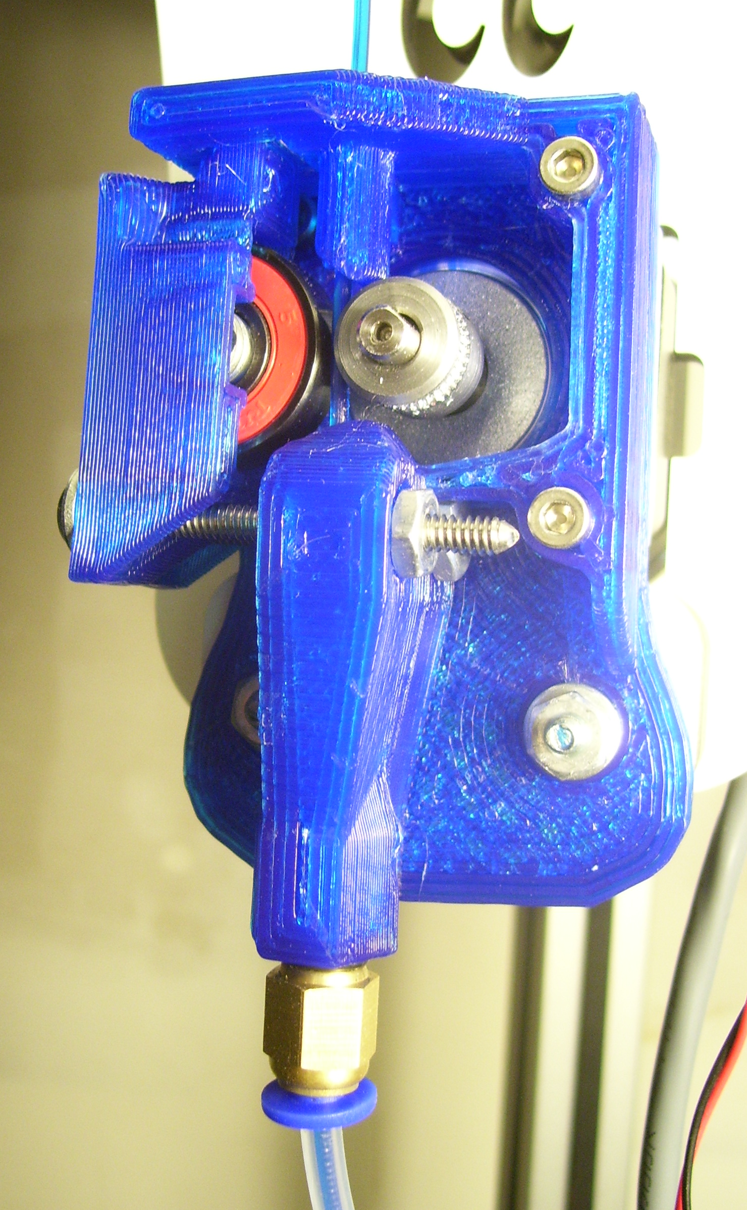

Here's my printed extruder.
I had to make a few changes to my first design. The mounting holes were a little too low. The gear that the airtripper uses is a smaller diameter than the mk7, so the filament path was too close to the gear. I had to slide everything over so the filament wouldn't curve around the gear. A few things could still use a little tweaking, like the size of the nut captures, but this version is working well for me.
From http://reprap.org/wiki/Rostock_MAX
I usually print at a 0.4mm layer height, and I haven't been able to go any faster than 30mm/s. I tried a layer height of 0.2mm and was able to do 40mm/s. I guess the EZ-struder is working as it's designed to, but it's just far to weak for the speeds I want to print at. The lack of a tension adjustment makes it much worse than it could have been. My printed extruder is already outperforming the EZ-struder. I brought the stepper current back up to 195, tightened down the filament, and printed a solid 3cm cube at 40mm/s with a 0.5mm layer height. No skips. Now that I've added an adjustable tensioner, the speed limit should be determined by the torque of the stepper motor. I'll have to do some more testing to find out what that limit is. I've switched back to the freshly cleaned 0.5mm nozzle now, so I can get some detail back into my prints. I measured the extruded plastic at 0.45mm. I know it should shrink to be less than 0.5, but does that seem low to anyone? I'm going to set the nozzle size at 0.49mm and see if I get better results..2mm layer height is a good general thickness for all around printing. If you slice at thicker layer heights, you may need to slow down, to around 30-35mm/s for .3 and slower for thicker than .3 layer heights. This is mainly due to there being a lot more filament being extruded at that layer height.
