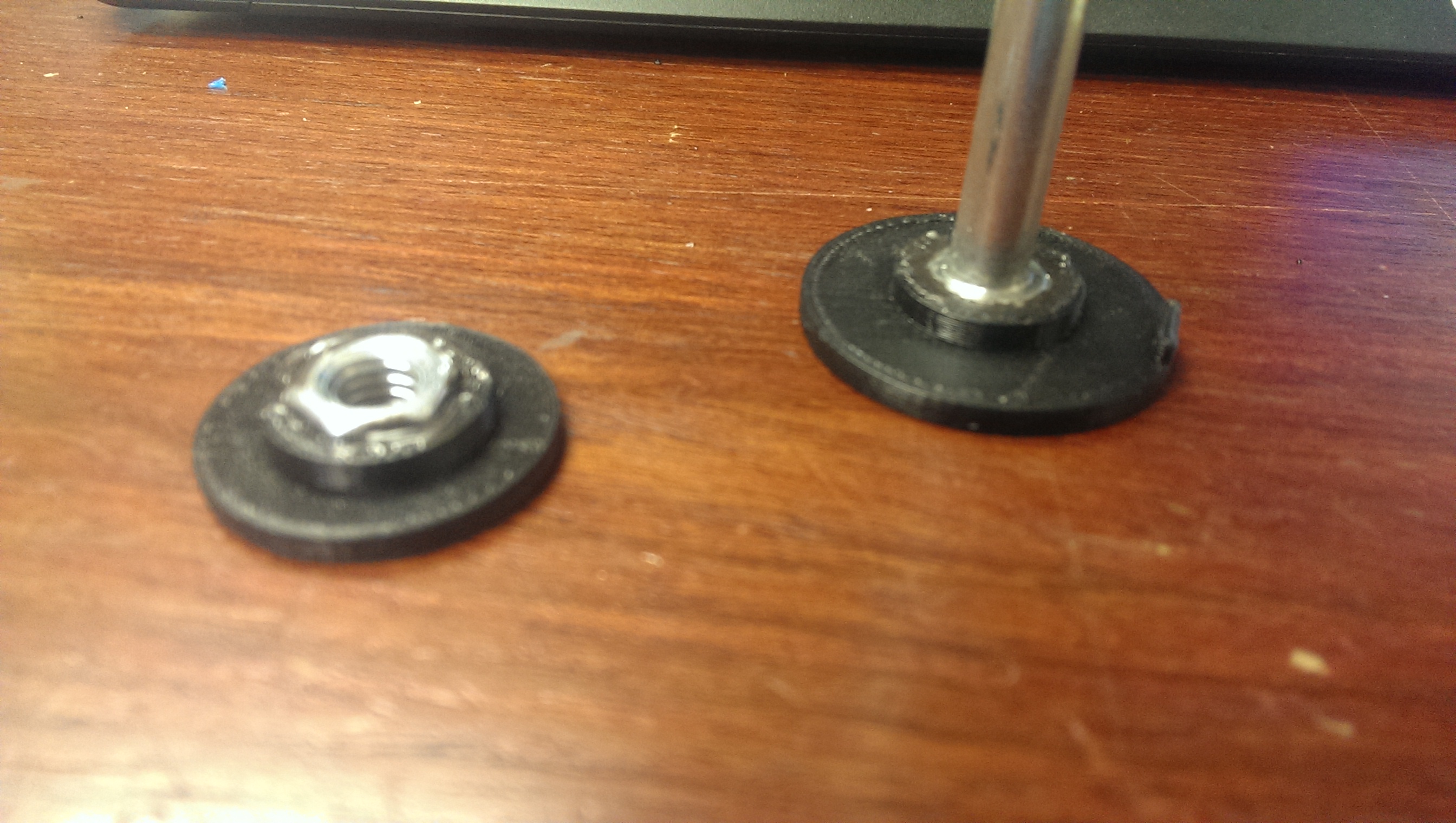

No, and we likely won't make one to fit it because it's a size that's really not used by the community. I do, however, have a part we made to easily respool that trimmer line with a drill. You can print one yourself. Just need a shoulder bolt to go with it.
Also, it's virtually impossible to dry the whole trimmer line spool without a vacuum oven. I would highly recommend you spool into 1-1.5lb amounts and dry. I tried 2-3 times - once drying at 180F for 24+ hours, but never could get the innermost parts of the line dry.

Could you give me an idea what the respooling part looks like to give me an idea what to make? After I get the respooling done and it works okay, I will be buying the box but I wantcope413 wrote:No, and we likely won't make one to fit it because it's a size that's really not used by the community. I do, however, have a part we made to easily respool that trimmer line with a drill. You can print one yourself. Just need a shoulder bolt to go with it.
to make sure that I can respool the big guys first.

This is the first one I made for using MatterHackers' spools. I have one for Taulman and for Ultimachine spools as well. Basically just a shoulder bolt in a little flange that locks into the spool and centers it. I grinded a small part of the threads off the bolt so that it seats well in the drill chuck.
I put the filament on one of these that's mounted in a bench vice.
Empty spool on the drill, and you've got a super easy respooling setup.
I can post the files for the parts later if you want them.

Now it makes sense, I shouldn't need more files posted, I just needed the general approach to how you did it.
I can handle it now. Thanks, I'll give it a try in the next couple of days and then let you know about the box
you made. I hope you got my PM for the nozzles.
