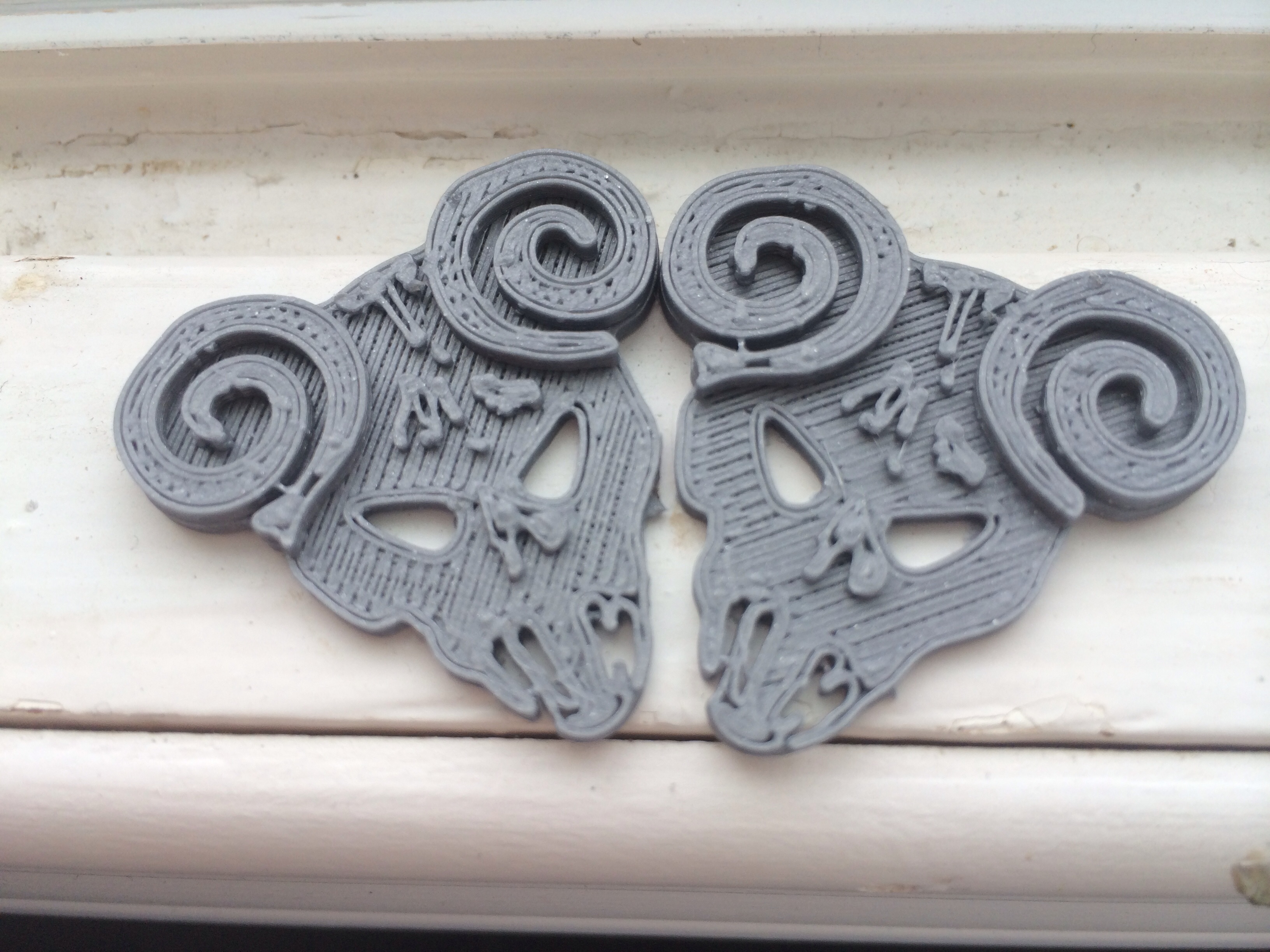

Based on this picture can anyone tell me what is wrong?
The grey filament is from the same place ( Voxelfactory ) as the white, the grey one is not filling in, filament seems thinned out.
Seems when I updated the newest firmware I've been having worse and worse problems.
Only perimeters turn out great.
I'm using the J-Head as the stock Seemecnc was leaking too much ( got my Rostock Max in the Kickstarter ).
Used same J-Head on both white and grey prints.
I've recalibrated, redone PID, took extruder apart and re assembled, checked cheapskates, belts, everything possible nothing is changing. Printed this grey item at 218, 225 and 229 degree's. all the same.
many thanks in advance

Looks like the grey filament is either slightly smaller in diameter or has a slightly different flow characteristic. I'd try lowering the filament diameter a little bit and seeing what happens.

Thanks MSURunner I'll do that now! I measured with my digital caliper and averaged I'll lower it and reprint.

Keep in mind, too, that different dyes can affect the PLA and it's flow characteristics. It's not uncommon to have to change the flow setting/filament diameter to match different colors of filament.

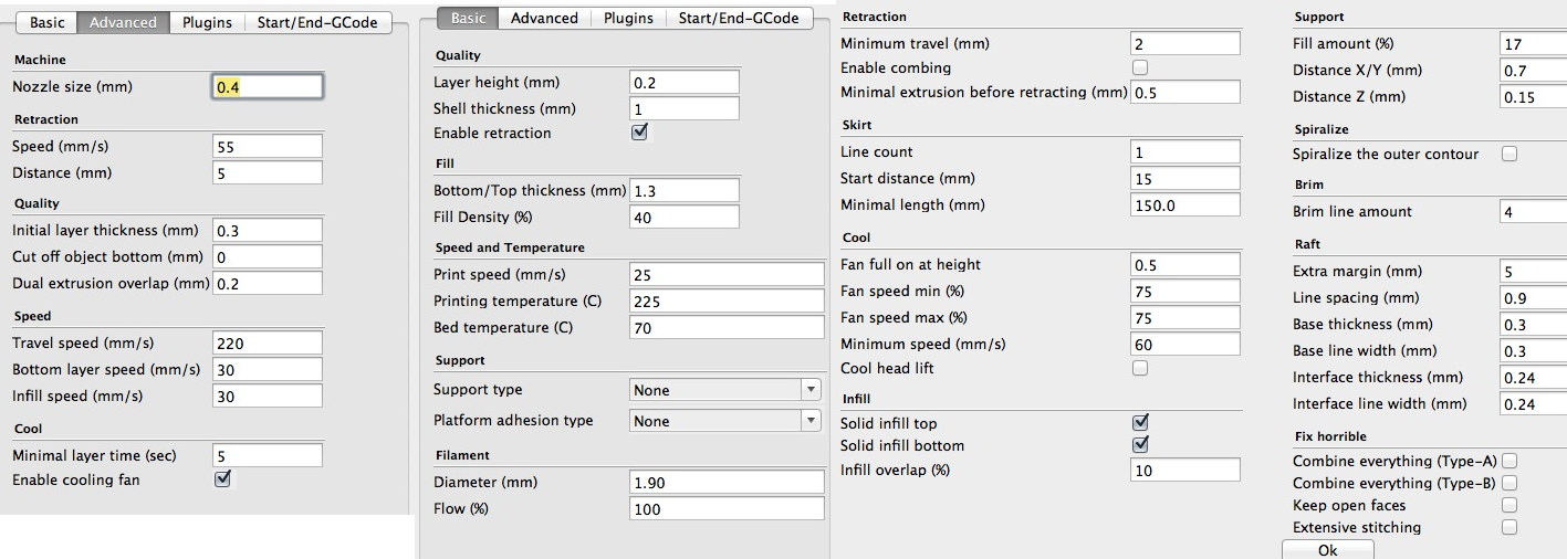

Ok reduced to 1.8 from 1.9 and upped the temp to 230
A minor improvement ie check over the nose area but still odd.
Perimeters always look great.

That has the appearance of a slicer issue to me. Which slicer are you using? Slic3r, when mandating a set extrusion width, doesn't have the ability to fill those gaps where it cannot create another loop. KISSlicer and Cura both have features built in to fill those "thin wall" issues. I think you need to reduce your filament diameter a bit more, though, looking at the solid infill for the face and the fact it's not connecting the infill to the perimeter loops. I cannot speak for 1.75 mm setups, but 3 mm filaments, particularly PLA, generally measure in at 2.8-2.9...

MSURunner looks like you were right! I put it down to 1.6 and this is the result! Might back it off to 1.65 or 1.7 as it's a little blobby but filled!
I just hope my nozzle doesn't squash my prints I still have that problem when they get higher
thank you again so much, you hit it right on the head!!!
Hope this helps other people with the problem, I never would have guessed colored filament make such a difference

Sweet! I'd say 1.65-1.68 will do the trick looking at your pic.
