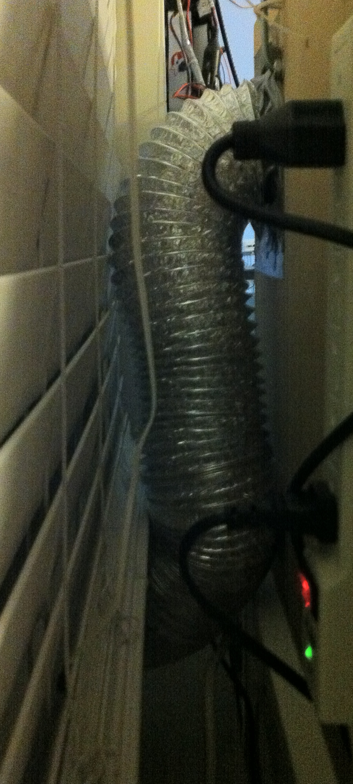

I spent a day constructing a box to contain my H-1 and help exhaust the fumes during print. The box is made out of 1/2" MDF, so its build to take a beating.
Kinda looks like a MakerBot, only cooler ;-).
Features:
* See through front window made from plexi glass, 1/4" thick, completely removable, held in place by 4 magnetic catches
* Removable top - allows for easy access, I plan on adding a handle for ease of removal/installation and a 13"x17" 'window' so that I can look inwards from the top
* 120mm exhaust fan connected to a dryer vent pipe going out the window, I need to print a 120mm cowl, but until then duck-tape will do
* roomy work area allowing for on the fly adjustments of H-1 without removing
* H-1 completely removable if I need to take apart, modify or upgrade :-), just unplug the electronics, lift off top and lift out H-1
* All power supplies/non-control hardware housed in separate compartment below H-1, I have a separate power supply for fans and CCFL lighting (soon)
I also plan on adding fan speed control, CCFL on/off and brightness control and others upgrades as I come up with them.

Your exhaust fan is too big, you're probably cooling down your chamber way more than you need. The commercial printers use around 35c chamber temperature.
Here's a chamber I made with $4 of foam board from the dollar store
[img]http://i.imgur.com/ahjF5.jpg[/img]
[img]http://i.imgur.com/qgp5T.jpg[/img]
It keeps all the ABS fumes inside the chamber, and keeps the temperature at 35c during a print which reduces warping.
I'm using a cheap aquarium thermometer to monitor temperatures.
The $2000 machines require exhaust because they can print with materials that create toxic gases, like teflon. There's no need to exhaust the ABS fumes, but you may want to contain them.

That's a cute box. I mainly vent the fumes because they cause me a headache and its not the wife complaining about the smell that is the cause of the headache ;-). I was just running a RaspPi case print when I read your post about ambient temperature, I checked with my temp probe and it reads ~90F with the fan running full throttle (80CFM!!!). I will add speed adjustment controls to slow down the fan, probably will help bring up the temp.

Love the exhaust. How is it connected to the window? I'm trying to think up ways to control fumes from the MAX kit I have enroute. I'm thinking an enclosure and a charcoal filter with a large, relatively slow, fan. It was -20 here this morning, so uninsulated venting to the outdoors is probably a bad idea for me. :P

How about using a dryer vent to control the air flow direction? It would help keep the cold out and I would think a little bit of static pressure would help stabilize and slow the air flow.
