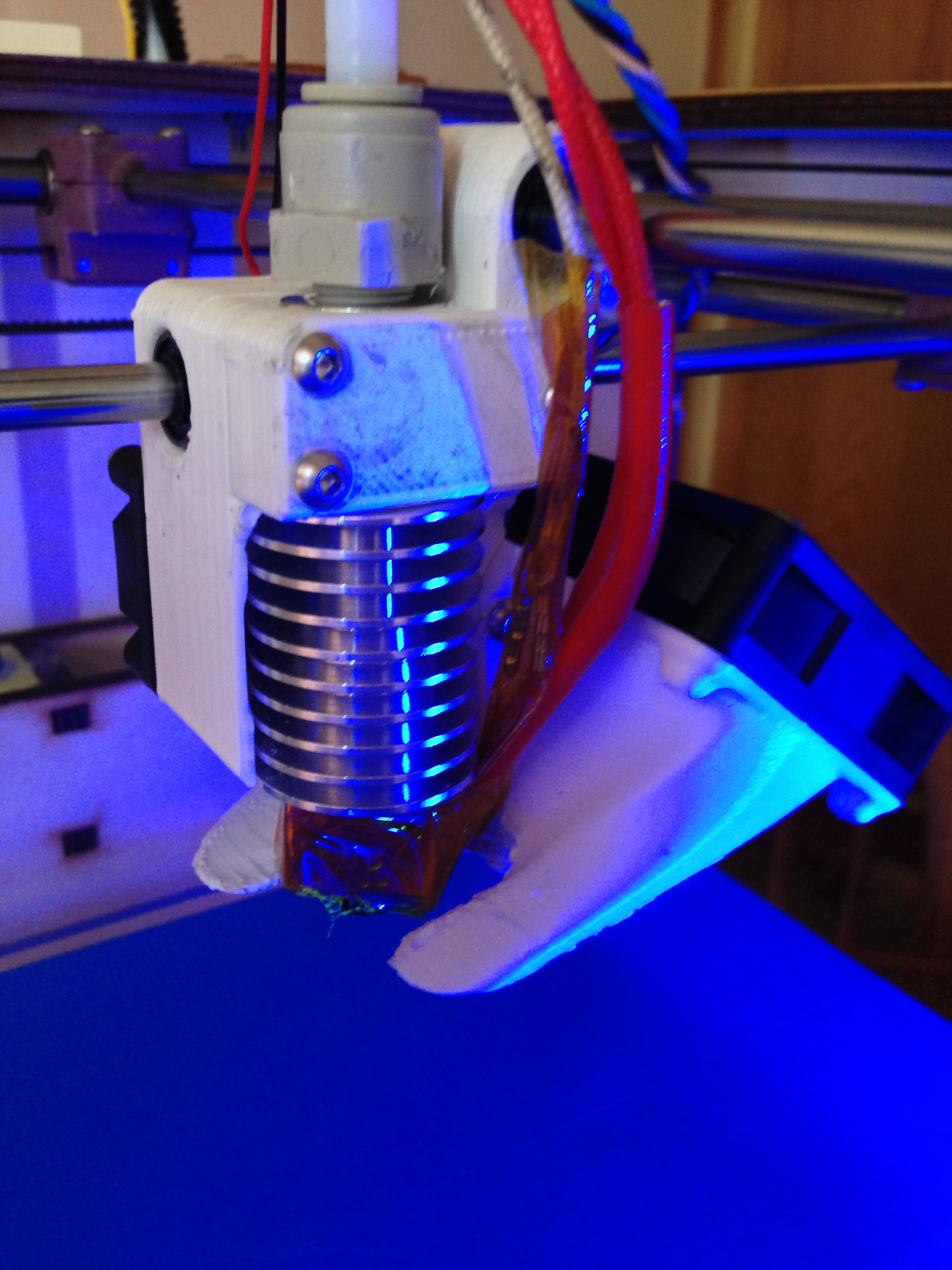

I have a Greg/Wades on the back and 2 fans on the E3d, the stock cooling the heat sink, and a 50mm for part cooling with a fan duct.
Electronics wise its a RAMPS in the back with a 40mm fan. PSU is a 12v 5amp laptop style one.
Ive been printing the PLA at 230, I have printed with this material (transparent Green PLA from SeeMeCNC, bought it at the Kansas City Maker Fair this year) before and gotten pretty good results, I've been printing with Cura lately, 70mm/sec, but I did some Slic3r printing before with it at 210C, but it was considerably slower.
The mount for the E3d is printed in white PLA, on the Ultimaker itself. The white required 250C, I think it was white Ultimachine, it worked pretty well, the only troubles I've had is with this green. I examined the PLA a bit and found a few spots with air bubbles nearly 2mm in diameter embedded in the filament. I wouldn't use the plastic, but its the only filament I have other than the Nylon (which I can't keep dry).
I'm installing a heated bed hopefully tomorrow so I can try ABS, but I don't have money to buy any plastic right now.
I'm using a .4mm nozzle.

Nice setup you have there Mike.
Re: Micron eme all metal hot end for Rostock
Thanks, I only wish it would work for PLA... or at least this green stuff...
