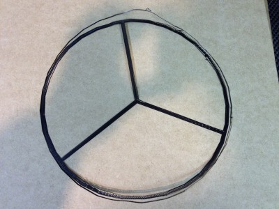

I am having an issue calibrating my max.
Here is what I have at the moment
X: =
Y: =
Z: =
X to Y: = ^^ =
Y to Z: = ^^ =
Z to X: = ^^ =
So things are fine at the towers and the center but all 3 in betweens are high, by a fair amount (plastic barely touches).
It seems that if I adjust all 3 tower rotations it would cancel out. Anyone have a clue what the issue might be and how to address it?

626Pilot wrote: Can you print out the Onyx calibration as it is now, then change one of your tower rotations by one degree and try again? Post both before and after images.
This is the before
So it seemed from x to y was the worst so I rotated the x by a - half degree. The result was x to y was improved, z to x bad to worse.

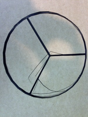

The phone rotated the photo so the bottom in the first photo is the left in this one.
So now z to x and y to z are both way too high and any adjustment I make to the z axis rotation will improve one and make the other even worse, just as the x rotation did to the z to y.
My guess is that there is something else wrong. I have trick laser carbon arms, does anyone with those arms know if that changes some other measurements?
