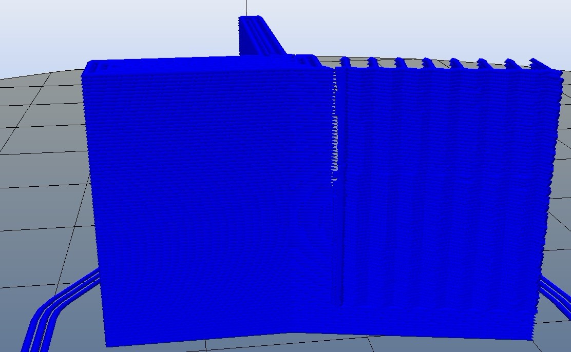

I have thin edge, and it is not straight, instead of 180", it is like 160".
When slic3r generate the wall, it does one at a time, therefore, leaving the gap in the middle. See pictures.
1. How can I tell slic3r to draw the wall in a single path/line?
2. How can I tell slic3r to generate 2 layers for the wall so it leaves no gap?
It is on ABS, I am following all the setting from the default. I did change the temp of ABS to 225, base 105.
edge not sealed.
edge not sealed.
only one line.

can you post the comment section from the slicer gcode file here please (it has all of the configuration parameters listed). Let's see what you did first, then maybe we can help "fill in the gaps".

Re: problem with thin edge
Bottom - especially corner - warping is due to the print lifting from the bed. The easiest fix for that is to print on a heated bed at least 100°C. I use hairspray on borosilicate glass and "it ain't coming off" until the bed completely cools - and even then I have to pry the parts up! Remember, even at 90° like you have, just a few centimeters from the middle hot zone will be much cooler unless you have a heat dissipator plate. So, bumping up to 100-110° will help keep the outer reaches a little hotter. Also, DO NOT use a part fan on the first 5(isn) layers. Then, use a fan on the part to cool the thin cross sections to keep them from sagging. Do not point the fan at the heated bed - you are trying to keep that hot!
Looking at your gcode:
; layer_height = .2
; perimeters = 1 bump this up to at least 2 maybe 3 depending on the thickness of the thin sections.
; top_solid_layers = 5 this seems a little high, perhaps lower it to 3. Shouldn't hurt anything but probably not needed
; bottom_solid_layers = 5
; fill_density = .2 a higher fill density, even 100%, for a part with this type of geometry might give better results
You might check that your STL file is "good" at that intersection too. I'm happy to take a look if you want to post or email it.

I attached the file I am printing. Having trouble removing the gap at the intersection in slicer.
Thank you
zhun_fix.stl
(25.38 KiB) Downloaded 455 times
[img]http://mhackney.zenfolio.com/img/s5/v12 ... 2761-3.jpg[/img]
See the dimension I marked - at .49mm thickness here, you will not be able to print this with a .5mm nozzle. You'd have to drop down to a .35mm and even then, you likely will not get a good print. Can you redesign that feature?
