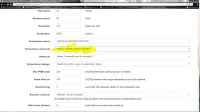

alright so i got both exturders moving, i am having issues when i switch to the second extruder with the displayed temp... it is showing 74 degrees when it should read 20 like the 1st extruder. they both are identical, i have totally switched wiring and it reads the correct temp so the wiring is good, the thermistor is good, i think i am missing something configuration wise now. i am running newest firmware, i did not have to change heat_1 to pin 7 in the pins.h it was already set.
Re: Dual extruders
inside pins.h
#define TEMP_1_PIN 3
but on older pins.h i found in the forums
#define TEMP_1_PIN 1
ill switch this when i wake up to see if it helps
i currently have e0 hotend in t0, and e1 hotend in t1, and heatbed in t2

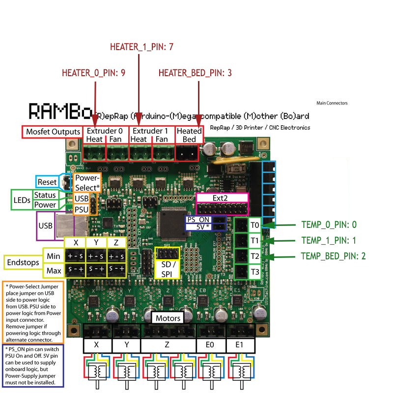

bubbasnow, I am at about the same point getting 2 heads on my Kraken working under Repetier and RAMBo. I had 2 SeeMeCNC hot ends working early last year but now running into what are probably config issues. I have a RAMBo v1.1 board. Here is how I have my hot ends and bed heaters and thermistors connected with their pin assignments in Pins.h:
The pins assignment I verified from the RAMBo wiki here: http://reprap.org/wiki/Rambo_development

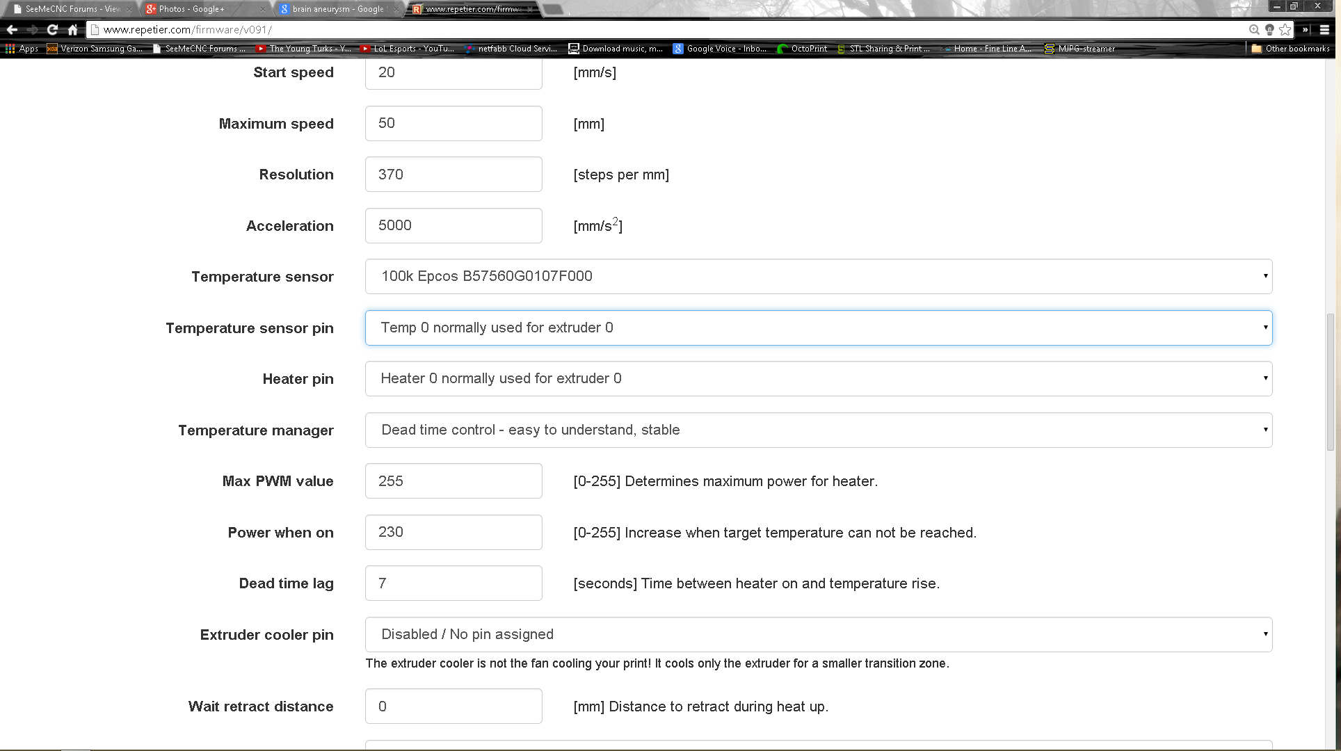

something with seemecnc's firmware is really fighting me on this dual extruder.
i went and used the configuration tool to build a fresh copy, hooked hotend1 to h0 heat pin and its thermistor to t0, hooked hotend 2 to h1 and its thermistor to t1. i can control them perfectly in RH. i need to do a line by line and import the exact dimensions into this new firmware and i should be cookin with gasoline this afternoon.
Re: Dual extruders
Hmm, I am using the .91 directly from Repetier and having problems. Could you post your Configuration.h please? I did not use the configuration tool - I've started a few times and get bored after 15 minutes of trying to figure not what's what. He does not use the same names in the tool as the #defines in the Configuration.h file for some things.
Also, what pins are you using for heater 1 and thermistor 1?

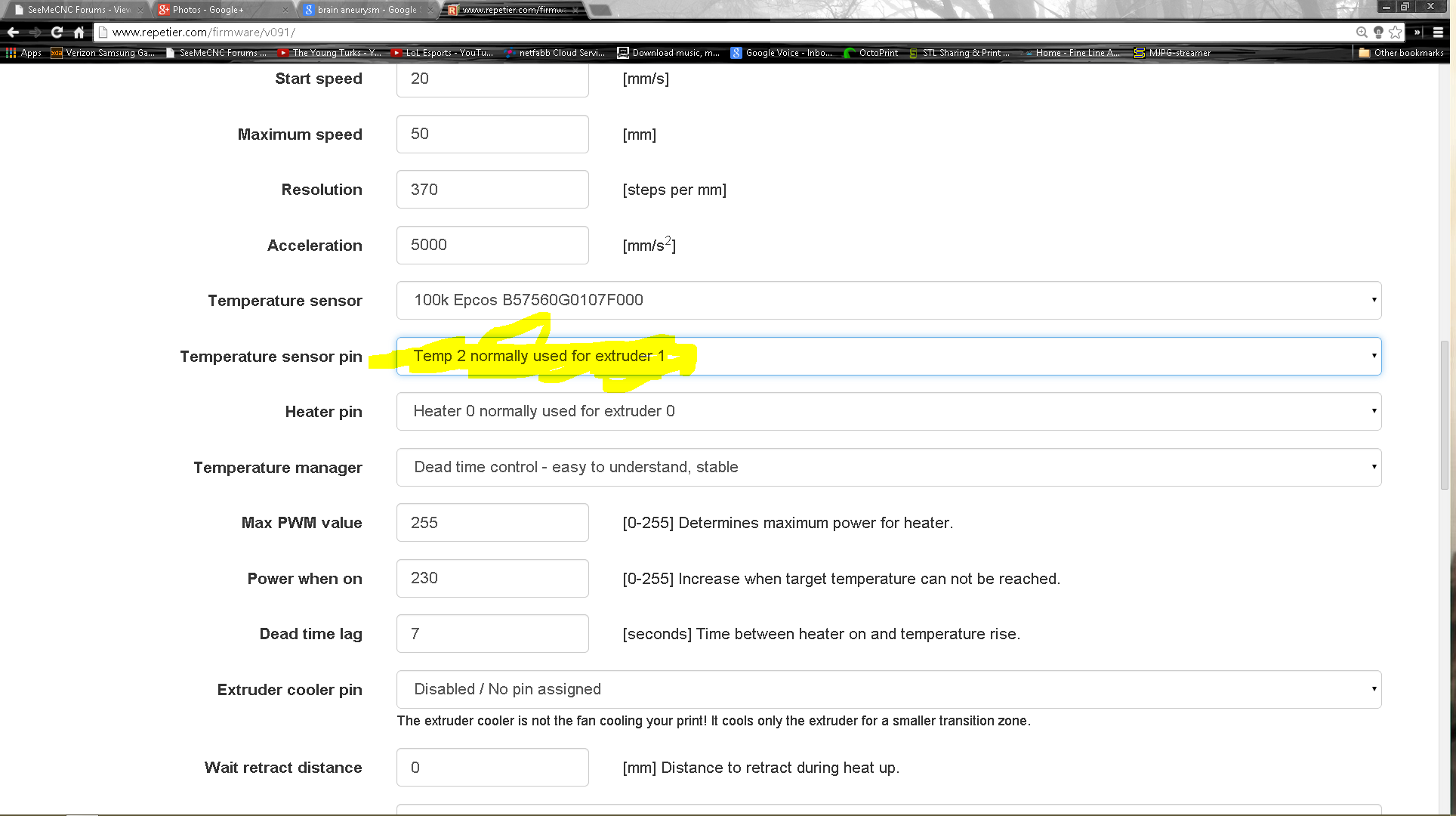

alright i have it wired like this
[img]https://lh3.googleusercontent.com/-F2bO ... 152309.jpg[/img]
i have extruder 1 on heat0, extruder 2 on heat1, bed heat 2
temp 1 on t0, temp 2 on t1, bed t2
i took a fresh seemecnc firmware and modified it as follows
configuration.h
pins.h
note in the configuration.h i changed
from default 7 -> 8 because it was stopping extuder 2 from heating.. heater_2_pin was also 7 so i think there is a conflict.
make sure the drive is enabled in configure.h also
then i connected RH and setup the printer with 2 extruders, and updated the eeprom and made both extruders the same.
now i can control them all

Code: Select all
#define HEATER_BED_PIN 3
#define TEMP_BED_PIN 2
#define HEATER_0_PIN 9
#define TEMP_0_PIN 0
#define HEATER_1_PIN 3
#define TEMP_1_PIN 2
#define HEATER_2_PIN 7
#define TEMP_2_PIN 1
Code: Select all
#define EXT0_EXTRUDER_COOLER_PIN 8
Code: Select all
#define MOTOR_CURRENT {175,175,175,200,200}

I got most of my work done so I played around with the printer a bit more. I hooked the cabling to Hot End 1 to the Hot End 0 output to see if the wiring is an issue. Nope, the hot end heated up just fine in single extruder configuration.
So:
I know my wiring to both hot ends and thermistors is fine since each works just fine when connected to hot end 0 terminals on Rambo.
And, I also reconfigured repetier to tell it to use TEMP_1_PIN and HEATER_1_PIN for extruder 0. This is the cross test as they say. And it works fine.
Therefore, I CAN run either hot end in single extruder mode from HEATER_0_PIN and TEMP_0_PIN (Extruder 0 heat terminal on RAMBo) or I CAN run either hot end from HEATER_1_PIN and TEMP_1_PIN (Extruder 1 heat terminal on RAMBo) but I CAN NOT run with repeater configured for 2 hot ends/extruders. A head scratcher. This is the .91 release. I am going to try the newest .91.7 release I grabbed this morning.
So:
Re: Dual extruders
mine was a fresh pull from the seemecnc git. it looks like the .91.7 has changed some var names in pins.h i dont know if that will help/hurt
Re: Dual extruders
I did a quick copy paste and now getting upload timeouts. Went back to original and also get timeouts
I see your heater 1 and 2 pins are different than mine but your wiring hookups is the same.
Going to sister in laws for dinner so I ran out of time. Will try again later.
Re: Dual extruders
Hmm. Why would the bed heater and thermistor be the same as heater 1? That doesn't make sense!
Re: Dual extruders
i think the UM rambo labeling and the RFW labeling arent exactly the same, what tipped me off was during the configuration tool... i about had a brain aneurysmmhackney wrote:Hmm. Why would the bed heater and thermistor be the same as heater 1? That doesn't make sense!
Re: Dual extruders
In looking again, I have heater and thermistor 1 configured to pins 7 and 1 so that is the same. Where do you have yor fan hooked up to use pin 8?
Re: Dual extruders
