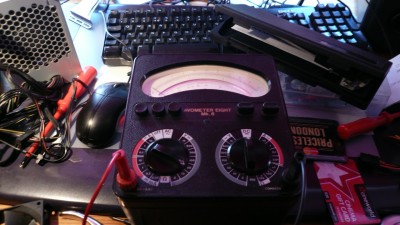

Wow thanks, good call - the voltages are low!
Bed connector(under load, warming up)= 10volts at board 8volts at the bed
Hotend connector(under load, warming up) = 10 at board 9.8 at nozzle
fans(1 x peek fan running) = 10.5 at board, 10.5 at fan
Should I check the stepper motors too to see if they are underpowered???
So I guess I need to figure out how to get 12v out of the above connectors.
I'm off to read up about Ramps 1.4 voltage...
Thanks again. This is not easy!

Well I double checked, and when only running the hotend, everything else off, the board is only giving 10volts to the hot end.
So aside from the bed problems I think not enough power is getting to any of my components...
So perhaps something is underpowered here - or wrong?
So next, I checked the power going into the Ramps board and it's 12volts going into both power input connectors.
I see online that one should be 24volts to the upper input block! - could this be the problem.
Any Ramps psu experience?

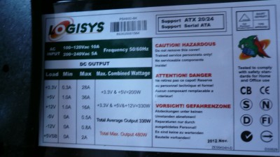

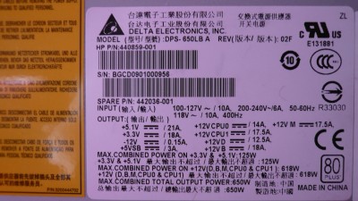

Re: Onyx temperature loss - lack of power?
You probably have a 450 Watt PC Power supply Type ATX in there now.
I would find the same thing but in a higher wattage like a 500watt or a little more.
There are other supplies that you will see that are 12Volts at 30 amps but I do not know a users skill level so I don't
recommend them because you have to make the cable that plugs into the wall and there is a danger of electrocution. So stick with
the PC ATX type as recommended above. Once you get the supply use the assembly manual to install it. It should look the same
as the one you are replacing. Here is a link to one just to give you an idea on pricing but you are in the UK I believe so your prices
may be different. Good Luck

Re Power:
if: 450watts gives 10 volts
500 watts would be 1.11 times more powerful, so would that give 10 x 1.1 = 11.1 volts?
So maybe 600 watts would be better?
600 watts = 1.33 times more powerful, so should give 12 volts plus change?
I am fine with electrical isolation, safety and modding, but I will choose the easiest route.
Ideally I'd like to know what PSU Is recommended by the manufacturere of the Rostock Max.
I have emailed seemeCNC.

Bad news... It may be a massively underpowered PSU?
330W Average
480W Max

I emailed John at SeemeCNC and it turns out I have one of a "defective batch" of PSUs that shipped with the kits.
Makes me feel a bit better about my build skills.
He has kindly offered to replace it, but I'll most likely get one locally.
So anyone reading l if your supplied PSU matches the photo above it may well be one of the "defective batch"
and may need replacing.

Absolutely no difference in power output detectable with a dummy load on the 5volt rail.
See photo below for the spec of my "good" - I hope - PSU..

WHOA!!! UPDATE!!!!!
Tried a different Multimeter - I was using a cheap digital meter.
I rechecked using an Avometer Eight MK.6
(big, analog, reliable, original RRP approx $800, as used by the British Army)
12v on the input terminals of the Ramps, both idle and under full load.
About 11.5volts on the Bed with and without hotend & fans on
About 11.7volts on the fan with and without the bed and hotend on
About 11.5volts ont the hotend with and without the bed and fans on.
So I think I can say I now have a working power system...
I guess 11.5 is good enough.
Bad components + bad tools = wild goose chase
Really sorry If I wasted anyone's brain power by having a bad meter..

Good job in diagnosing all of this. It's amazing that a meter would be that far off, It's also amazing that someone would produce such a meter.
You taught me something though, that even the meter can sometimes not be trusted. Happy Printing!
