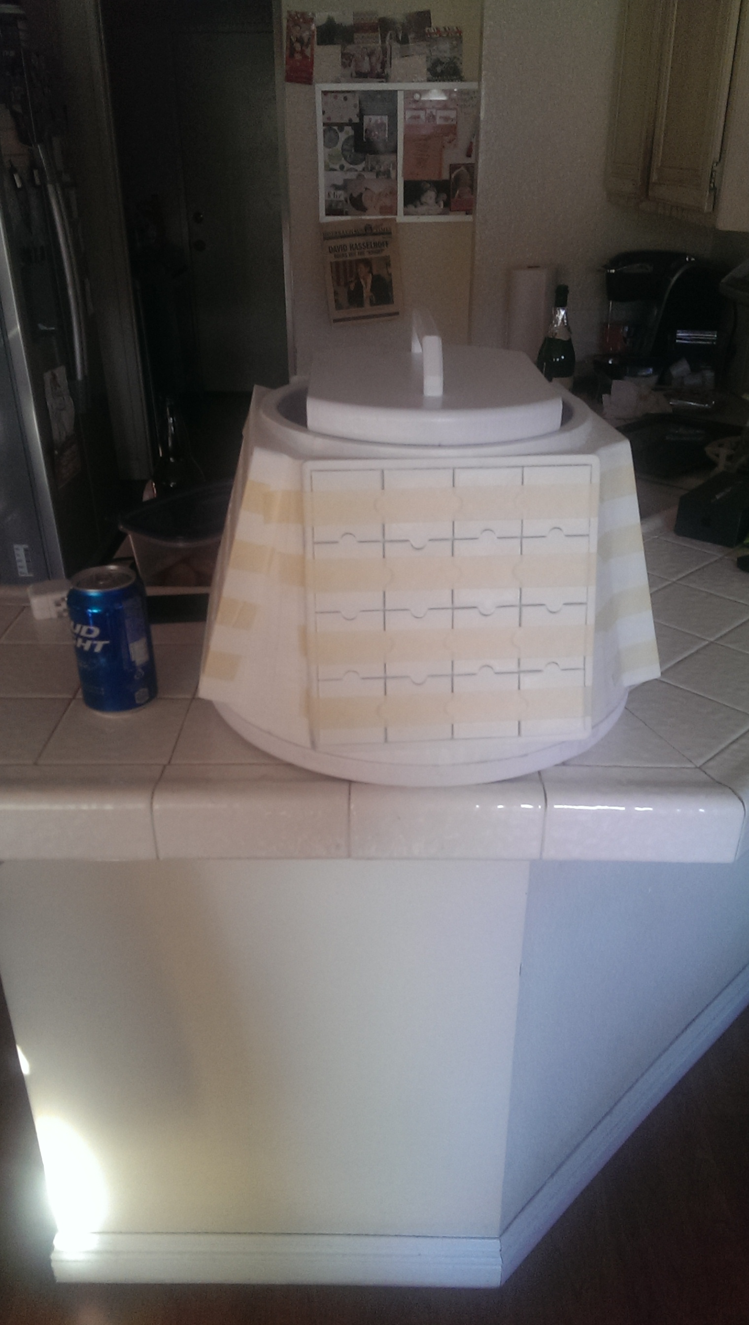

I printed this guy in November for a customer... and I didn't have good cooling fans.
Massive print. Over 6lbs of material. 3 different spools. 75 separate pieces.
Not even the slightest hiccup with PLA.

the iphone and beer can are for size reference :D

cope413 wrote: I printed this guy in November for a customer... and I didn't have good cooling fans.
Impressive as the print is, I really want to know what the mystery item is. Unless your customer swore you to secrecy?

Yeah, hah. I was really curious too. It's some sort of board game prototype. Not really sure, but I think it's aimed at kids and has something to do with shape recognition and such. The whole thing spun on a lazy Susan type thing that you can't really see in the picture.
You printed that on the couch? Nice!
