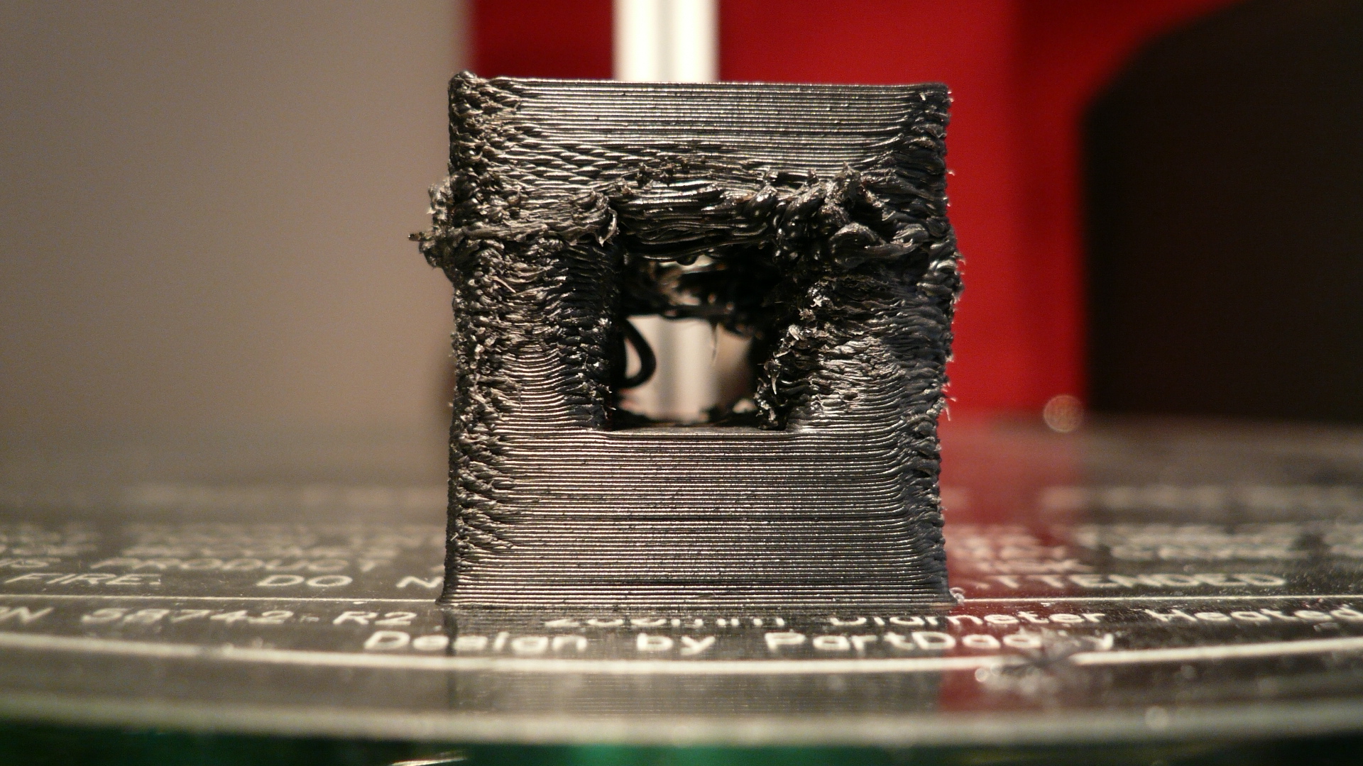

After finding out that I had a defective PSU with the kit I have replaced it with a high quality, high power PSU.
I have also beefed up the cabling and my bed / hotend are heating up quickly and reliably.
The print problems I have been experiencing persist - possibly worse - but they have moved sides..
The blobbing / nibbing is more on the opposite right side now.
I am no longer using a print cooling fan except on the PEEK as recommended for ABS. (This was my way of controlling the blobbing)
To me the problem still looks like the head mashing over a noodly, squishy unset layer, causing errors as it
squishes its way over the boggy previous layer.
Now some of the more serious power defects have been looked at in detail I am thinking about the motors and belts.
Occasionally I get an incosistent sound when the machine is doing a G28 home manuever.
The sound / skip may be present at aother times, but it is most apparent on thelong continuous travel of homing.
It's probably only one time in 30.
You can view, and more importantly hear, the problem on this movie:
[youtube]http://www.youtube.com/watch?v=IjgRf8SZw-s[/youtube]
photos showing the current problems:
Owl from last week = LEFT / Latest owl = RIGHT

When you need help troubleshooting, it really helps if you post your print settings...
If you don't post your settings (namely, Material, temp, speed, etc), then we have to add extra posts to your thread to ask you for them. Kinda like this post right here.

Re: Maybe Belt/Motor Skipping?
You know that the configuration values for the print job are shown in the g-code window of rep-host, right?
Put the extrusion multiplier back to 1 and drop the extrusion temp by 15 degrees.
Try a cube and see how it goes.

thanks, that's a much easier way to share settings! - see below..
Not having much luck with the output though.
I still suspect that something is wrong with the machine.
I may go back to the exact pdf manual settings and explore slow variations from there.
I guess I should probably remeasure all the temperatures,
recalibrate the extruder and redo the pid tuning - post PSU revamp????

One problem could be your extrusion widths. I would set them all to .55mm (10% more than nozzle size). I think anything over that is causing over extrusion. The perimeter you have set at .50mm should work? Have you tried printing a single wall cube?

Thanks - I was using .55 on th owl etc - I just took a step back with this last cube.
I will try a return to .55 extrusion for my next cube.
I have tried many many many single wall cubes!
They mainly show the corner abberations that you see on sharp corners here.
Sometimes sagging at higher temps - as you might expect.
They do not suffer from the blobbibg nibbing - as the simplicity of the geometry seems to prevent it.

Try backing it off another 5 degrees and see what you get. It LOOKS like over-temp filament.

I agree with Gene, looks like over temp, and perhaps over extrusion.
Have you measured your filament? Is it really 1.70mm?
Also, have you tried Cura? Because it's got less options, it's often easier for isolating issues.

ANOTHER TEST CUBE BASED ON COMMENTS:

No real difference with the lower temperature and .55 extrusion width.
Print looks pretty much the same.
I do measure my filament in multiple places / 90 rotational degree offsets and average the results.
The fact I can't get a decent print may make it look like I'm just a bit dim, or not very practical.
But even if this is the case, after 10 months, I reckon *If the machine works*
the dilligence and iterative repetition I have put in would get me better prints.
I suspect that endlessly varying the settings, or switching to Cura, are hidings to nothing.
You can't fix hardware with software.
You can improve hardware performance with software.
I think I need a better mechanical baseline before I can benefit from software-based enhancement
I will keep playing with the settings though..
That's been my SeemeCNC Rostock Max experience for 10 months.
I'm going to recalibrate the temperatures and start focusing on the belts bearings and motors.
In Review: Here are the machine's current strengths and weaknesses:
PSU - replaced, new PSU tested OK, delivering plenty of power.
Ramps: OK as far as I can tell.. Maybe Pololu trim pots need adjusting to stop skipping?
Cabling - replaced with fat copper - tested and seems low resistance.
Bed - OK, nice and hot, temperature accurate. **
Motors - skipping maybe?
Pulley Gears - old obsolete type - seem ok - maybe skipping?
Timing belts - OK? Tension OK?? skipping?? Maybe test more?
Delta Arms/Bearings - Seem Ok - no play, using lithium grease
Extruder - replaced with EZstruder, calibrated, delivers accurate feed.**
Hotend - added approved peek fan and aproved shroud - temp accurate **
Bed levelling - radius set - flat all over - adhesion is now good.
** May need recalibration based on PSU extra power??
The corners of the last picture remind me of when I go too fast or too thin and the filament is stretching alot. I doesn't look like that's the issue when I look at your settings though.
Have you tried drying your filament out yet? That improved some crappy ABS I've had before. Well, it went from really shitty to kinda crappy, but still an improvement.

I don't think it's the material... I've had bad filament, but the thing with bad filament is that it's typically inconsistent. This is doing the same thing consistently. Also, if it's PLA, it likely wouldn't stick to the bed at 85C.
How long does that cube take you to print? It really looks like the hot end is just sitting on each of the pillars and melting the crap out of the filament, leaving you with that mess.
