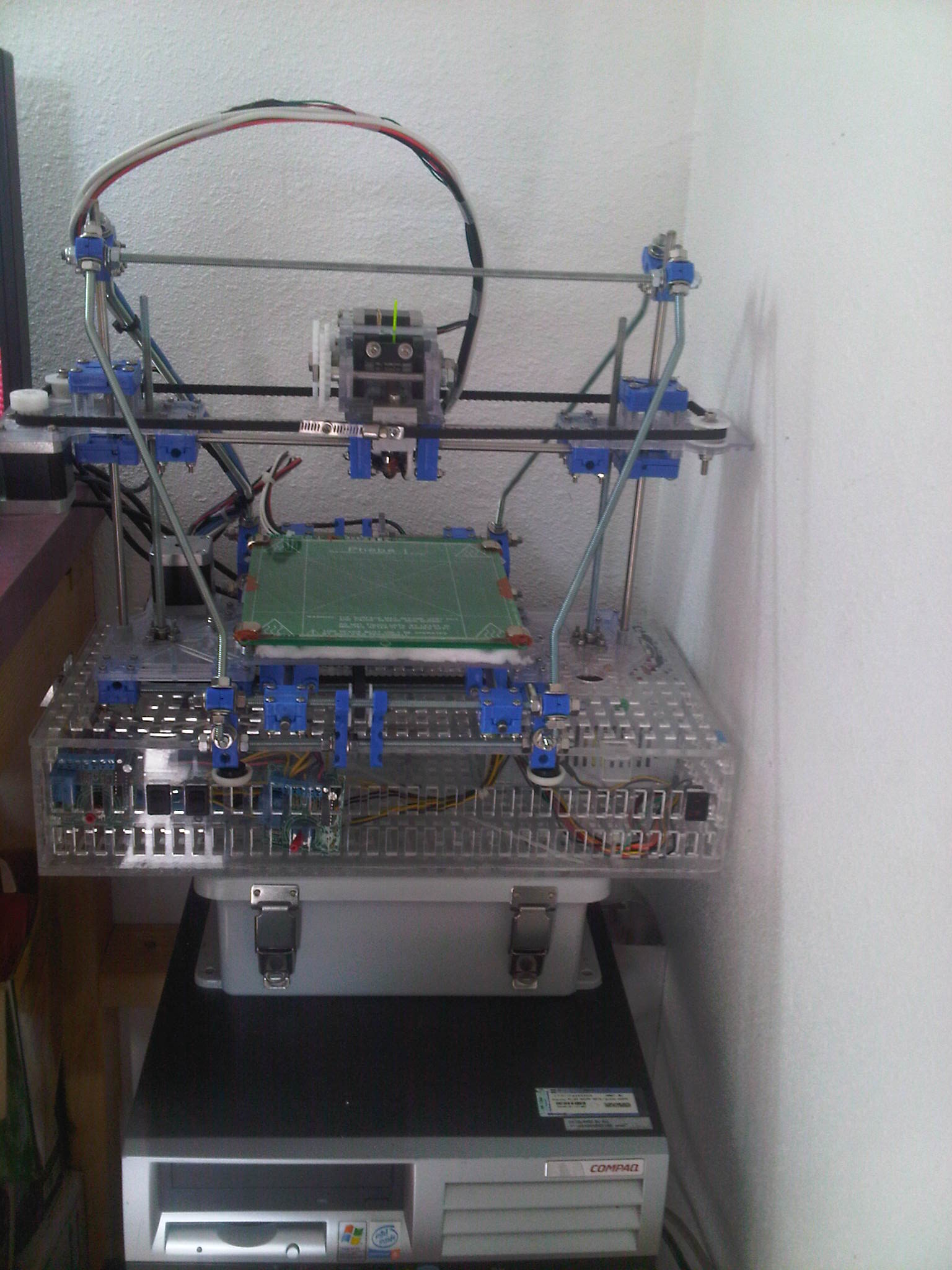

here are some pictures of what my 9yr old son and I built. std H1 printer, custom box for electronics.
Ryan suggested a stabilizer bar across the to of Z to keep machine from side to side jumping when making fast X travel, also had cool idea for mounting velleman controllers on front of case. I will be adding fan speed controller for two fans once I figure out how and where to mount them.
I built a custom acrylic case with plenty of laser cut venting Overkill but it is what I had left over from another custom project.

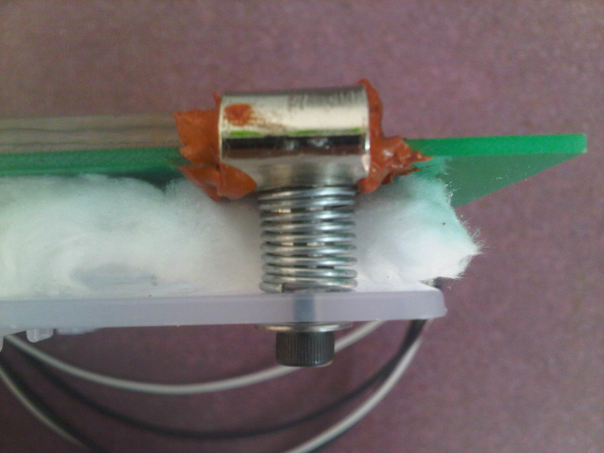

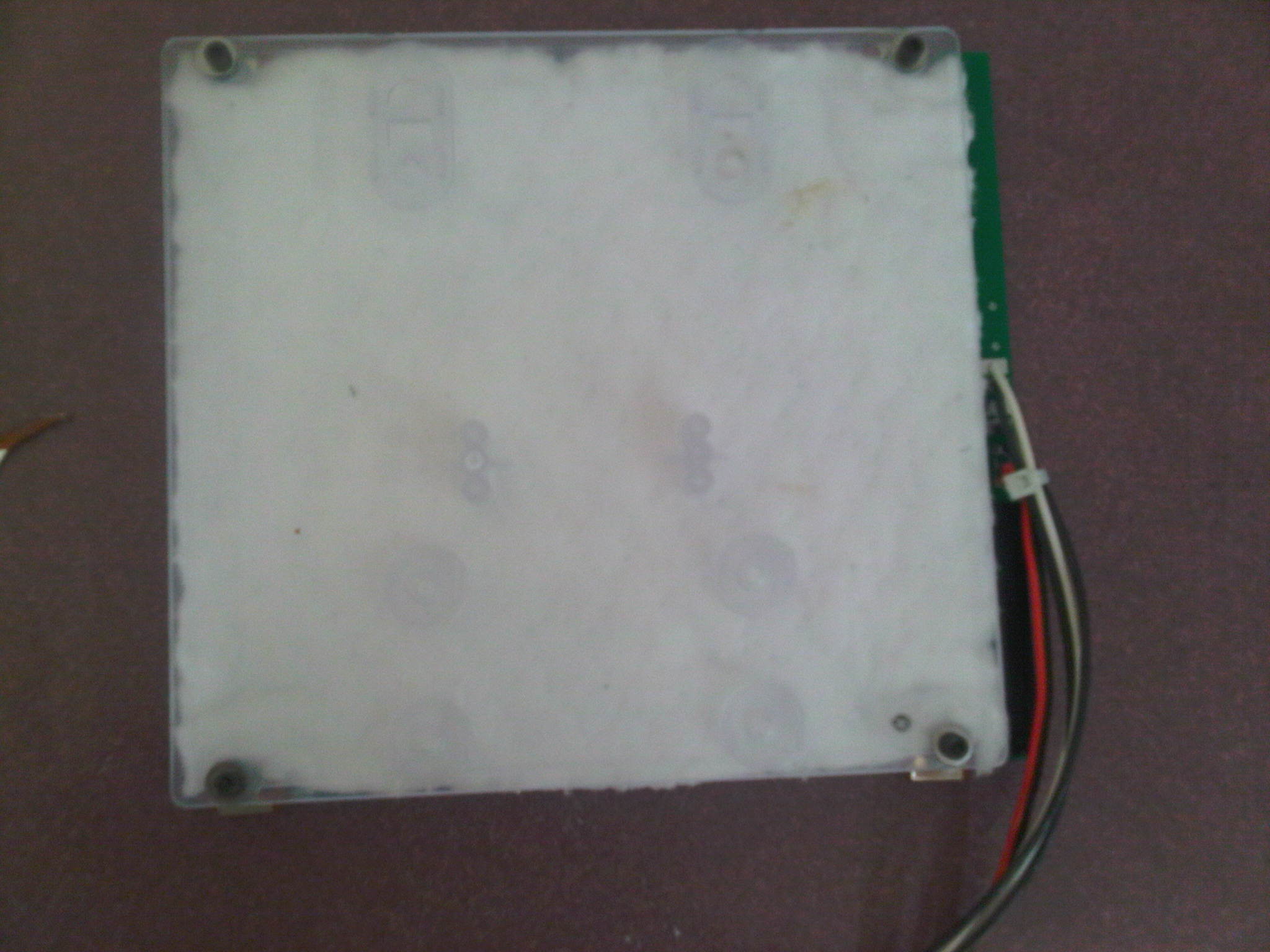

We added last week a heat bed and boy was that fun to build up. I took glass shelving clips and tapped then, then bent then to form around the glass and heat bed then attached to the original Seeme bed with alan socket heads to make fully adjustable table for the best prints i could obtain.

custom acrylic case
custom acrylic case

insulated
insulated
adjustable clip
adjustable clip
