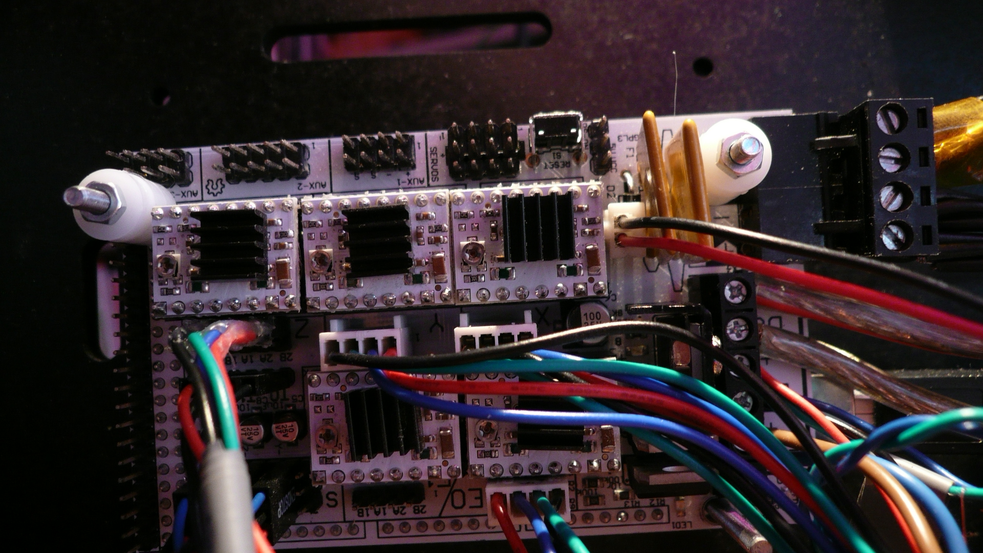

This is my Ramps.
THe only wierd thing is that the extruder motor has to be wired in the reverse to the arm motors to work correctly.
My trimpots are all look the same - I have not touched them.
Generally all looks ok...

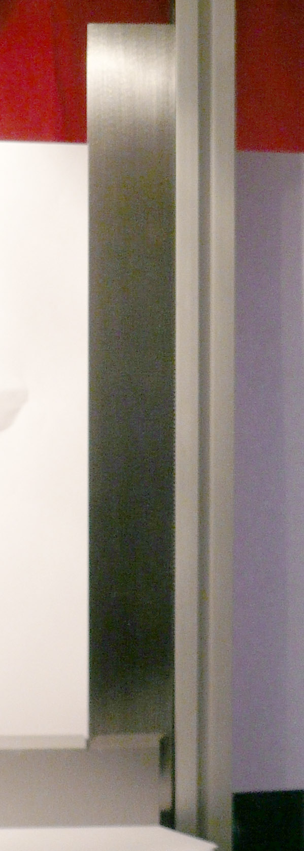

Testing for pillar alignment.
I put a high quality engineer's square onto the glass bed to test squareness.
Each pillar displayed about .5mm to 1mm gap either at the top or bottom of the square.
This could just be the bed being off - which will be compensated for in calibration.
I think this is a tough call to make?
Are the pillars slightly out?
Is the bed slightly angled?
I would have to take the bed off to do more testing.
Maybe I'll save that for another rebuild attempt...
On to extruder calibration..
Look at the bottom of this photo for the small gap...
Ho Hum...
RAMPS 1.4
EZStrruder

Re: Maybe Belt/Motor Skipping?
Ok, so you've eliminated as problems:
The Power Supply
The Hot end (good temps)
The motors (they all work, no skips)
I'm also pretty sure you've made sure the cheapskates move properly and there's no binding or looseness in the delta arm connections (u-joints, etc).
The only things I can think of that it could be are these:
1. The RAMPS
2. The Polulu stepper drivers
3. The firmware.
The biggest issue we've got with being able to help you is the electronics you're using. There's only a tiny handful of people here that have any experience with the RAMPS board and the Polulu drivers.
Have you done any kind of adjustment to the Polulu drivers? It's my understanding that since they don't have electronically adjustable pots (the RAMBo has "digipots"), they have to be adjusted by hand. It could be possible that the drive current is incorrect, but I don't know how to check or adjust that.
You list Marlin 1.0.0 as your firmware - would you be willing to give Repetier .91 a shot?
The Power Supply
1. The RAMPS
3. The firmware.
Gene, you are 100% correct about the Ramps board. Functionality is exactly the same as the Rambo except it does not have locking connectors and the potentiometers have to be adjusted manually.geneb wrote:Ok, so you've eliminated as problems:
The Power Supply
1. The RAMPS
3. The firmware.
With Ramps, to get the driver current set accurately you need to measure a reference voltage on the driver while turning the potentiometer. There are charts on the web that show the measured voltage to current output.
Most users "guesstimate" the current based on potentiometer position because of the difficulty in measuring the reference voltage, turning the potentiometer, and not short anything out. You need deft hands and three of them to do it right
so I usually recommend using the position of the potentiometer as a guide so that the user doesn't burn up the driver by shorting those tiny and tightly packed traces. Nothing that I have seen from the pictures would indicate that he has a stepper current
problem so my advise is not to adjust those potentiometers at this time. They are delicate little buggers and are easily broken and unless there is a specific reason they are best left alone.
Pretty much lost my temper there.
A long dark teatime of the soul led me to thoughts of stripping the reusable iron form the machine,
taking the mdf components out to the garden and lighting a big bonfire.
Anyway....
Looks like the ramps overheated by being shut inside the body of the rostock max.
Yes it has the approved fan running on it costantly.
Looks like it needs more airflow than the Rostock max casing allows.
All working again now I have the door with the electronics open.

Might try and contact the guy who sold it to me re the Ramps issue
But he's given up selling Rostock Max. Genuine quote from vendor:
"We actually stopped selling them as while they are nice machines - they seem too fussy to get working well and I was not getting the support from Seemecnc at the time."
It's hard to stay positive when that's what the dealer tells you...
I wouldn't normally spill those beans, but I'm getting tired of this and I honestly think that UK rostock maxes were pitifully undersupported and it was a stupid idea to put different electronics in them.
There were a couple of guys on this board who bought the UK issue. They never completed their build logs. Not even first print cube photos..
They're probably more sensible than me and got on with their lives...
I have IM'd - no reply...
I might have to face the facts that I am using a frankenstein machine and all the advice you guys give, while awesome and generous.. may be for a different ecosystem.
But.. on the other hand, maybe the only difference id the pololus... I just need a pololu trimpot expert maybe...
Any other differences other than the stepper drivers??
Time to upgrade the firmware next I guess..

Hey Banana!
I hope you didn't atomize your RMax already. :-) If you did not, here are some thoughts in the early hours. Maybe they are helpful.
Besides my RMax I have some (cartesian-style) printers running. All of them with homebrew Arduino-Shields and with RAMPS-alike A4988 (pololu) based stepper drivers. Firmware is repetier V0.8x. I know that adjusting the trimpots is a little bit tricky and I received not even two of them with nearly idendical trimpot settings.
My suggestion is: before you tweak the trimpot settings (maybe from "bad" to "Poof!"), try printing a round calibration cylinder (like this one here: http://www.thingiverse.com/thing:215101). Speed set to 15mm/s, and with no further modifications of your other settings. The idea behind, is to print an object that causes no hard positive or negative accelerations.
My humble experince is, that if you are skipping steps, then every subsequent layer will be shifted in one or two dimensions too. But this seemed not to be the case with your cube. You got round corners (and it looks like the corners in the front of your picture are more "round" than the ones facing to your Z-Tower). I had the same effect when one of my timing belts had too much play and the effector behaved like guided by a rubber band.
Skipping steps but "remembering" them is often caused when the A4988 driver is triggering its built-in thermal protection. But in those cases the printed results are looking more "ripped" and not as smooth like your cube.
I got those round corners with a) too low extrusion temp (no good layer adhesion); b) first layer printed out too high (bad adhesion on heated bed); c) underextrusion - and d) loose timing belt(s).
The key for fixing your problems is to modify only one parameter at a time. Then printing the same two calibrations objects and observe waht has changed. Everything else will make things even worse.
Don't give up. The RMax is a great machine and it can also produce great results.
(strange punctuation and grammar is intentional :-) )
Good night,
Jens
Good night,
Jens

All things being equal, there's got to be a solution to your problems. Printing a cylinder is an excellent suggestion - it should remove the jerk settings from the motion equation. We WILL get this figured out.
- analog_banana
- Posts: 167
- Joined: Mon Apr 08, 2013 7:53 am
- Location: London, England
Thanks for the support!
Here's a cylinder test.
I don't think it's a too low temp issue - maybe It was too high, based on the experiments here:
http://forum.seemecnc.com/viewtopic.php?f=37&t=4192
This cylinder seems to be fairly straight - a liitle bit of warping just near the base due to ambient temperature / bed temperature maybe?
You can see some artefacts where the head moves from the outer wall to the inner wall of the two shells.
