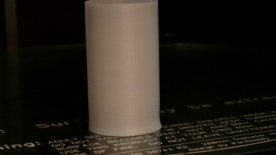

Now that's a LOT better. That narrows the issue down quite a bit.
Try this - make a solid cylinder and slice it with:
.25 layer height
1 perimeter
Check "Spiral Vase"
0 top layers, 3 bottom layers
This should print a single wall, spiral tube. See what the quality is that way. You will see some odd warping on occasion with ABS - it's just the nature of the material unfortunately.
I'm pretty sure your issue has to do with how the firmware is handling "cornering" when printing. Unfortunately, I know nothing about tuning the Jerk settings in any firmware.
There's gotta be someone here that can help in that specific area - you may need to change to Repetier-Firmware however.

As you expected - the spiral vase is perfect.
I agree the problem looks to be with how it handles cornering
I think it's soon time to update the firmware - just in case, but I do want to bear the following in mind:
If NOBODY has really had to use specific jerk settings:
that would suggest that a functional Rosotck Max does not usually require tweaked jerk settings.
THEREFORE, there is something different or malfunctioning about my machine - Other than the idiot driving it :)

Posts: 5358
Re: Maybe Belt/Motor Skipping?
That spiral vase tells me these things:
1. Your stepper motors are good.
2. Your belts are good.
3. Your electronics are good.
4. Your extrusion temperature and feed rate are good.
Now the only thing that can really be a factor that we don't know of yet is the firmware. It could be possible that the settings that your Marlin installation are using may be totally off for a delta printer.
If you install Repetier-Firmware .91 and that printer is suddenly all unicorns and rainbows, I want you to call the guy you bought it from and yell at him for mangling the firmware and then blaming the hardware. :D :D :D :D

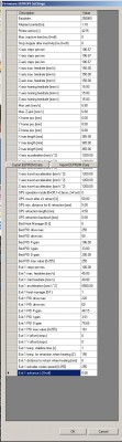

I have upgraded the firmware to repetier.
I found a pre packaged version here:
http://www.thingiverse.com/thing:127633
I have changedt the pulley tooth count to 15
I have left PULLEY_DIAMETER untouched at 10 - IS that OK for an old 15 tooth pulley?
and the steps per mm to 106.67 on each axis - just as with the previous firmware..
also:
STEPS_PER_ROTATION 200
MICRO_STEPS 8
So all good except when I do a g28, all the carriages home at once - not the usual one at a time.
Any ideas on how ot fix?
Ho Hum...

analog_banana
Posts: 167
Joined: Mon Apr 08, 2013 7:53 am
Location: London, England
Post by analog_banana »
Looks like all the speeds are way too fast with repetier.
So something is different.
I'm wondering if it's max feedrate or something?
But the extruder feela bout 10 times faster than it used to,
so I need some kind of global feedrate or stepper speed adjustment.
I think I'm back out of my depth here.
I am of course googling hard, but there seem to be so few if any write-ups of the machine I bought.
(ramps based)
Taking a break for a bit..

What have you got set for steps per mm on the main drives and your extruder?
If you check the first edition of the build manual, it SHOULD (I think) have the figures needed for steps per mm for both the main drives and the Steve's Extruder (is that what you're using?).

analog_banana wrote:I have upgraded the firmware to repetier.
also:
MICRO_STEPS 8
MICRO_STEPS 8
Sure?

Eaglezsoar:
Don't worry, I'm really not disrespecting the choice of hardware at this point.
The tone of my post was more to apologize that I have to ask you guys so many questions.
This is currently the only "instruction manual" I have for this machine. and as such I really appreciate your time!
GeneB: I have sorted out the steps per mm- I had missed the extruder steps setting.
I now have the x y z steps per mm set to 106.67
and the Extr 1. steps per mm to 100.00
This should be the same as it was before the firmware change.
It is now behaving normally - maybe still seems a little bit speedy?
Still to be fixed:
The g28 command makes all carriages home simultaneously - not one by one as before-
not sure if that is an innacurate way to do a g28?
Hotend Temp: I can't seem to get it above 207 degrees.
I have set Extr. 1 PID drive max to 220 degrees, but currently it won't go higher than 206/207
JolietDelta:
re: MICRO_STEPS 8
That's what it's set to in the firmware I got, the guy who uploaded it says
That setting is in config.h
/** rief Micro stepping rate of X, Y and Y tower stepper drivers */
#define MICRO_STEPS 8
Just change to 16 if that's the way you want to run it.
So I guess I can have either - I vaguely know what microstepping means - I do not know how it affects Repetier's functionality though.
Ho Hum...
Underneath the driver boards on the ramps there should be a series of jumpers.
The jumpers set the microstepping that you are using according to this chart:
jumper Yes/No step size
1 2 3
no no no full step
yes no no half step
no yes no 1/4 step
yes yes no 1/8 step
yes yes yes 1/16 step

analog_banana
Posts: 167
Thanks! I'd never has guessed that one.
There were 3 jumpers underneath each driver board so I have set the firmware to #define MICRO_STEPS 16

analog_banana wrote:I'm searching the firmware and eeprom for how to set the delta radius now..
It's called "Horizontal radius" in the EEPROM settings.
analog_banana
Posts: 167
Yes - You would think that!
but I can't see anything like that in the eeprom settings list.
Nothing Horizontal, no radius..
See image:

analog_banana wrote:Yes - You would think that!
Me again :-)
Did you wipe your EEPROM when changing from marlin to repetier?
To be sure the INIT-Run of 0.91 created all values and pointer correctly do the following.
1. Set "#define EEPROM_MODE 0"
2. compile / upload and start the controller
3. Set "#define EEPROM_MODE 2"
4. compile / upload and start the controller
What ist RepHost saying now (EEPROM Settings)?
Oh - don't forget to export your EEPROM table vie RepHost before doing that procedure.
~Jens
analog_banana
Posts: 167
This is what hapenned:
Set "#define EEPROM_MODE 0" = eeprom settings are blank
Set "#define EEPROM_MODE 2" = eeprom settings are visible - settings restored to defaults.
I still can't see a Horozontal radius option...
