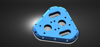

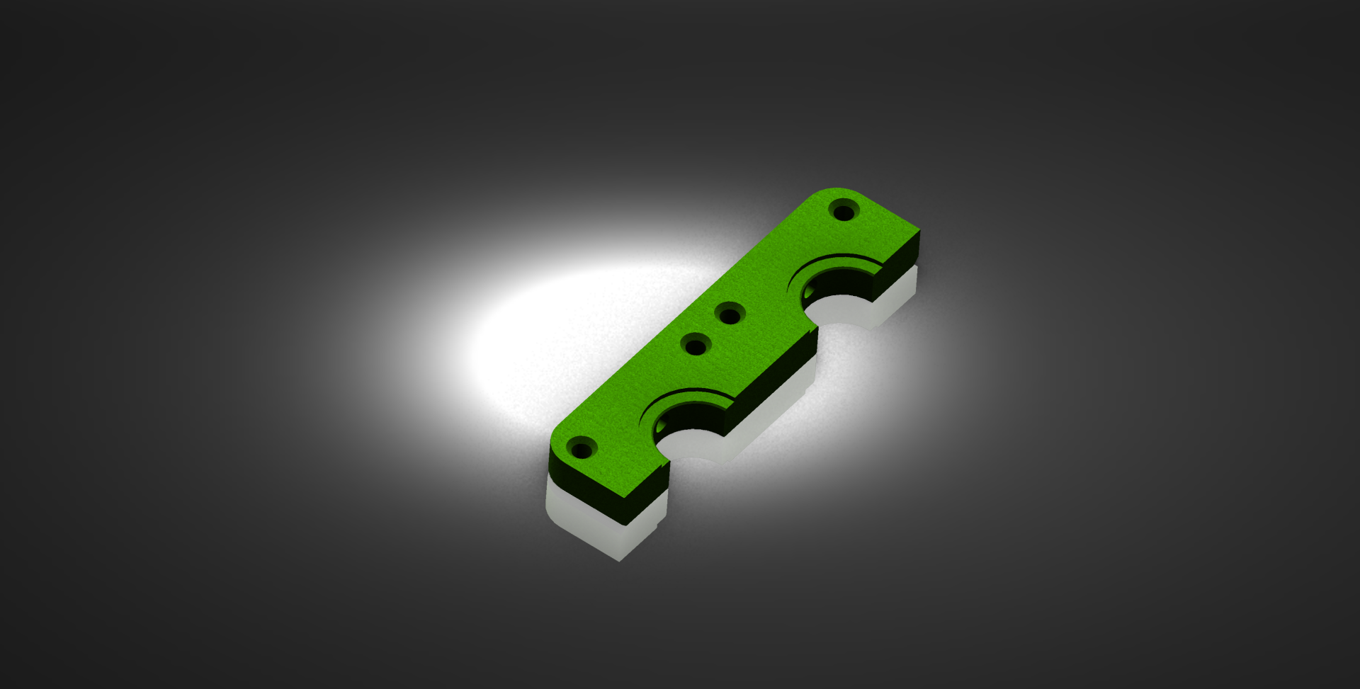

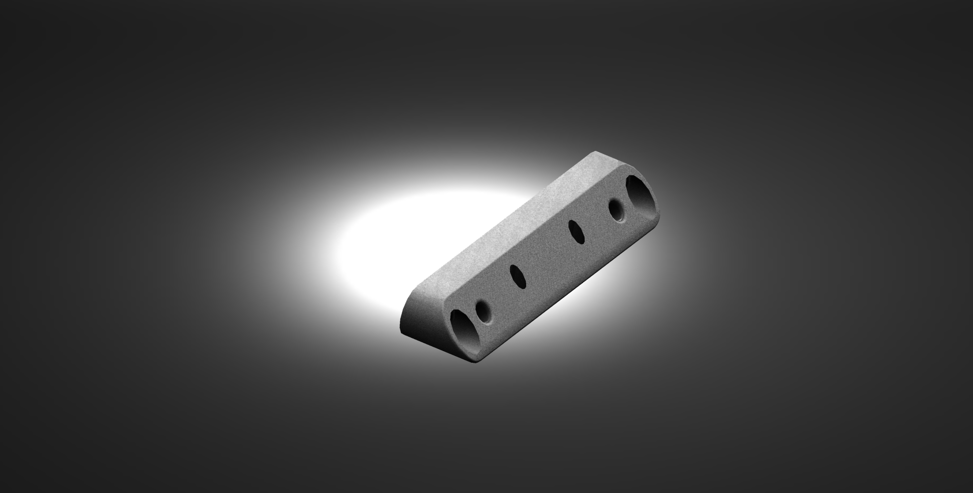

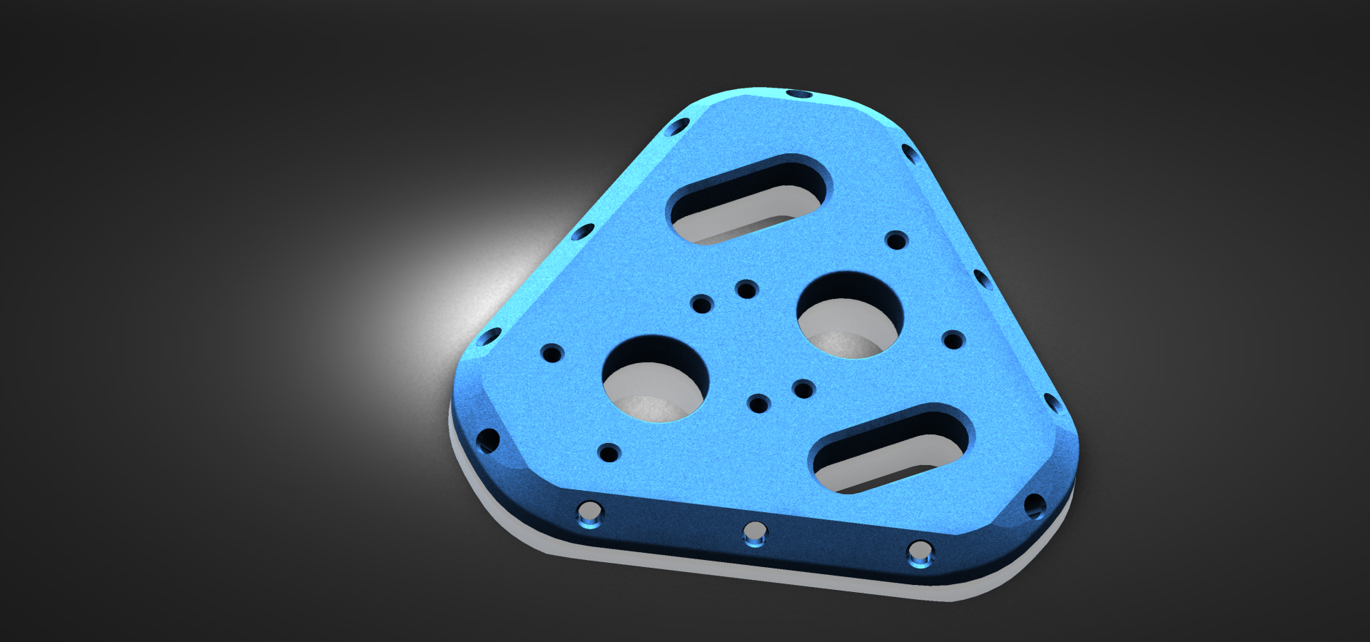

Nonono, I'm going to put all of my files here regardless of whether I end up making and selling 3d printer kits or not. I don't put any money into designing parts, so I don't expect to make money off of selling STL files or whatever. And to be more clear about the $170 kit I was talking about, the kit would include;
-Effector plate
-Triple extruder (3 nozzle hotend)
- 1 to 3 cold ends (filament pushers)
-Magnetic arms
-All of the necessary electronics
This kit would probably be geared towards people who are making their own delta printers or upgrading Rostocks. It took me so long to get my printer to where it is today as far as capabilities and print quality, and I see market potential for a product that takes the hassle out of hobby 3d printing. Nobody should have to spend as much time fixing and improving their printer as I did!
Right now the problem is that my ball end cups are meant to press fit onto a 7/16th rod, and the press fit will probably not work if your printer setup isn't nearly identical to mine. Plus most people are using 3/8th inch diameter rods.
I attached all of the printable parts in this post, except for the magnetic cup joints. I will work on getting several sizes of those for various press fits tomorrow.
If you print the attached files, make sure to do it relatively slowly at small layer heights. I think I'm using #8 (4mm) hex head cap screws to glue my chrome balls to. I'll try to get more installation instructions and pictures tomorrow.
							-Effector plate
-Magnetic arms
